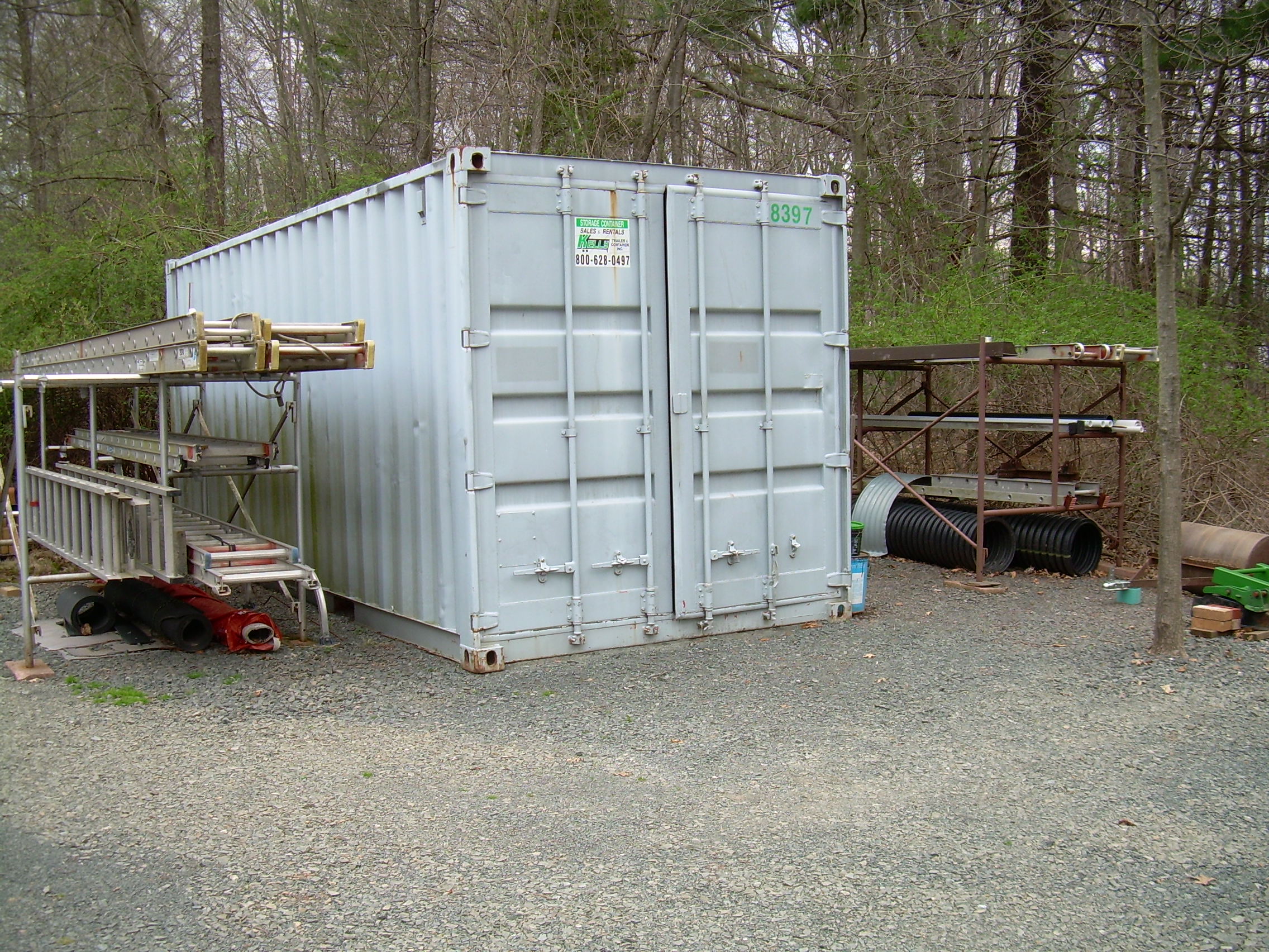

I've got a twenty footer, I just leveled and raised the ground with road base. Expect all kinds of critters to make the underside of that thing there home :) I've got a wood chuck living under mine that had a liter last year.
Around here the 40 footers are only a tiny bit more expensive than the 20's. seems more people want the 20 footers. For the 40 footer try and get the midway door, tend to pack stuff in the back of the longer ones and have trouble getting to it.

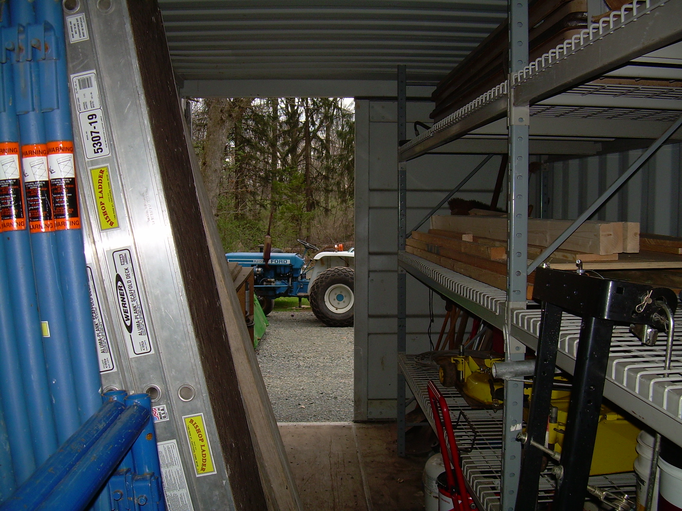

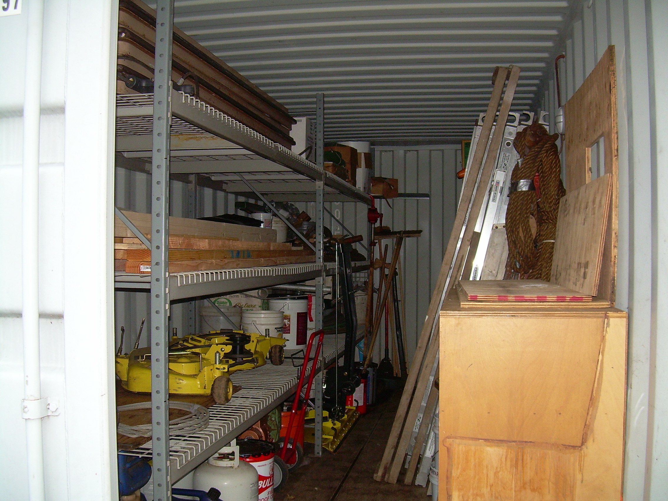

I ran 3 foot deep pallet racking down 1 side, floor to ceiling.
The closer to the ports you are the cheaper the price obviously, I paid $2400 for mine that looked almost new at the time.
Oh yeah, they do get hot!
JB.
