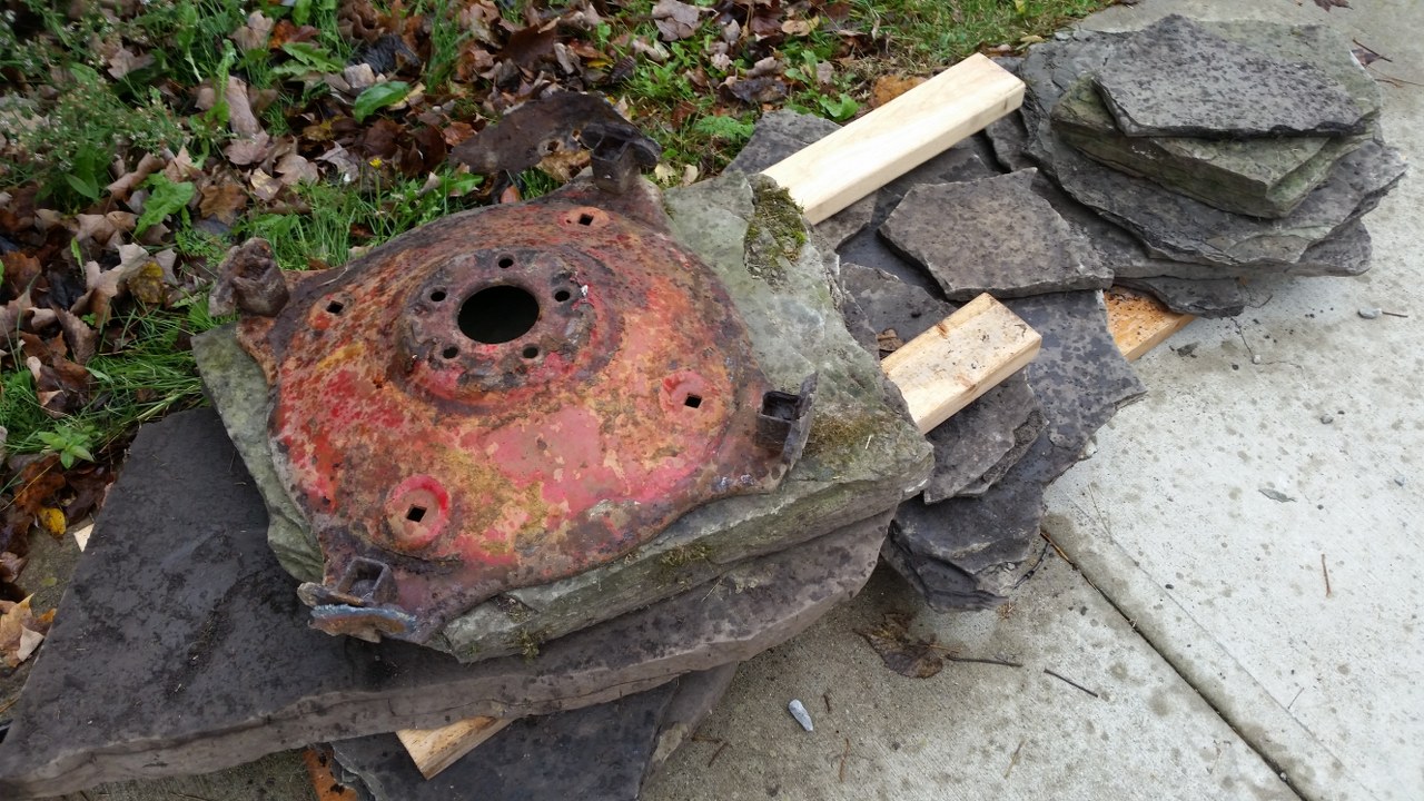

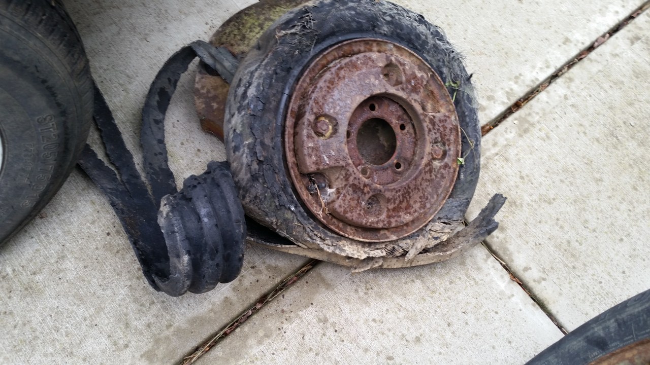

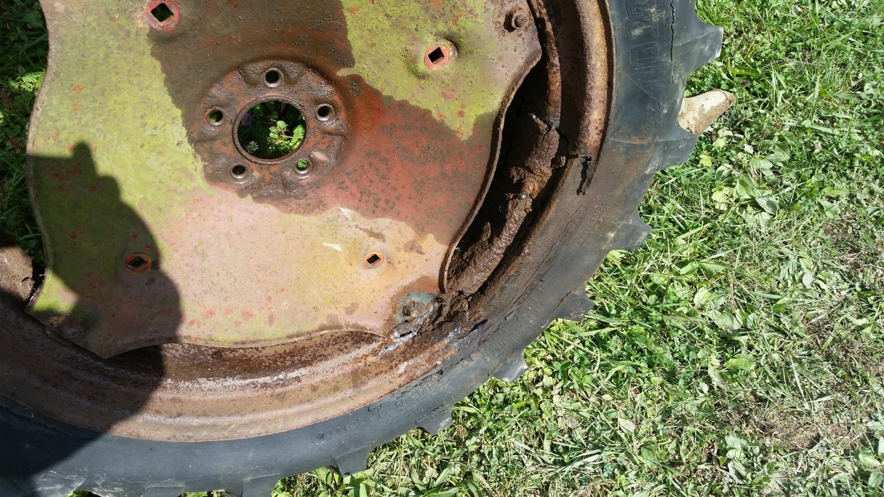

Well, I got 'er home! :thumbsup: And she's in pretty sad shape but I think she's still restorable. I had talked to the guy that had kept it all these years and he warned me that the front tires were in really bad shape. I figured the rears were going to be in bad shape as well, so I lucked into getting a set of all 4 tires mounted on wheels for $140 on CL. When I talked to him the day before my trip he said that he'd pulled the tractor out of the weeds and that one of the rear tires decided to separate from the wheel so I took my "new" tires with me to pick it up.
Of course, none of this happened without pics to back it up!.....
Here are the old tires and wheels...
20141008_121458_1280x720.jpg 20141008_121507_1280x720.jpg 20141008_121511_1280x720.jpg 20141010_131457_1280x720.jpg 20141010_131516_1280x720.jpg

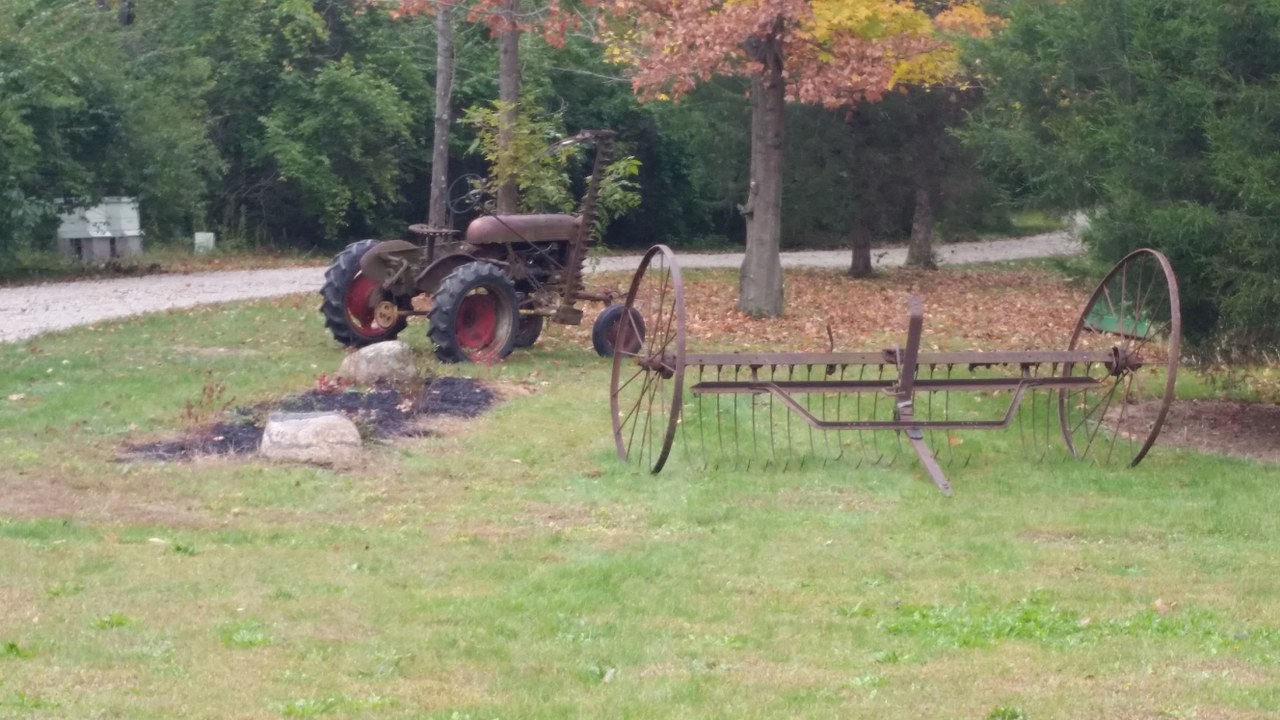

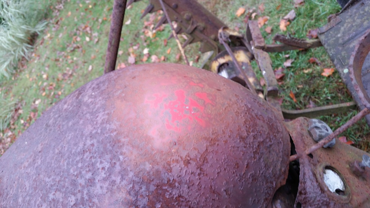

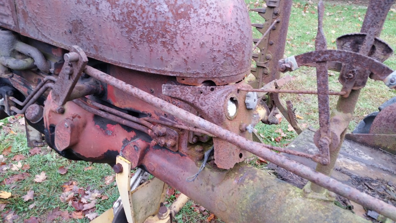

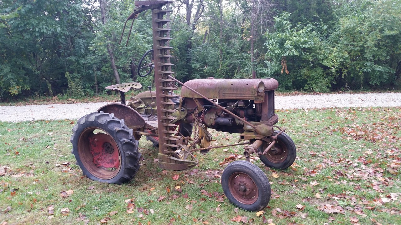

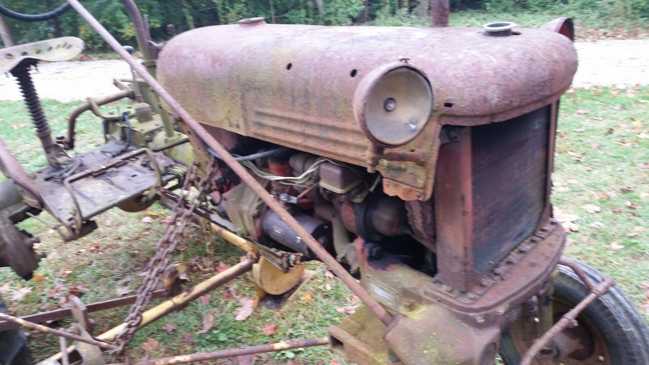

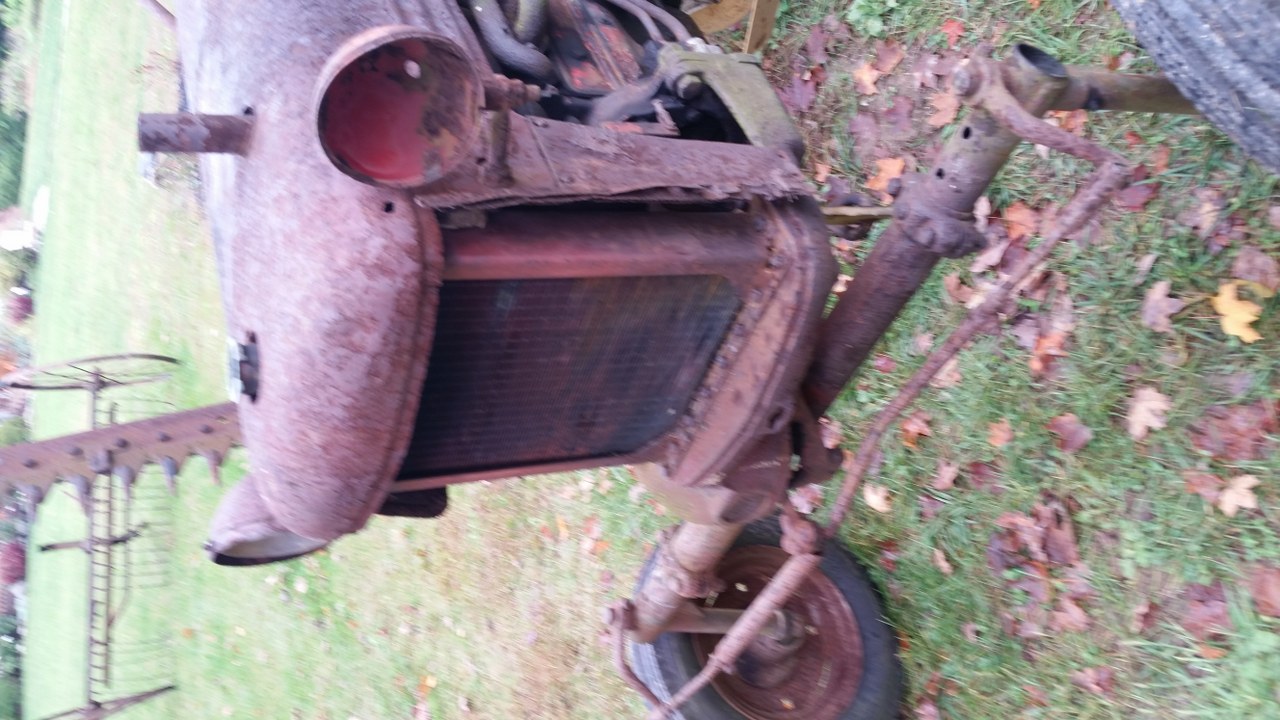

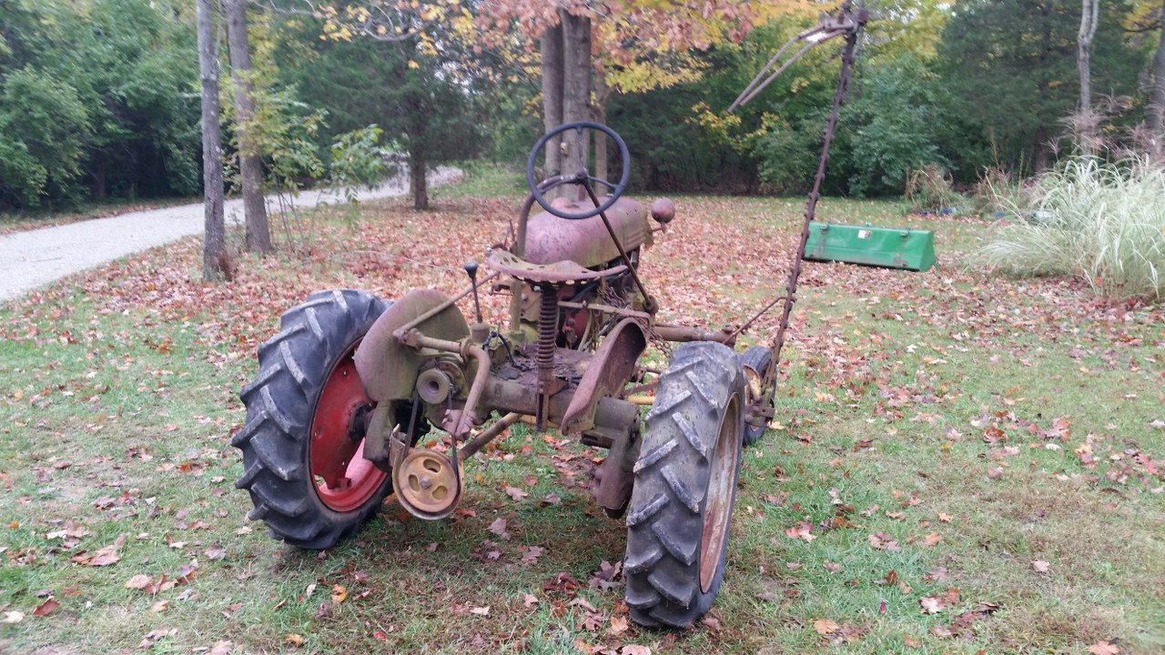

And pics of the tractor (and the old hay rake that I drug home)...
20141010_132438_1280x720.jpg 20141010_131721_1280x720.jpg 20141010_131707_1280x720.jpg 20141010_131645_1280x720.jpg 20141010_131636_1280x720.jpg 20141010_131610_1280x720.jpg 20141010_132245_1280x720.jpg

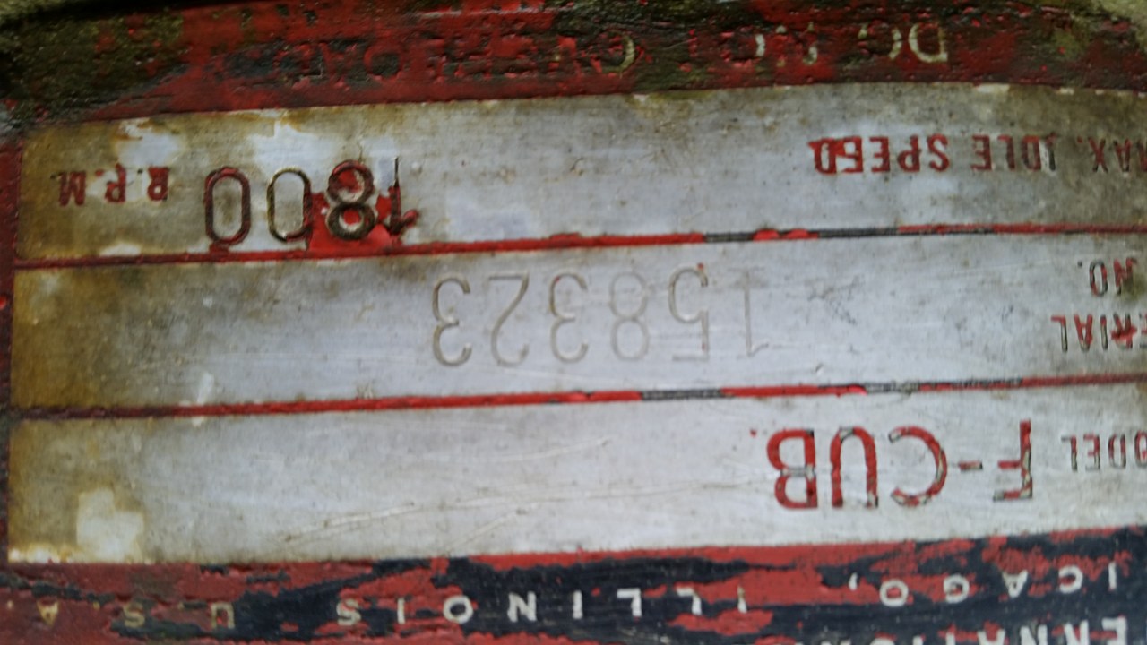

From the data plate, I believe that she's a 1952...
Obviously I have my work cut out for me. The engine is seized and there is sheet metal that needs replaced. The hood and fuel tank are actually pretty solid so I think I can use them. There is a bird nest in the gas tank! :laughing: No gas cap and no radiator cap. The tractor rolled pretty easily on and off the trailer and we also were able to steer it. It did stay put and in gear on the trip home. I have the carb in my toolbox so it should be OK. I thought there was a draw bar on it at one point, but it's not there now. The condition of brakes and clutch are unknown at this point.
I don't have a picture of this, but I rubbed on the hood a bit with some ScotchBrite and a sanding sponge. Believe it or not, red paint actually showed up once the rust was removed!! :thumbsup:
The first order of business is that I want to get it somewhere that it can stay out of the weather. Then I will start spraying some penetrating fluid on most of the connection points to let it start working it's magic. I will most likely be using a mixture of acetone and ATF for this purpose. I'm going to try and get the sickle bar off first just to get it out of the way.
I also brought home a single bottom plow and the front blade for the tractor. The plow is in really good shape. The front blade is in decent shape but the top of the blade is rusted through in spots.
As this progresses (very slowly!!) I will be posting up here as well as a couple of the Cub specific boards. I do appreciate some of the earlier posters pointing me in that direction.
/ Getting (back) a FarmAll Cub #9
darn that ones rough!

Lotsa luck. My 1948 Cub wasn't running with I bought it ($1100), but engine spun OK. Just had really poor compression in all 4 cylinders. So I'm rebuilding the engine completely. Reassembling the engine now and hope to get it running on the bench soon.
You might check the front of the engine block. There's a ear on the block that the lower water hose runs through from the block to the front axle bolster that carries the radiator. That ear was completely broken off the block. I couldn't see the break because the front cover on the cast iron engine block held the that ear in place even though it was busted clean through. Had to use special welding rod (Super Missile rod) to reweld it with my stick welder. That slowed me down about three weeks while I came up to speed on welding cast iron.

for that one i'd even have brazed it. non structural..e tc.

Looks like you've got your work cut out for you! Cool project. We had two of those with the same sickle mower back in the 60's. Used them for trimming along the edges of drainage ditches.
Two bolts that hold the right side of the bolster to the block attach to that ear. It's a major part of the front end structure on the block. That ear is notorious for cracking or breaking completely if the right wheel of your Cub hits a pothole at high speed or smashes into a tree, for example. IH design dept really blew it on that piece of critical structure.
I've seen braze repairs done on that particular part and that probably is good enough. But I haven't brazed since grad school and am a lot better with my Hobart stick welder.
/ Getting (back) a FarmAll Cub #14
i agree. use the method you are better at. :)

My research says it is a 1952 model year

I like it. And the hay rake. Worse case scenario you have some good lawn art or recycle. If you can get it to run ... it's your grandpa's tractor. Hard to beat that.

Duwop - as far as I know, you're right - 1952 according to the serial number. What year is yours?
