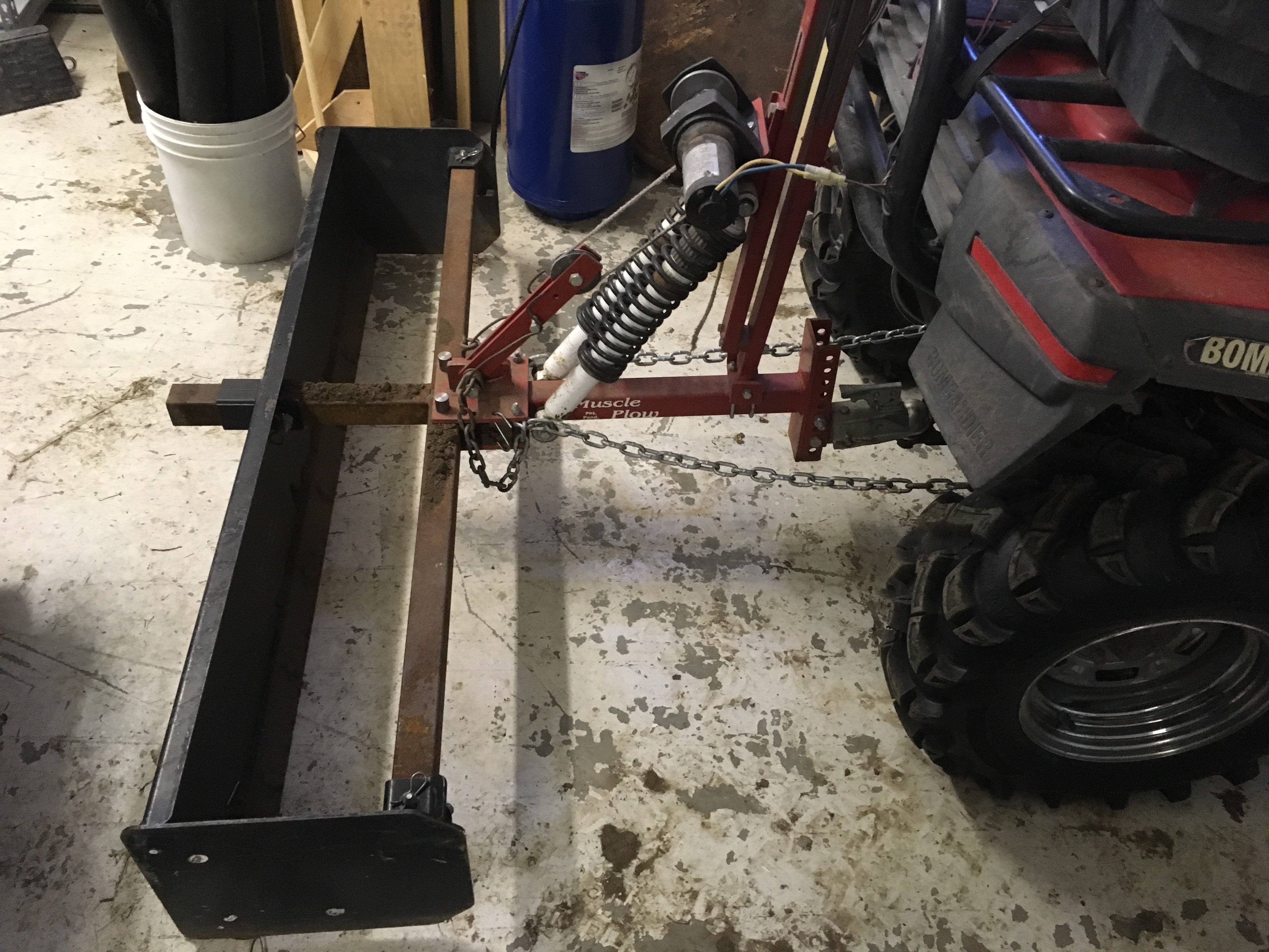

There was a shallow ditch that ran through my front yard that wasn't used so this spring I filled it in. My process was as follows,
Pick the rocks out, no pictures of that but I'm sure you get the idea.
Load top soil into ATV trailer with tractor. The tractor is too heavy to run on the lawn.
Dump top soil in a roll in the ditch. Then run the ATV over it to pack it down.
Hooked up the box scrapper to the ATV, used it to level and cut the dirt to grass level.
Dirt work all done, just spread seed, rake it in and water it.
It took a lot longer to get the rocks picked than to do all the rest. Sorry about the one sideways picture, it was right when I put it in but I don't know how to rotate it.
