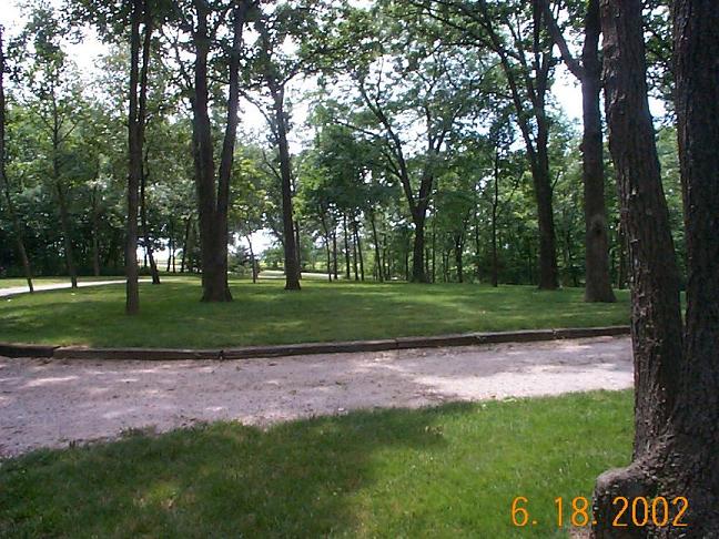

I'm leaning toward the 60 and all the advice has helped. As pointed out it is really a difference for me in the space between the trees. I have several areas that will require either taking a little more of the woods back to lawn to allow space to manuver around trees towards the edge of the existing lawn, or places that will require that I landsccape with mulch or rocks to close in the space between the trees. I have mulch around the bases of all the trees to facilitate easier trim mowing with the current 46" JD 318. WIth the 318 I have to use the individual turning brakes on some of the trees.
I will try to post a picture of the yard if I can figure it out. This photo is from just after we moved in and before I mulched the bases of the trees.
Thank you everyone for the help.

Beautiful property!
