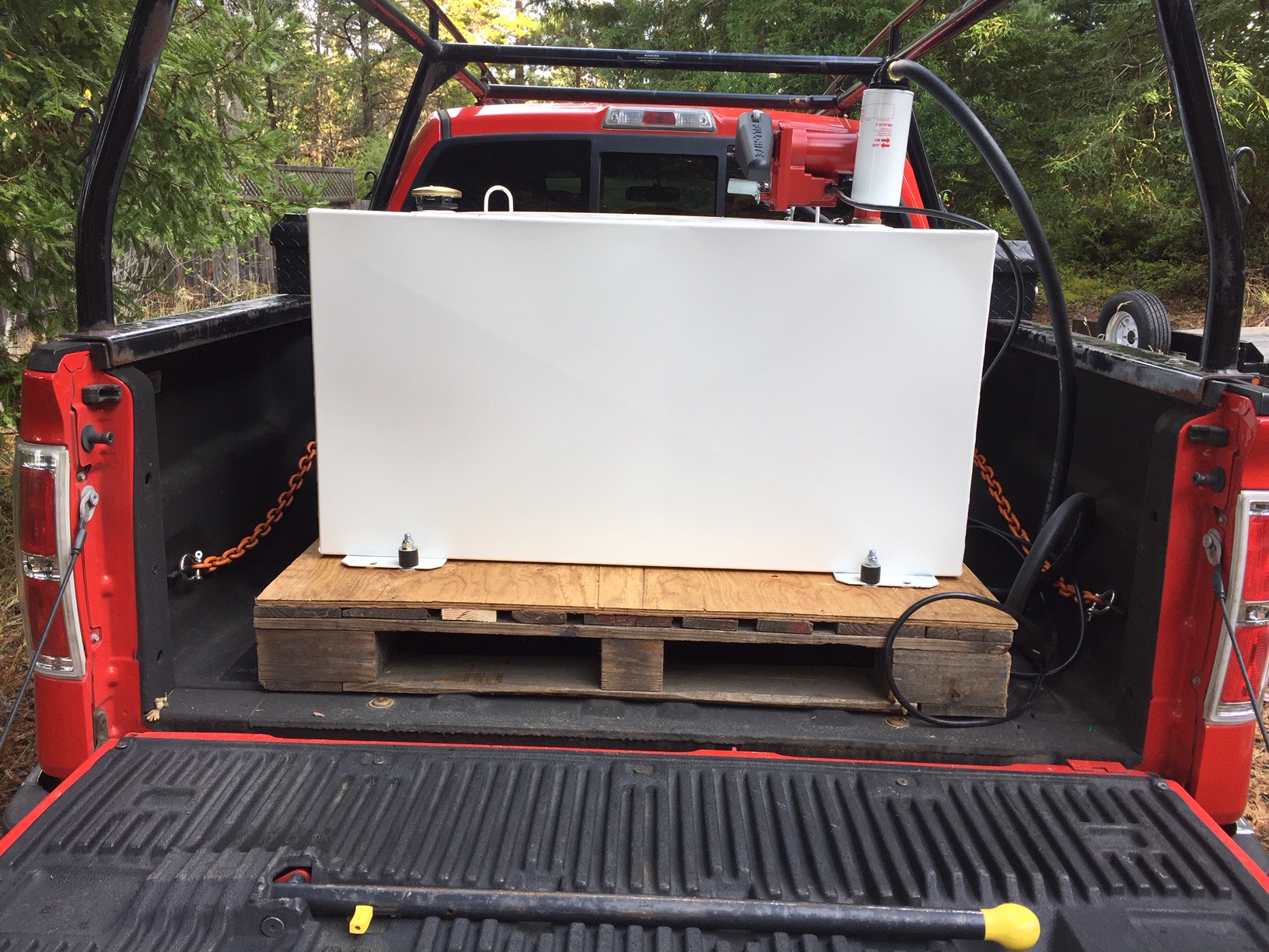

I've used the 5 gal can method for years with the tractor, but with a new diesel backup generator needed a better way. I bolted a transfer tank (with pump) to a pallet. Load the pallet in the pickup, fill at the station. Use the tractor to move the pallet out of the pickup and into the generator shed. Fuel the generator. As a side benefit I can now fuel the tractor with the same setup.
There are warnings that current formulations of diesel fuel are more likely to have static problems than in the past. I use a long wire with big clips to make a ground to the truck frame or generator or tractor.
