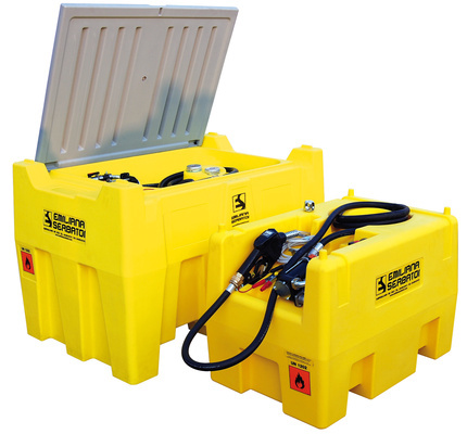

Stackable, Portable Fuel Tanks Combine Capacity for Both Diesel and DEF | No-Till Farmer
Sparex Carrytank Transport Tank - 22L - Diesel - 12V (DC) - 127911 | FarmingParts.com
