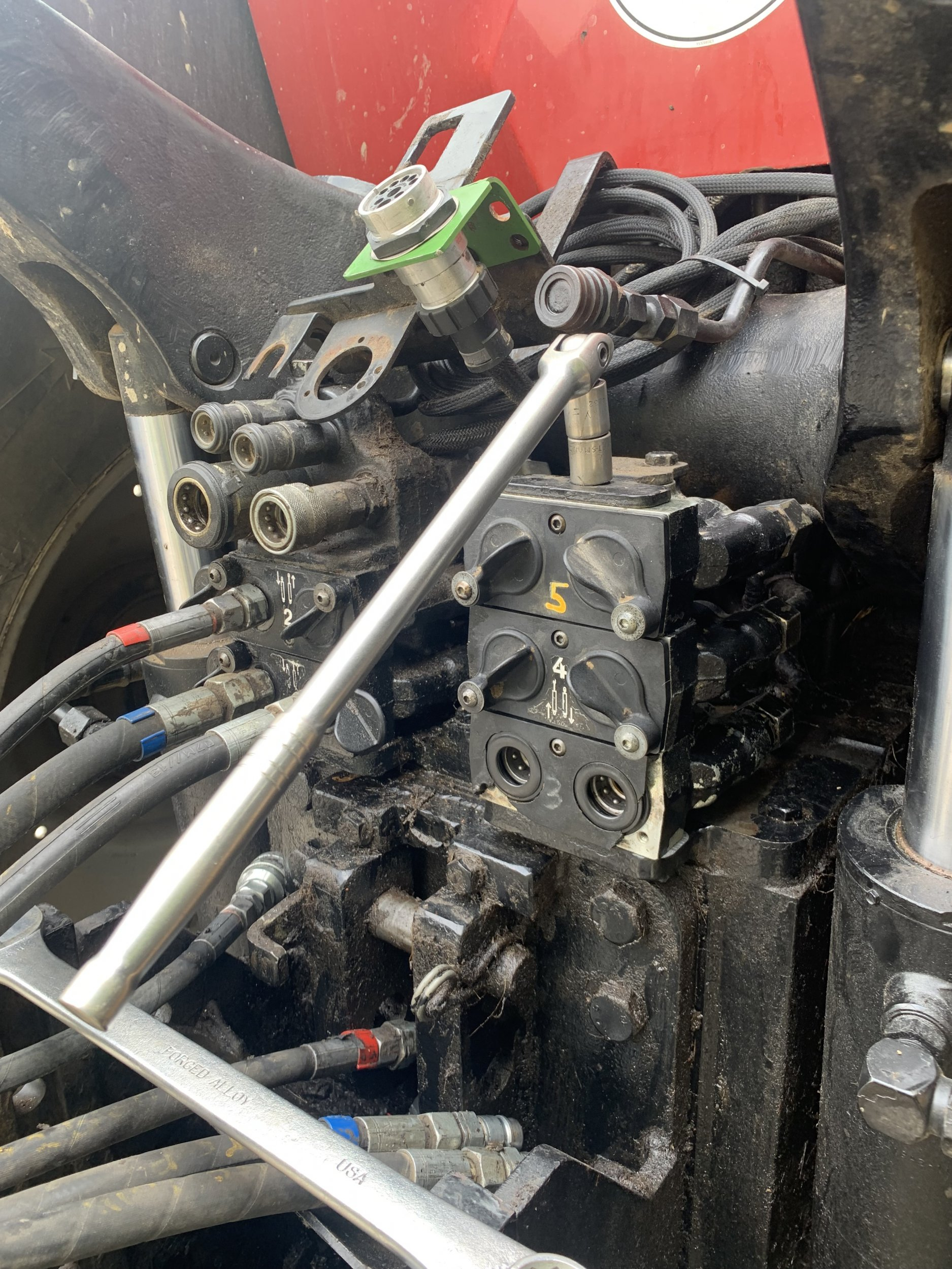

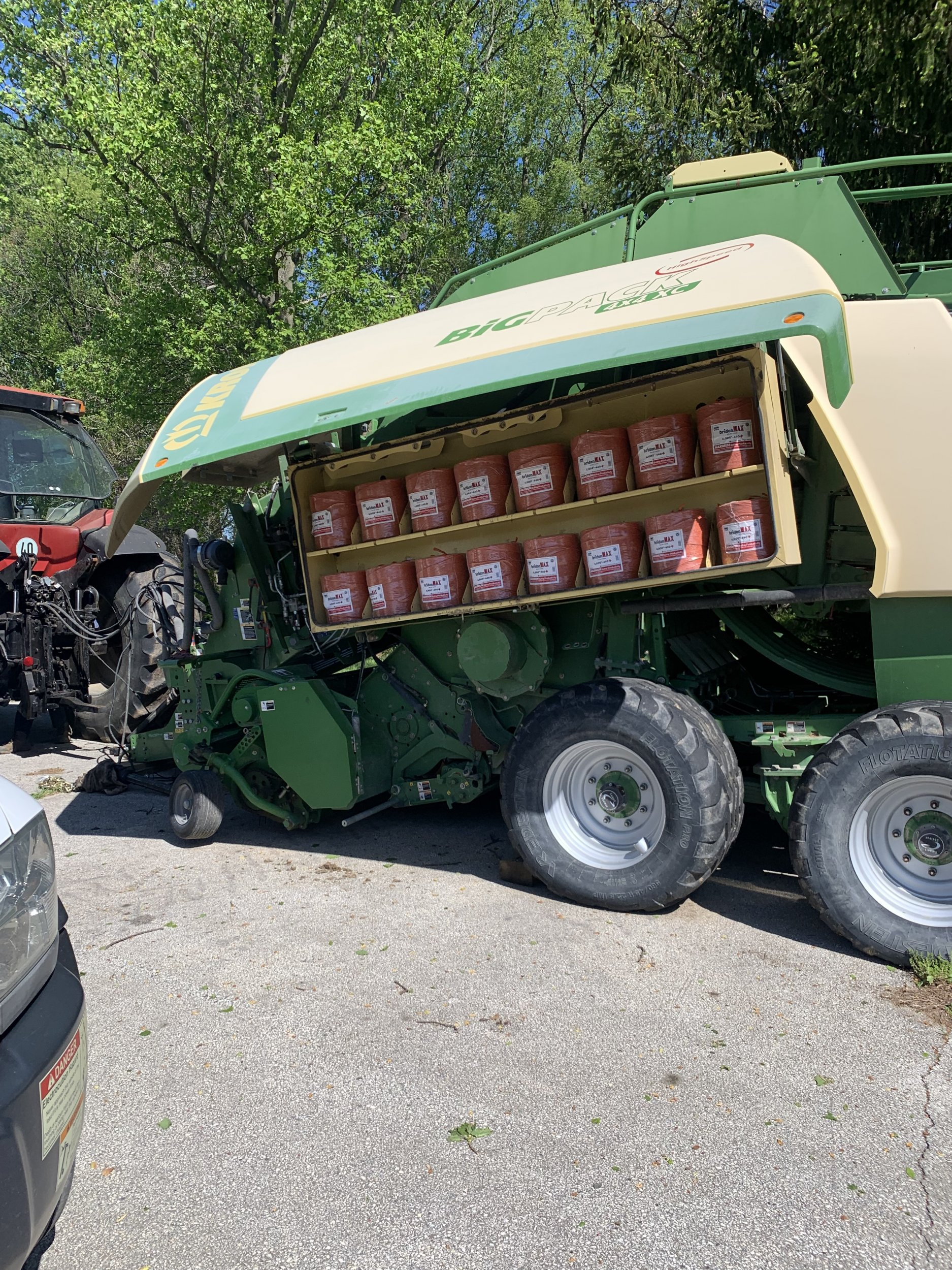

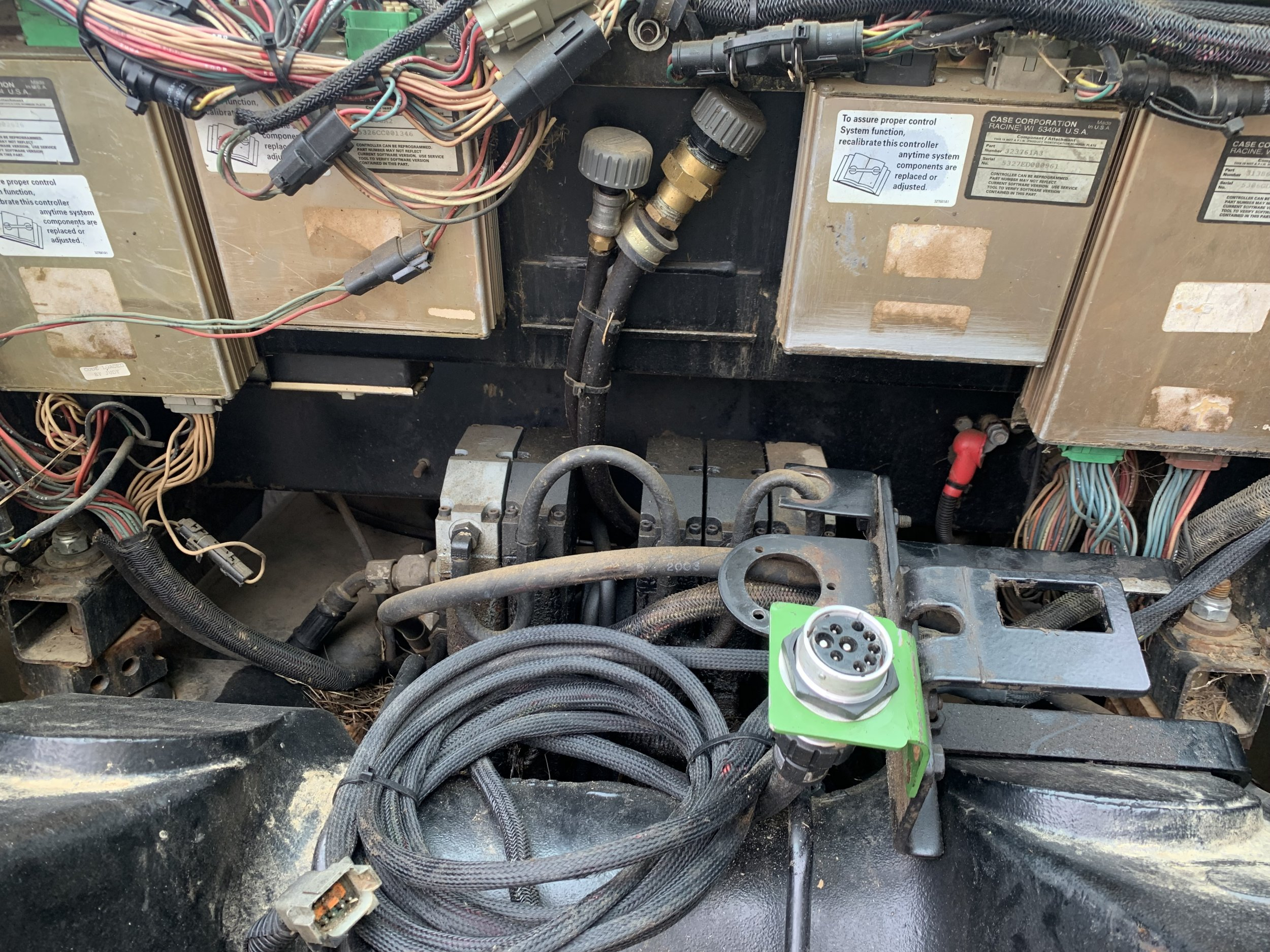

Have been going through the Krone this week. Lots to do.

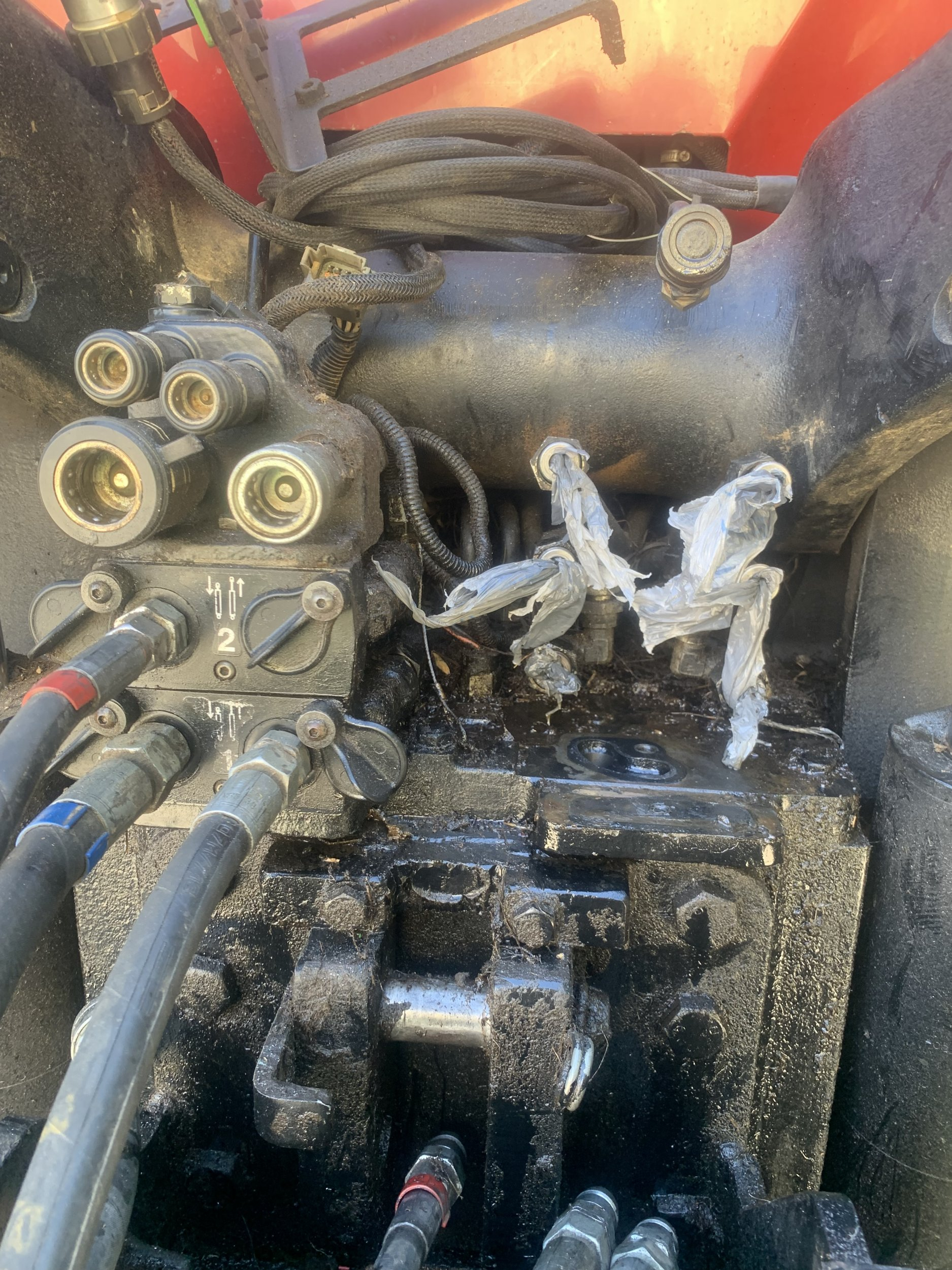

Immediately upon first run, blew a remote. Digging into it this week. Probably a bad o-ring or needs a new cartridge.
Made a big mess.

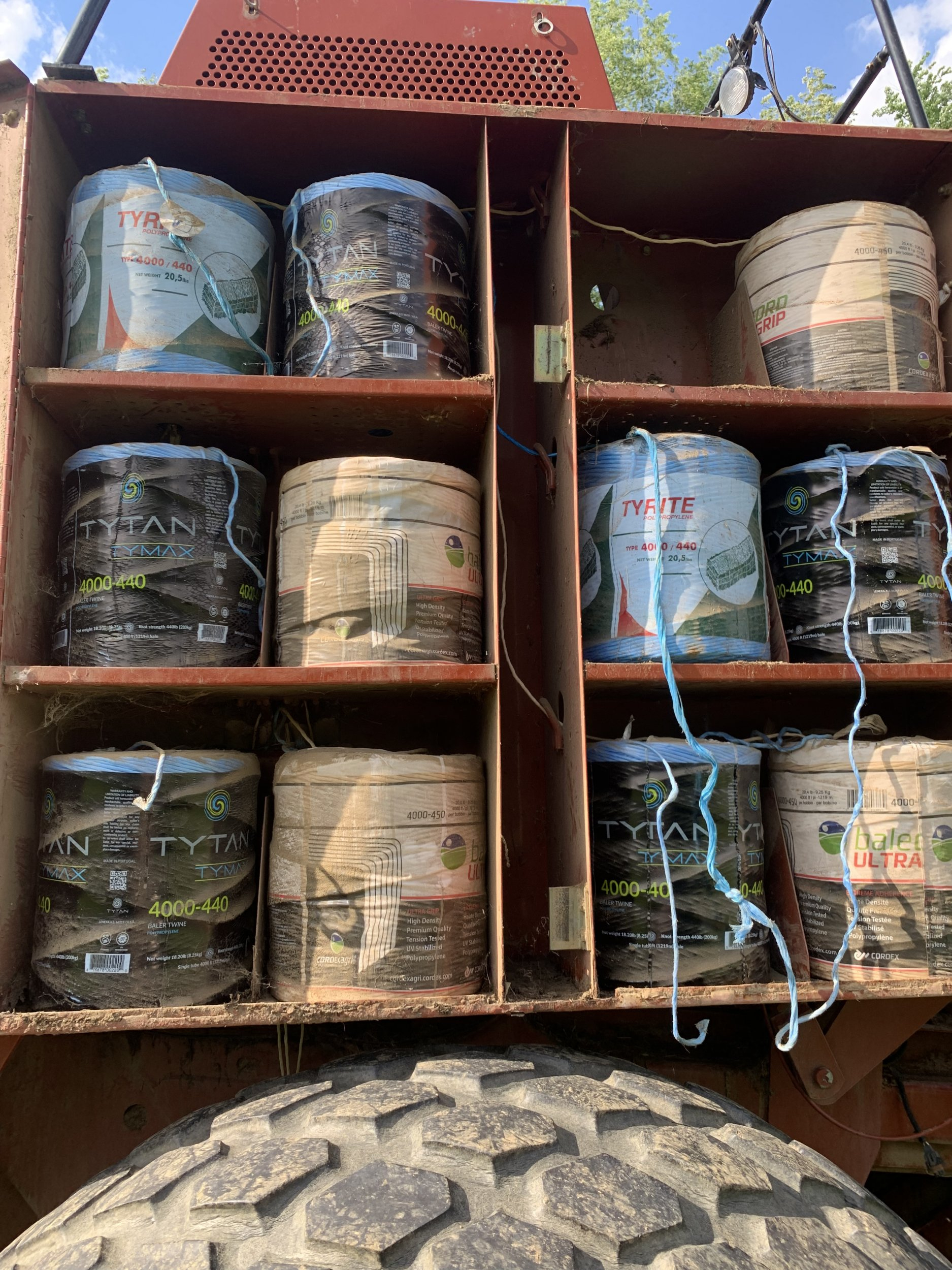

What kind of twine are you using on that bad boy?

Back to the balers. I got the remote stack re-installed yesterday. Rebuilt 3 sets of remotes, new o-rings & seals. New bottom gasket. Hopefully no more leaks. Need to re-attach hydraulic brake outlet, baler plug and trailer tow plug.
Next its work on the HVAC. A sensor is out. I think it’s the air intake temp sensor. We had to take the back cover off behind the cab on the MX-270 to check some wiring.

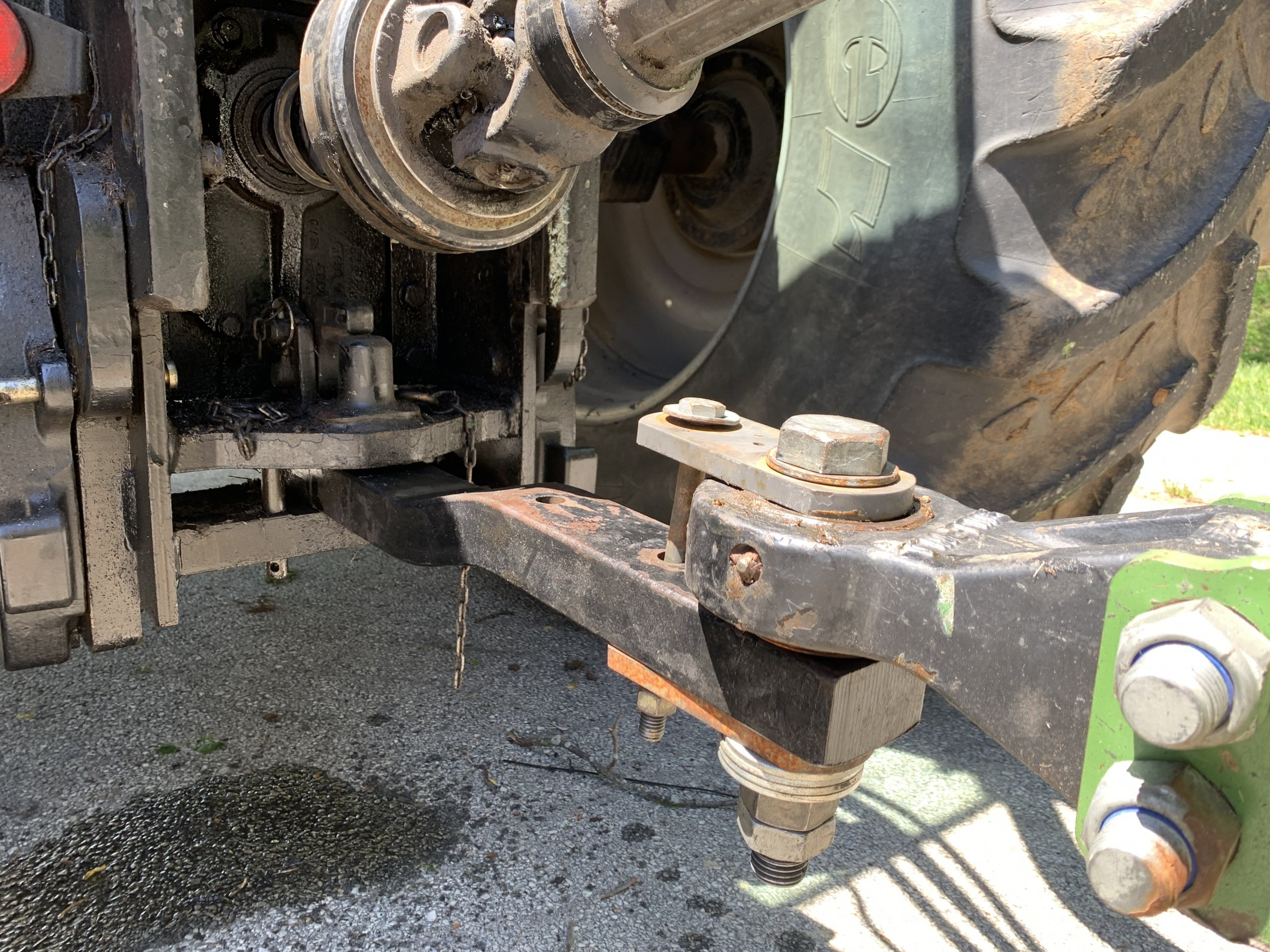

The tractor is now about ready for baling. We are still working on the hitch. The Krone baler is crazy heavy-like 34,000 pounds and we are going to reinforce the hitch

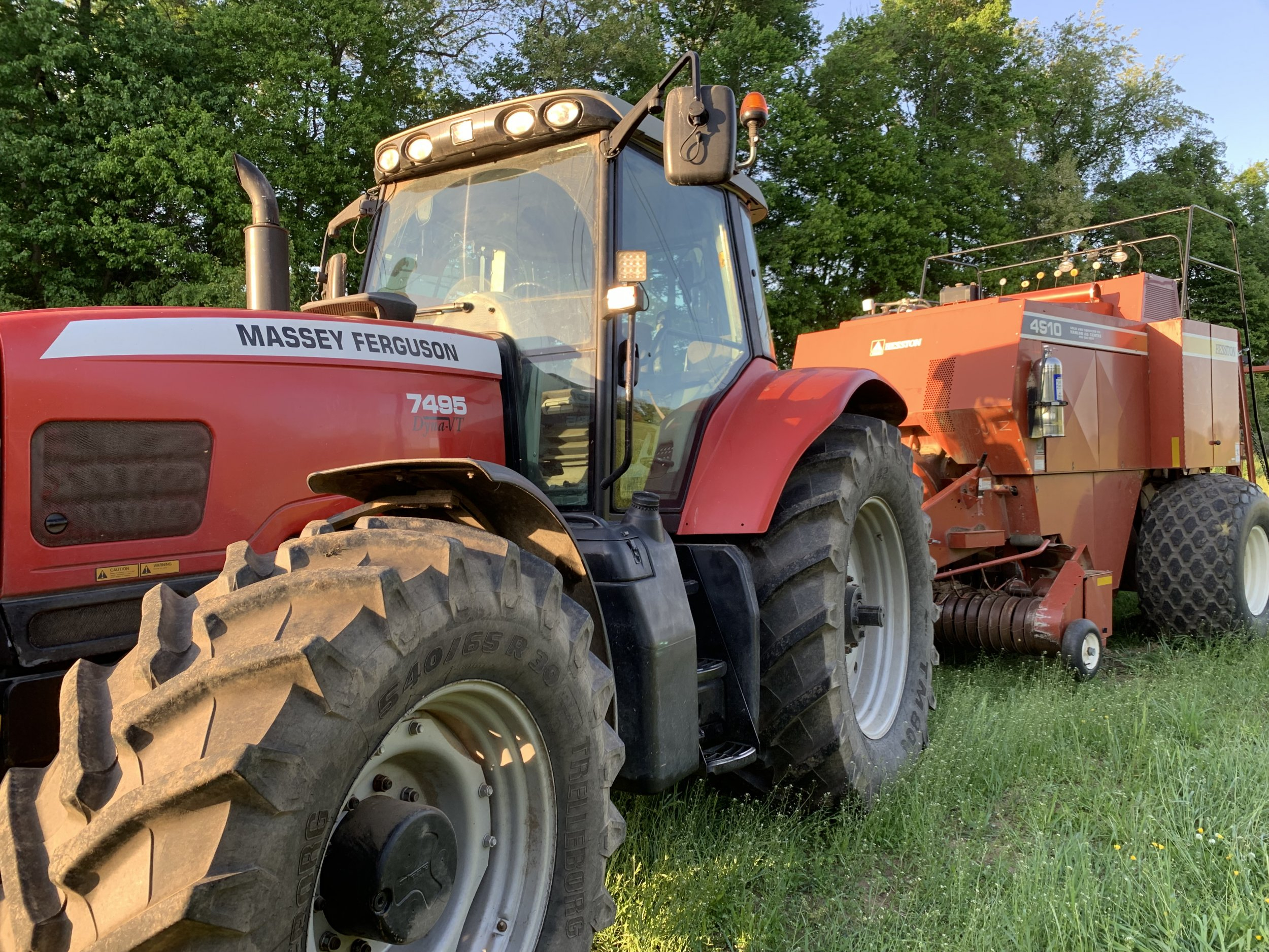

Next onto the old Hesston 4x4 square baler. What a mess. Needed to get it hooked up to the Massey 7495 and clean out the start of an old bale from some “winter baling” we did.
Its a mess and had to be forked out.
Once that was dont, time to assess the twine boxes and look for “issues”.
After about 5 hours of cleaning, I spun it up. Needs some work, but should be ready in a few more repair sessions. The Massey got a few repairs. New drivers side mirror arm, sight glass for hydraulic tank, electrical outlets for the Massey 3 prong plugs, oil changed on front PTO and finally an air hose outlet up front for blowing out the radiator!

Ahh now I recognize some of the twine on the Hesston. I worked on maintenance division of the factory that made the Cordex twine a couple years ago. They also made twine for Krone, NH, Case, etc, which was essentially the same stuff, just a different label.

Thats good to hear. Was tempted to buy the Krone twine, which was alledgedly better. Also came with a higher price. I think I’ll just stick with the Bridon or Kordex.

Yeah the Krone 4x4 XC is a “factory on wheels”. 34,000lbs. Add 2 full square bales and now its 38,000lbs. The Hesston 4910 is probably only 20,000lbs.
We will get it running best possible with no hay, then drop some hay later next week, let it dry and then rake & bale. Baler tech will be on speed-dial if I can’t fix problems as they occur in real time. First by phone, then @ $130/hour if the truck comes

It's Bridon Twine and Cordage btw, not Briton but I knew what you meant. I only run the mega balls, not the standard balls and only as a backup, said before, my customer prefers net wrapped (over the edge) rounds. The new Kubota (Kneverland) bailer I purchased last fall will take 6 mega balls and 4 rolls of net (2 in the wrap position and and 2 in the side storage rack. I only have 2 mega balls loaded (and only as a backup, just in case).
