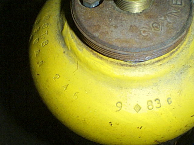

Here is a pic of an out of date hydro test, 9 (symbol) 83 c, the symbol in the middle is the mark of the person or company who did the test, the rest is the date of manufacture or test date, the actual stamping may vary slightly, person to person, but always includes the month and year and is stamped near the neck.
