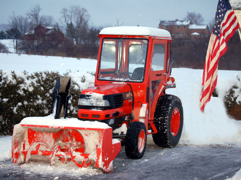

I never got around to posting this picture last winter. I found a used cab and a used front mount blower for my L3010 last December. I looked at the B3030 but it was just too small and I figured it made more economic sense to upgrade what I had instead of jumping into a L3430 Cab.
It works great. Throws snow fast and I stay warm and dry.

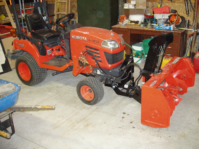

I never hooked up the hydraulics for the chute rotation last winter since I only have a three position loader valve. The regen circuit on the dump prohibits the use of the 3 position valve for the chute rotation.
I have been trying to figure out the best way to solve this problem and I was ready to order the 4-position valve for $600 from the dealer. I figured that this would be the cleanest set-up. The other day it occurred to me that if I switched the hoses on the loader valve and used the lift circuit for the chute rotation and the dump circuit to raise and lower the blower then I could use the valve I already have.
I hooked it up today and everything works great.....just saved $600. Hmmmm. I wonder what I should spend that on now?
I just thought I would pass this along in case anyone else was up against the same problem.
Kevin

Thats a nice photo of your rig. I bet that dude can handle some pretty serious snow! Nice shot of our flag with it.

Hope you've got a heater in that cab - it makes all the difference. Being able to blow snow while in shirtsleeves and listening to some great music is cool. Put a spreader on your 3ph and you'll be all set.

I assume you meant this to me?? It is a 2750 from my BX1500. The chute rotator is a Kubota unit I added when I got the BX1850.
