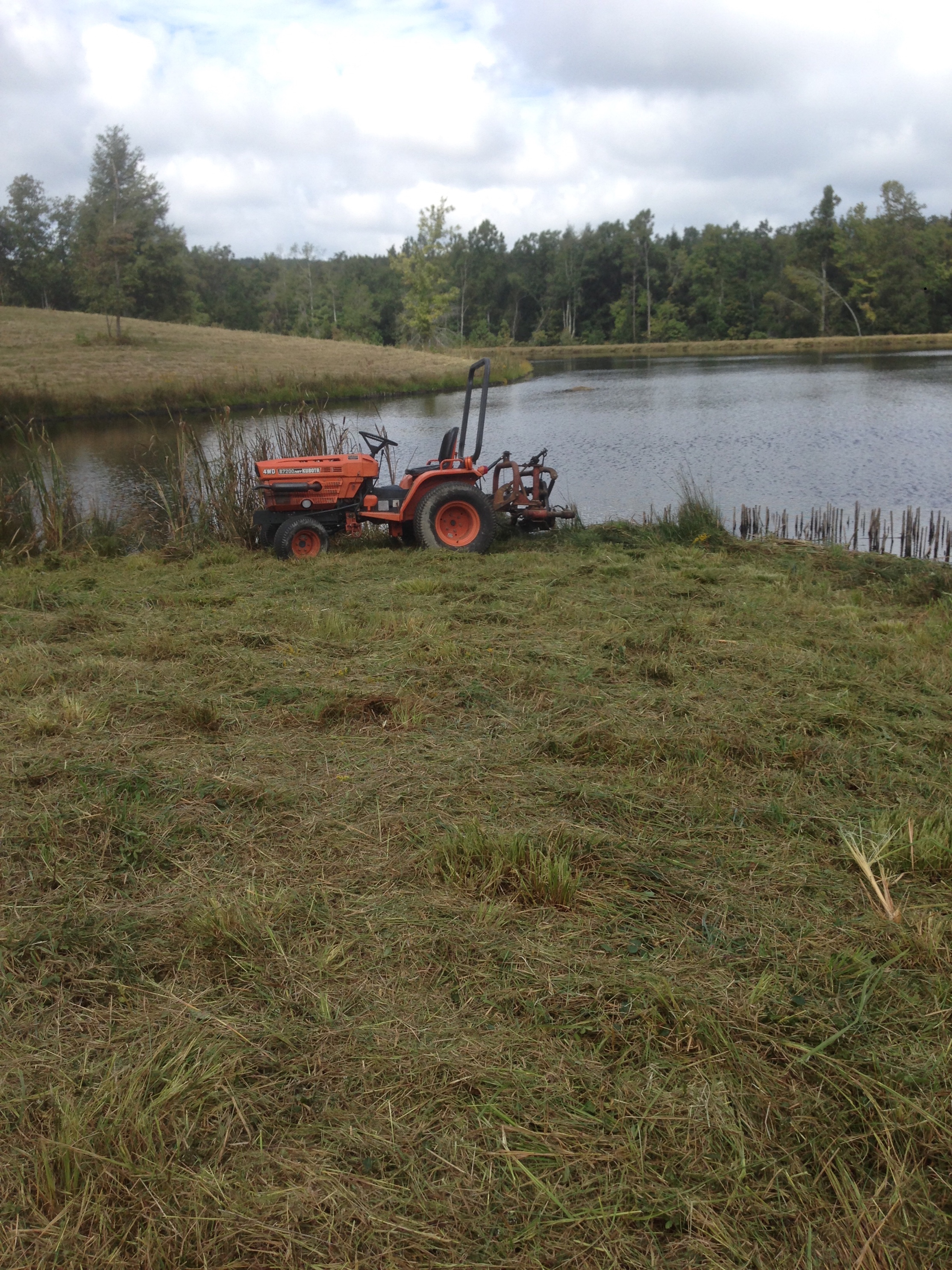

I've found cutting them down works fairly well. Some grow back but not as many as before. IMG_8233.JPG
