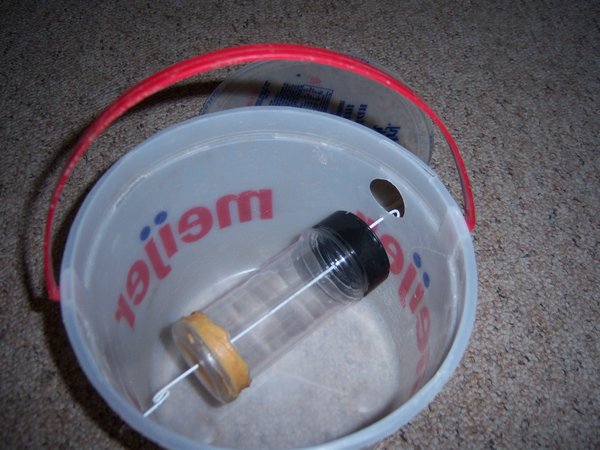

I have the same problem in my camp. regular traps only get one at a time so not very effective. A fella described a trap that keeps working.
Get a bucket and fill it deeper than a mouse can touch he bottom. use a can or some type of cylinder that you can string a small wire thru. Slide the wire thru a small hole in both ends of the can then string the wire tightly across the mouth odf the bucket. Smear peanut butter in a narrow strip around the middle of the can so the mice have to be fully on the can to get the butter. Make it so the can will easily rotate.
the idea is that the mice will get on the can/cylinder, as they eat the butter on top they will start to move to the edge of the can to get the stuff down the sides. as they move to the edge they will cause the can to rotate and fall in the bucket.
I been using it and it works great
Picture was taken from another site I am a member, here is the link How To Make A Better Mouse Trap....for Free! - DIY Chatroom - DIY Home Improvement Forum
It is not showing the ramp needed for the little varmints to scurry up on.

A few years ago, fellow Ski Patroller described, then built a bucket model using an aluminum soda pop can smeared with peanut butter as the roller. Then set it under an interior flight of stairs in the ski lodge. Within five minutes, from an adjoining room, we heard the first whir of the spinning can, and went over to find a little beggar treading water. It was the first of many in an amazingly short time.
