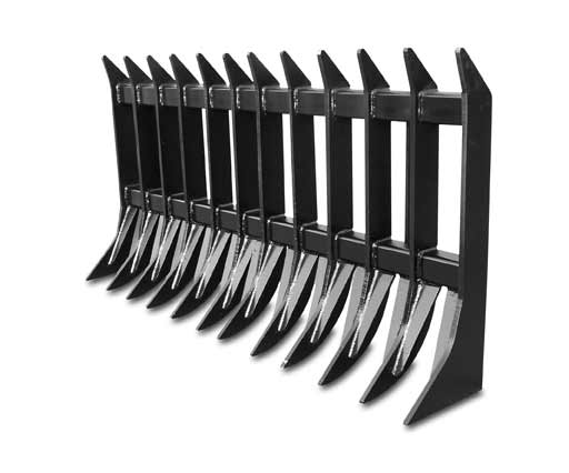

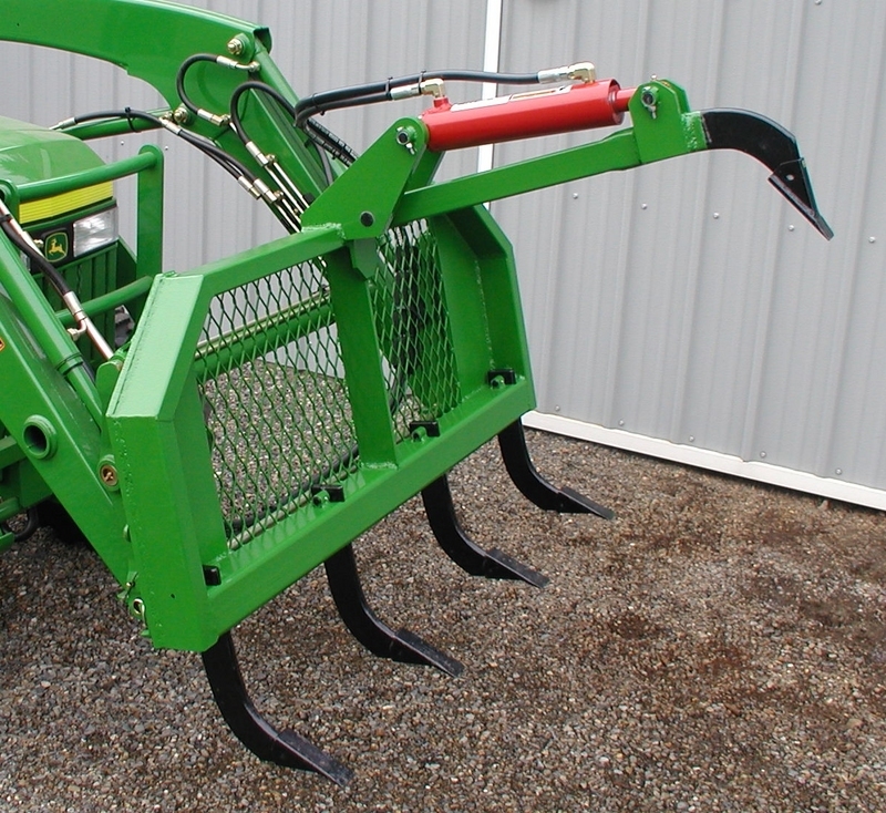

Most of the rock rakes I have seen are used for small stones/rocks, maybe up to 3 in. If yo are trying to take out 8 in rocks, then you need a heavy duty root rake to get down and under, similar to this, or this. referencing the green rake , you could cut many holes for the ripper shanks, and use as many as you need to get out certain size rocks. 2,4,6,8 or 12 shanks. What ever spacing it takes to dig out those rocks. You could take a standard box blade with ripper shanks and add some more. Might be your best option.
