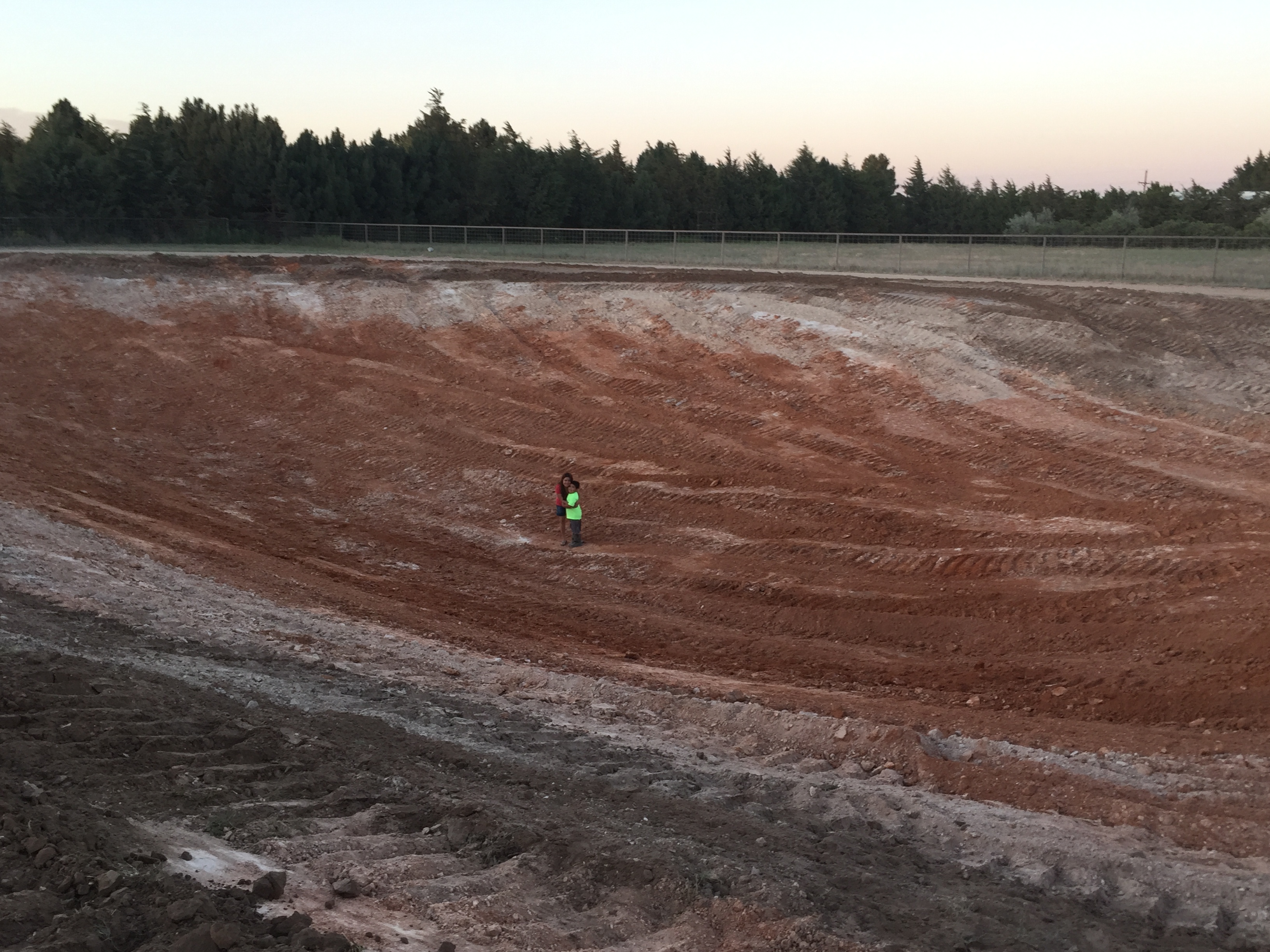

We are finished hauling off dirt - finally. I estimate we hauled off over 90 loads over dirt today - nearly 2,000 yards. Tomorrow they just have to do the shaping and finishing touches.

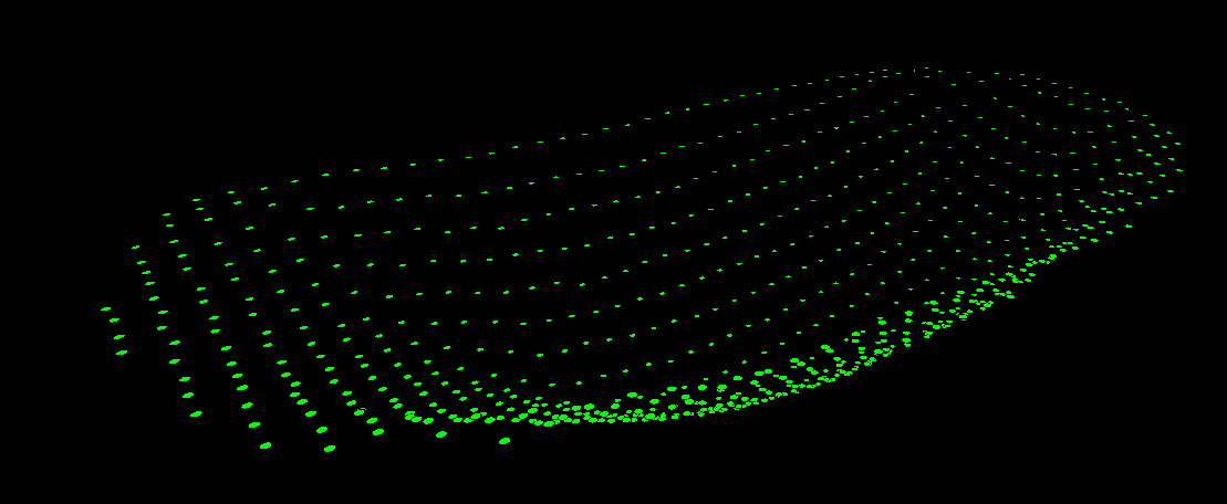

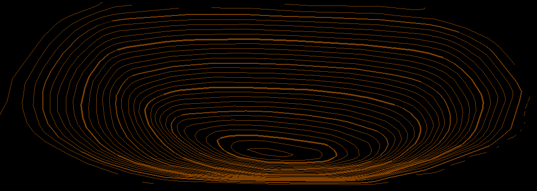

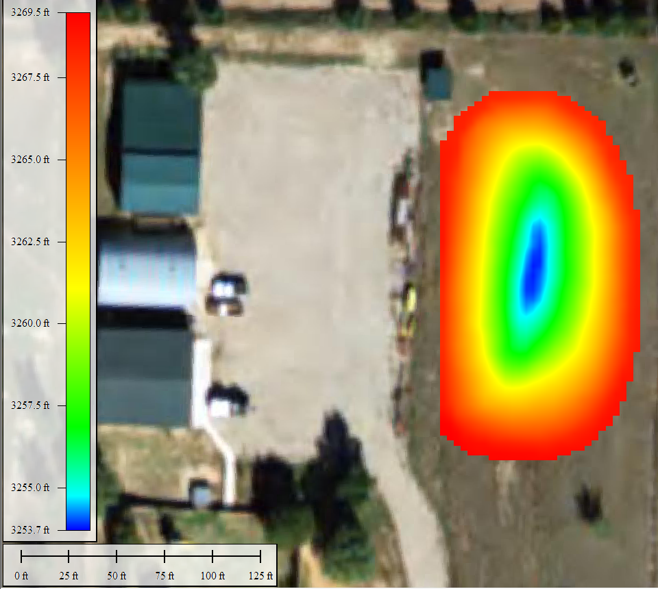

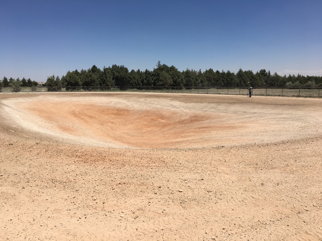

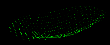

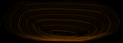

Well it is done. At least the digging. It ended up being 0.4 acres, 16' deep at the deepest, and we removed 4,003 yards of dirt. It will hold 808,500 gallons of water.
It will be filled from an irrigation type well I had drilled last year. It flows 70 GPM so should fill it in 8 days. Seems like an awful lot of water to pump but the farmers around me have center pivots and every time they put an inch of water on their 160 acres circle that is 4.3 million gallons so my water consumption is a drop in the bucket to that.
After it was done I built a 5'x5' grid and surveyed 780 points across the pond to get the exact area and volume.
