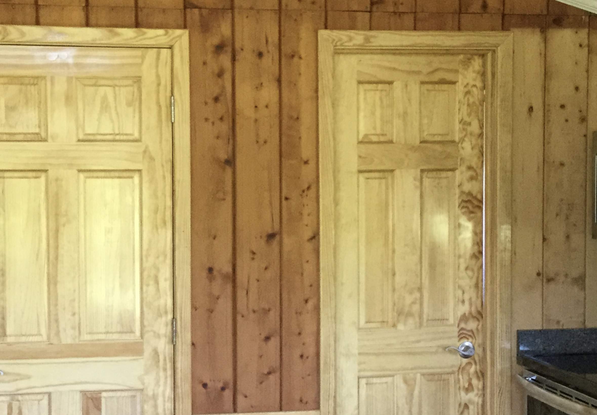

Here is an example of aged T&G southern yellow pine installed in the early 70's that had been given a poor polyurethane coat. Pine just soaked up the clear coat available back then. On the right is an area that was covered until recently. The beautiful pine doors are new but maybe in another 40 years it will all match. No direct sunlight, fireplace, smokers, etc. I'm not a fan of the orange color but love my little cabin.

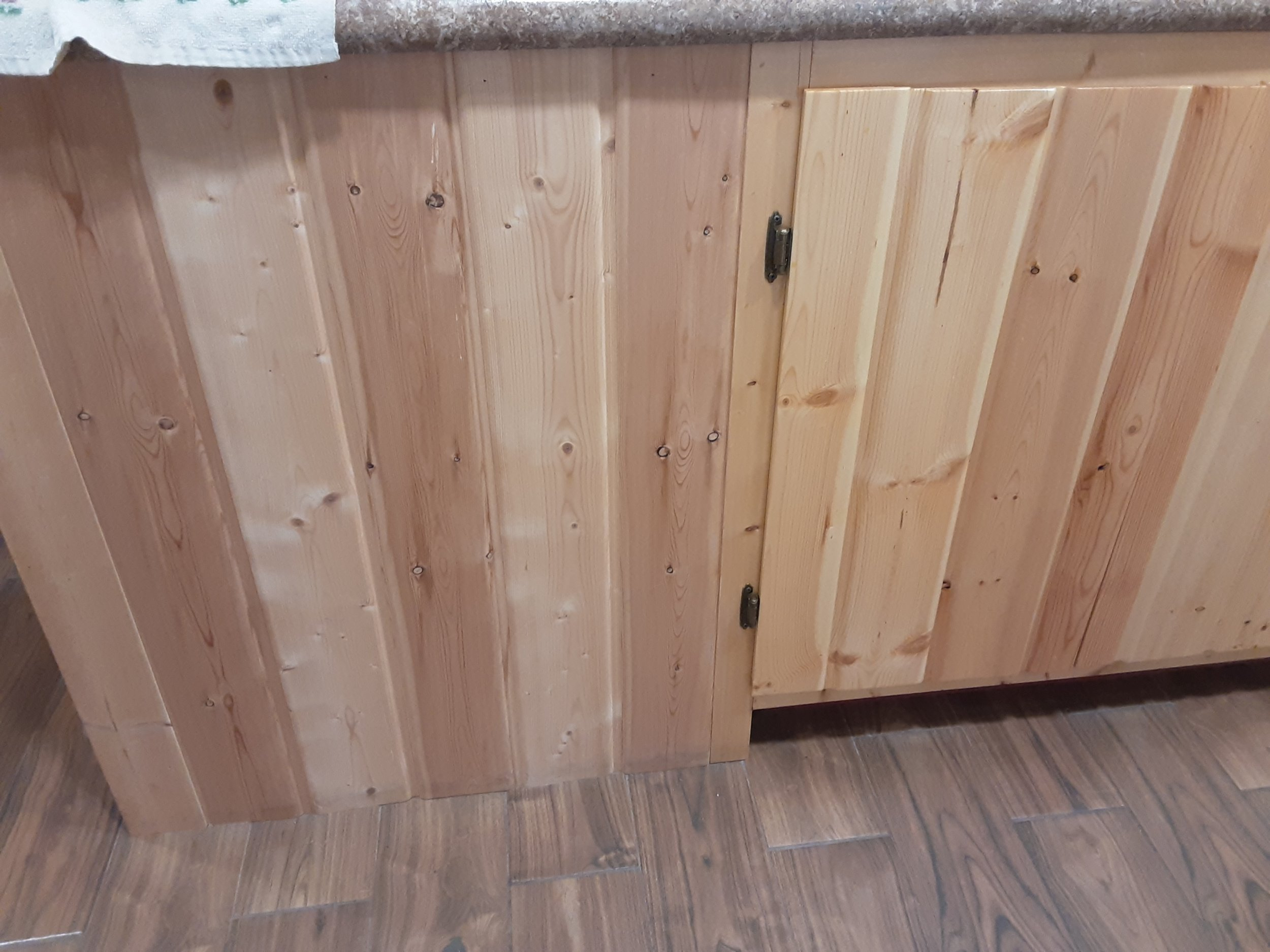

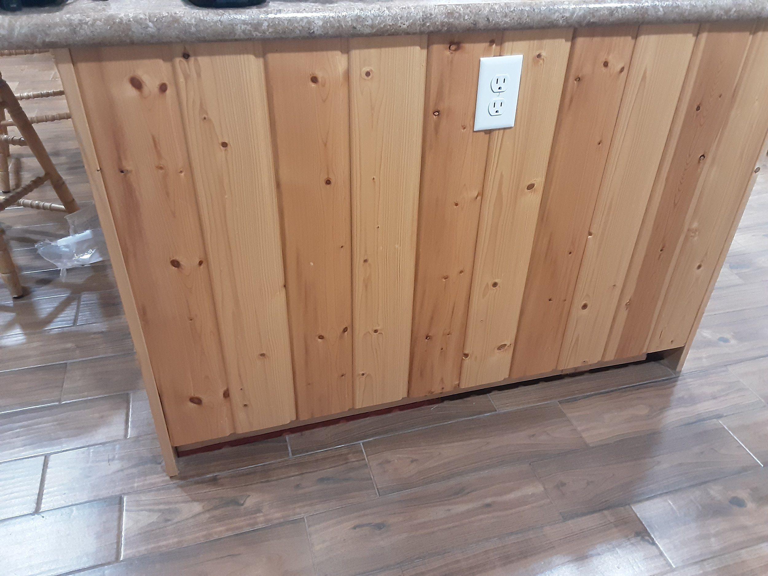

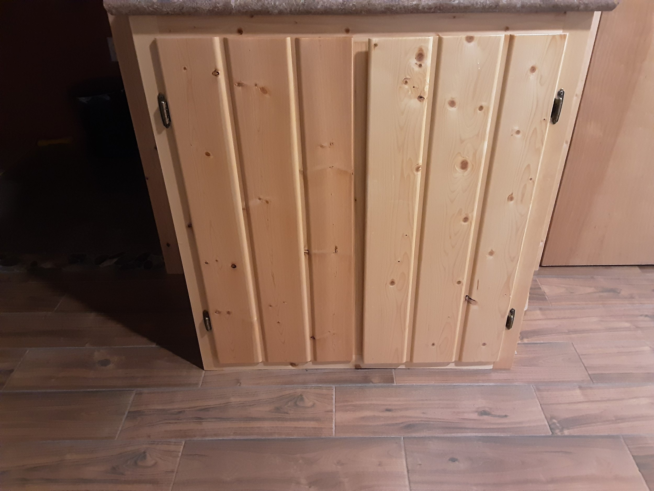

A little late to the post. We like the ambered look of knotty pine T&G. Our old house had ambered over the years. Don't know when the T&G was put up.
In our new house I am building the cabinets using knotty pine T&G. Look at some of the boards below. These are finished with 3 coats oil based polyeurethane. Some of the unfinished boards were a more red color. The second picture shows a finished door on the right, while the left is a temporary unfinished cabinet space for a future dishwasher.20210424_195811.jpg20210424_195728.jpg20210424_195713.jpg
