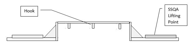

I was wondering if any one ever lifted with their fel with no bucket or forks on it .I have a ssqa was thinking to get a flat plate and weld some hooks on it.This way I can increase my lifting capacity by lifting closer to pins and not adding the weight of the bucket or forks.My loader is a 7308 and is pretty weak.:drink:
   / getting the most out of your fel #2
That sounds like it would work, other than you may lose a little height.

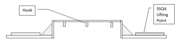

Yes. It does work well. Depending on what you want to lift and how, I think that one could even make a lifting plate that would put the lifting point even with or aft of the pins maybe one of our mechanical engineer friends could tell us if putting the weight close to the cylinder lift points on the boom might increase lift even more?

Yep, will work mathematically just like you'd expect.
Another trick to gaining lift capacity with the bucket is weld a hook to the back side of the bucket so you are lifting at or behind the SSQA.

What I thought. If height is an issue the lifting plate could be made higher than the SSQA top plates and open at the bottom to permit load swing aft during the lift.

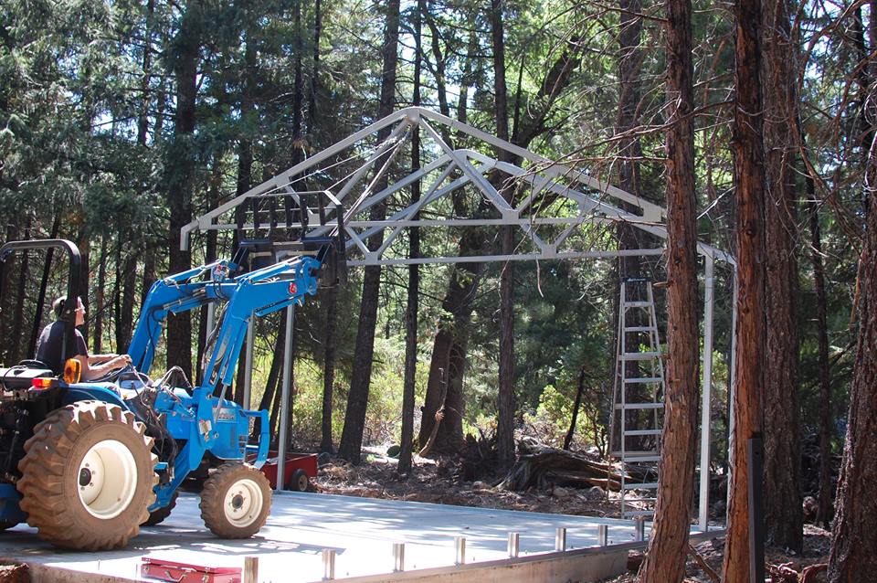

Got me thinking on that - I have another 20x40x9'-walled workshop to build so I will be using my 1 hour cobbled together gin-pole to lift the trusses into position. Maybe I'll work something like this up instead and make a permanent gin-pole to use for whatever as the needs arise. Use 2-2" receivers to connect a double arm square tubing gin-pole to the plate so it can be removed later and then could use the receiver(s) for hooks for straight lifts with the same plate. etc.
I don't have any issues lifting the trusses with what I cobbled together for the project, they are plenty light even with the added arm out there, but another implement is always nice to have - especially on that is pretty easy and fun to build.

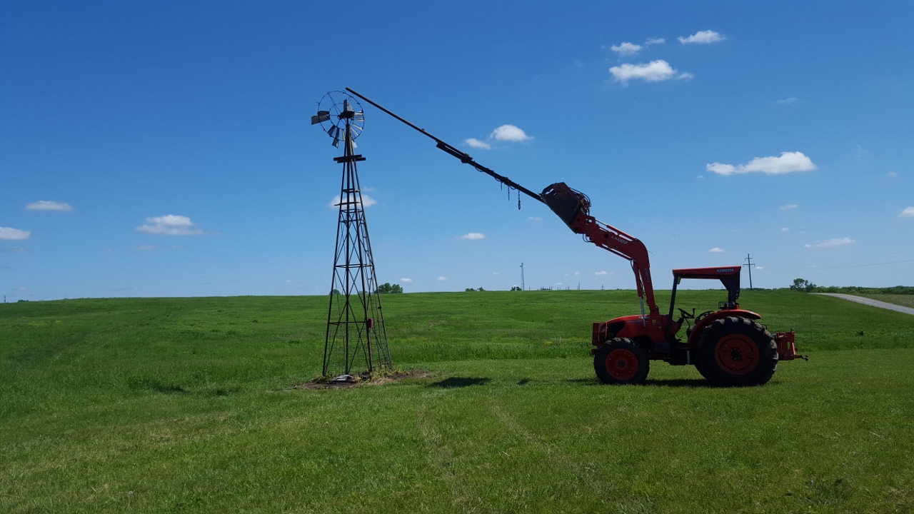

Oh man, you should see my cobbled up jib........ OSHA would have a screaming fit...... :)

The only downside to a bare SSQA plate is it won’t stand on its own so you will likely need to wrestle it to attach. This could easily be remedied by welding on some lightweight legs to hold it upright when not attached.
