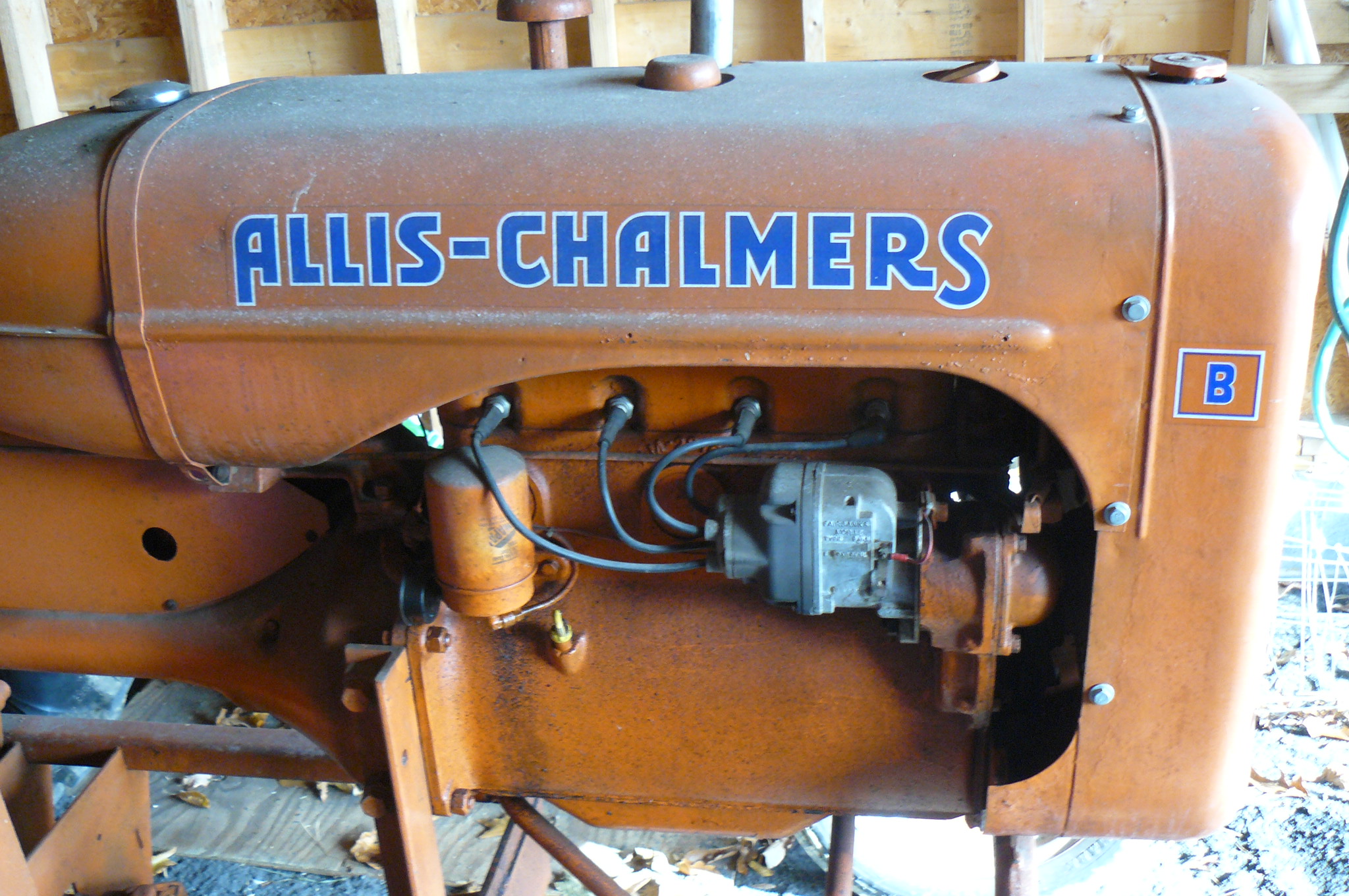

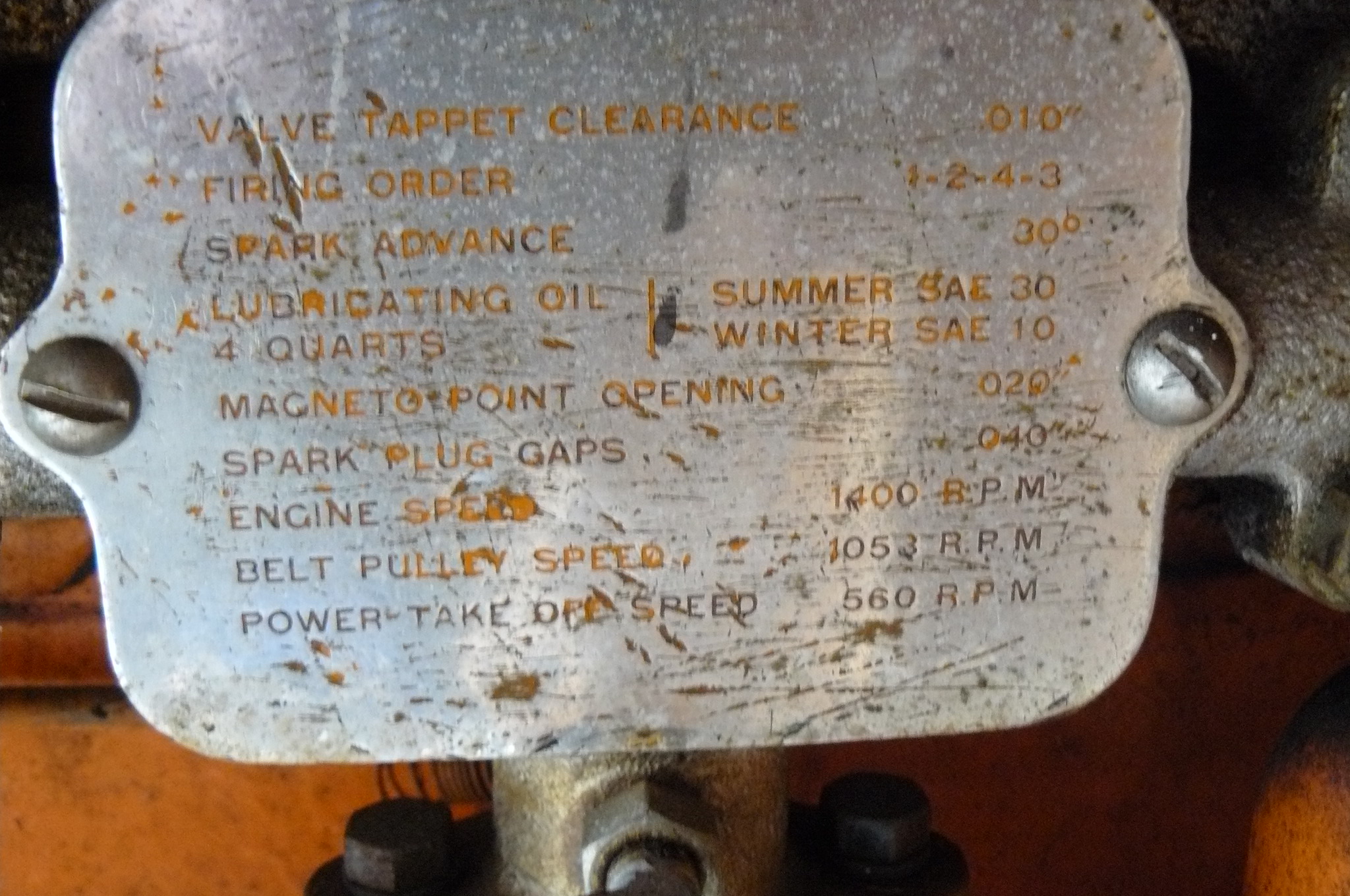

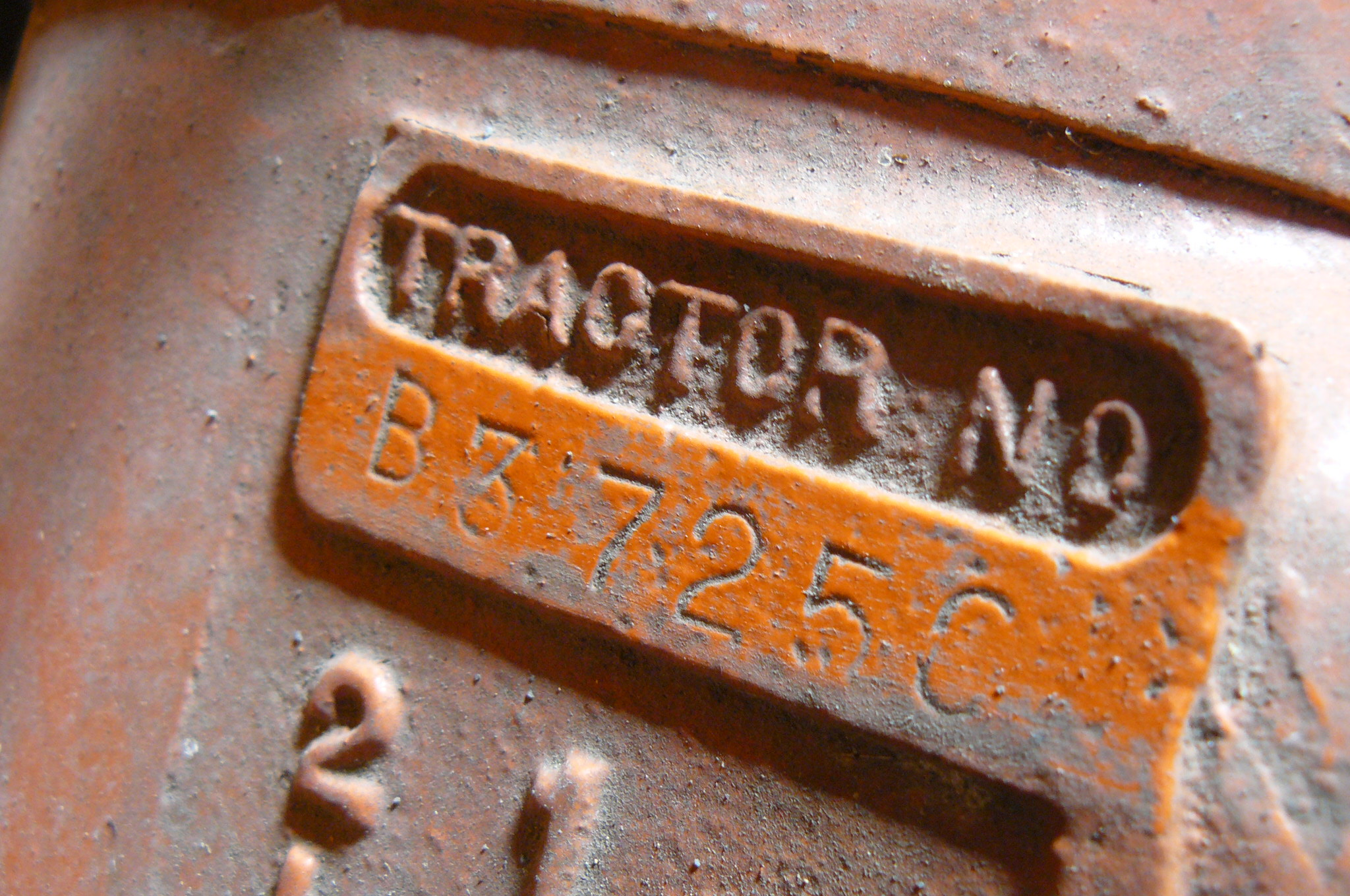

Sharing a barn with my equipment is the farm owner's Allis Chalmers B, which was restored to some degree many years ago.

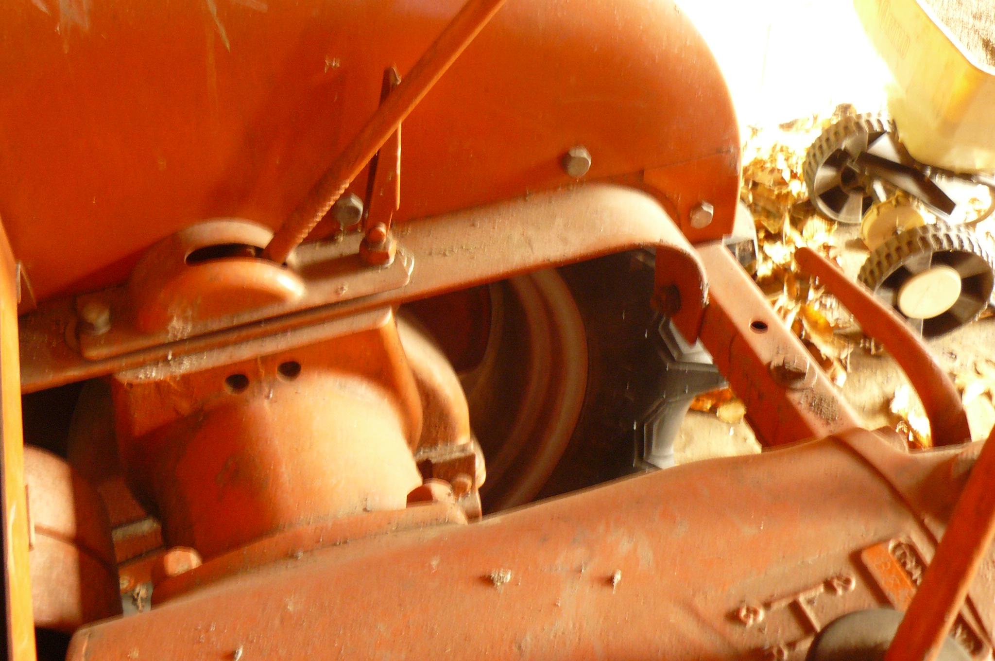

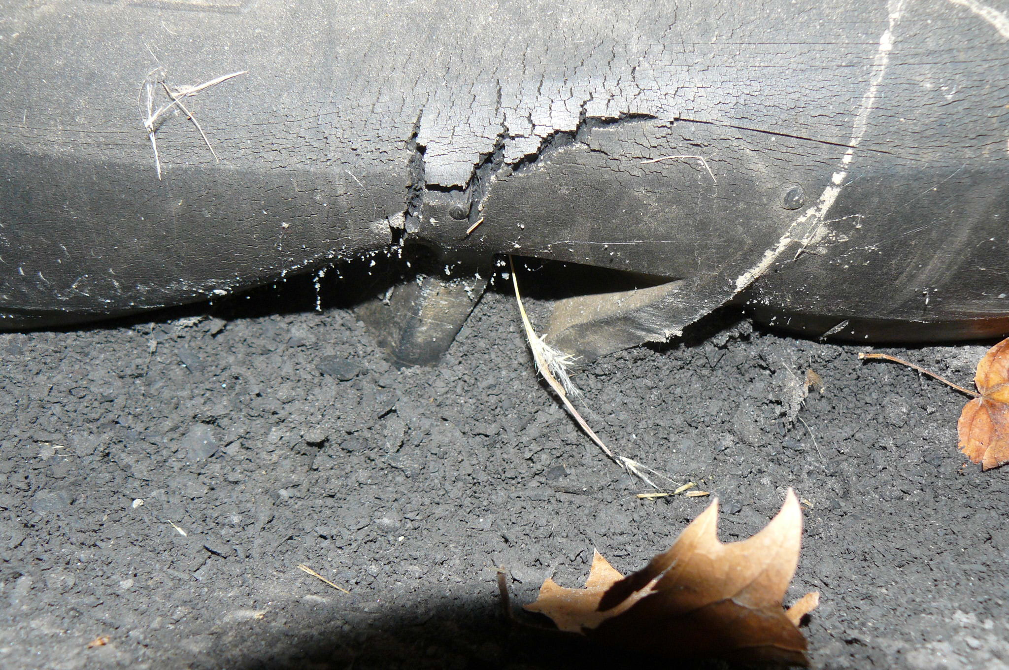

Basically needs a good bath, and then I'd like to run it. But the rear tire went flat, no one noticed it, and it damaged the sidewall.
Hope it still holds air, the tractor is basically an ornament and won't get used hard ever. Neat tractor, though I've never manually started a tractor before.
I think I've figured out most of the controls by just looking at them and thinking things through. Not sure of the choke yet.
And think I might just drain all the gas out as best I can before doing anything else and put fresh in. And some carb cleaner.
The owner of this delightful old tractor knows how to run it, just getting older and not up to climbing aboard any more.
I was hoping to work on it over the winter and fire it up in the Spring. Unfortunately the shed is open in the front, so unlikely I'm going to have much heat.

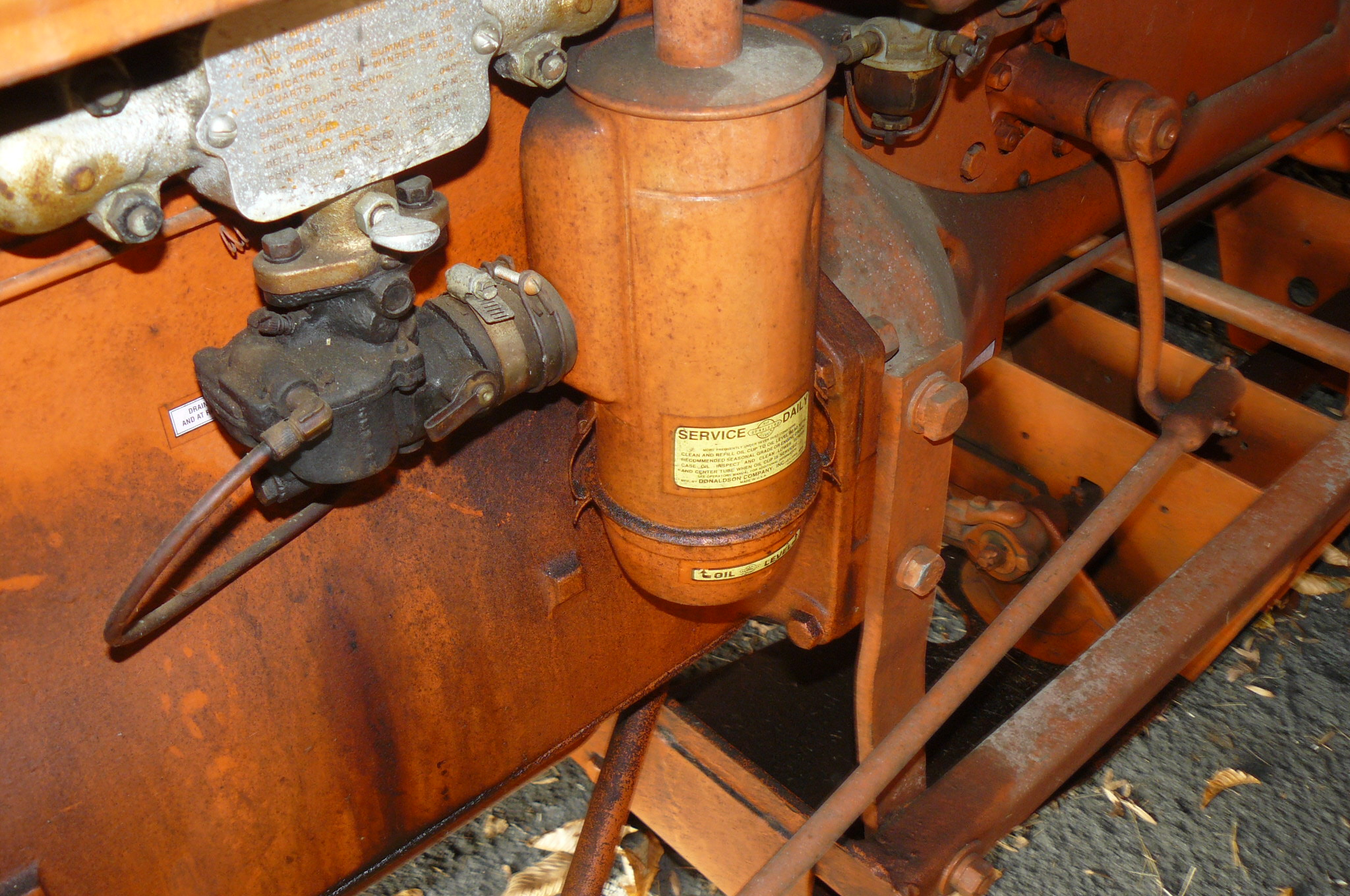

I love the way the old oil filter was painted over. Likely time that filter got changed, and any others too.

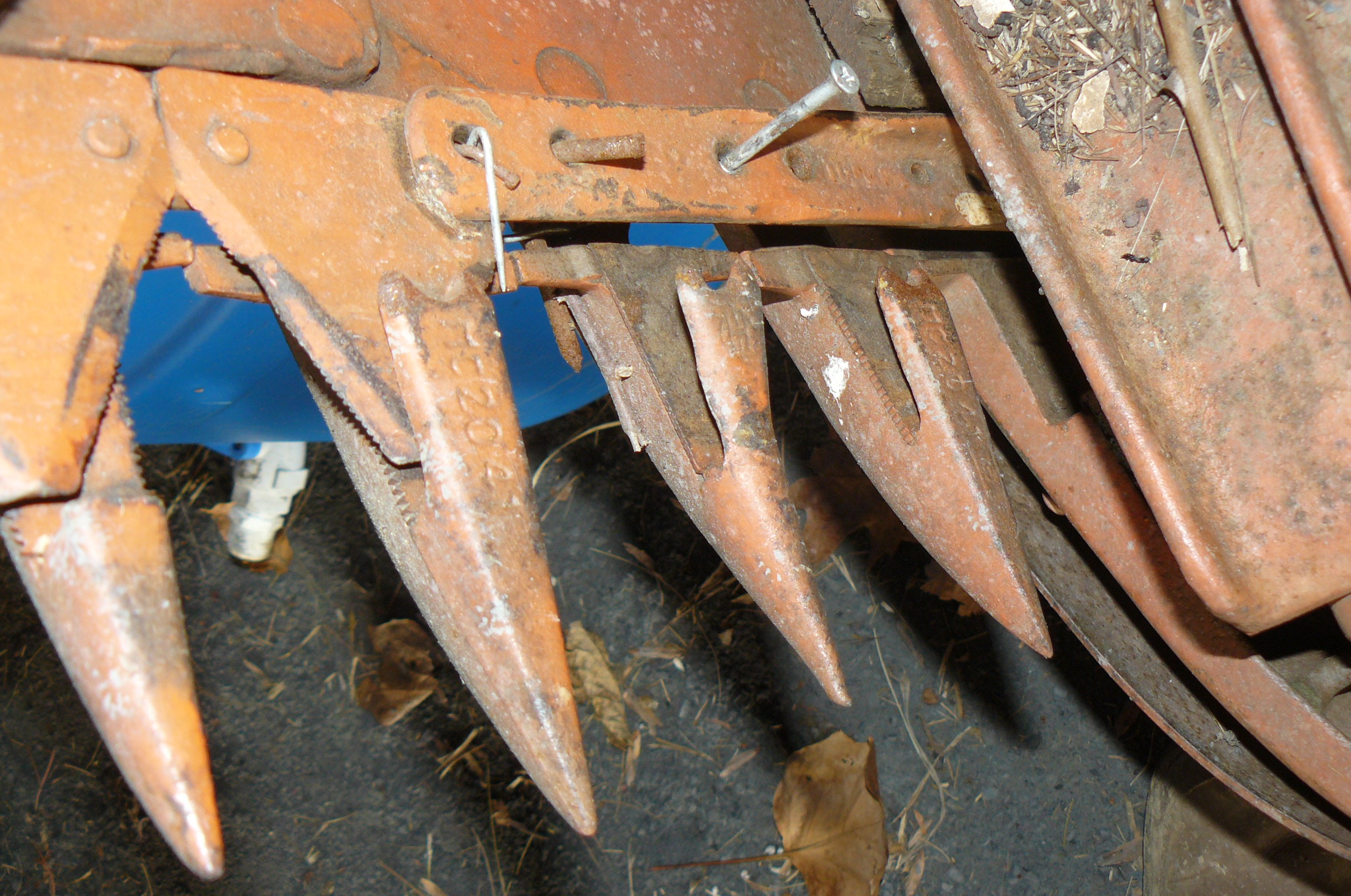

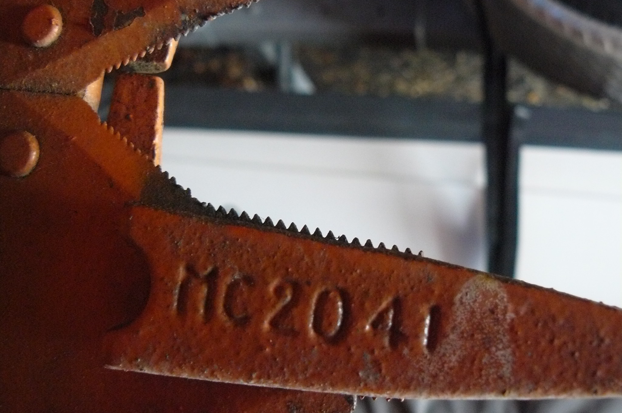

I've done this sort of thing before, but have zero experience with this tractor. Might like to get new cutters for the sickle also. Interesting that Japan is stamped on part of the blade assembly.
Lot of moving parts for sure. Open to all advice and appreciate it. Drew

Nice old tractor. Draining the gas tank is a good place to start.
I'd pull the plugs, spray a little engine oil into the cylinders, and try to spin the engine with the starter to check if the engine is stuck. And check the oil gauge while you're doing this to see if there's any pressure. There should be at least 5 psi. You can also check each spark plug wire to see if you're getting fire. If not, check the output of the coil for fire and check the distributor points.

a fram c159 is likely what screws on.. though looks like a napa on there now.
when you remve the old one.. make sur ehte stem stays on the base and is not tossed with the old filter.. or you will have no oil pressure.
ditto on putting some atf downthe plug holes and cleaning the plugs.
after the oil treatment, I';d see about rollingte engine over by hand a few times, plugs out.. etc.

That is a lovely old tractor. Getting harder to find farm fresh originals. Although the tire looks bad, it could last a long time. If crank starting, make sure you have the owner show you how to hold the crank so you don't have your thumb dislocated. You want your thumb with your fingers (not your normal handle grip).

Going to haul a larger air compressor up to this barn, and a portable gen, and put some serious air into these tires. The compressor in my not inexpensive battery jumpstarter
is utterly useless on larger tires. Need a bigger wrench...

There may be a drain on the bottom or that carb. If so, it would be a good idea to clear that. I believe that the magneto will have points, very similar to a distributor if I recall; but it's been a lot of years since I've been inside one. They might be OK, so check the spark before you take anything apart.

I didn't see a battery in your pictures so I presume you have a magneto ignition. Check your points/cap. etc for corrosion, clean/replace as needed.

NAPA number on that oil filter should be FIL 7011. Rather pricey, as they show $16+ each. I bought 6 through Fleet filter(Wix), for about $6 each. They also fit the V series Case tractors, and on up through the 310B I had. Soundguy changed the filter on his VAC a while back, if not a NAPA, that may be the crossed number he posted for Fram. Those are known as partial flow filters. Don't get real excited if it doesn't show a lot of oil pressure.
Mag is a Fairbanks-Morse. Either a FMJ4B3 or FMJT4B. Parts still available.
Those are pretty powerful little tractors for their size. 125 cu. in engine compared to the IH C-113 in A''s B's & C's, and C-123's in the Supers.
Carbs were either Zenith, or Marvel-Schebler.
A buddy of mine has been getting into the A-C C's and CA's, so I'm learning a little about them. We had dealers around, but just never seemed to be a popular brand around here. Mostly IH, J.D. and Massey.

yes.. a fram c159 is a napa 7011 but a c159 is a lil cheaper.. about 4$ cheaper than a 16$ 7011

A word to the wise on the mag. The cover with the 2 screws is the cap. You would find the rotor under this. The main cap assembly is held on by 4 screws. This is where the points, condenser, and coil are found. On removal of this cap, it is likely to throw the ignition timing off. ( rotor is driven by a fiber gear) Set the engine just before #1 ( #4 exchaust valve just closing) remove the cap, and make sure the rotor faces before#1. Also, it's far easier to work on mag out of the tractor. On the oil filter, the oem filter from Allis had a wood dowel installed to keep the fiber of the filter in place. The only filter that has kept this was the Baldwin filter. Allis had oil pressure issues, years ago, with filters being shipped without the dowel. I may still have service bulletin on it from the company.
/ Getting the old girl going #13
biggest oil filter / pressure issue was when some oems went to paper pleted filters instead of the filter floss.
napa even had this issue.. fram, at the time was the only one I could find with floss filters. since then, napa figured it out and made a compatible floss filter. ( well.. not napa.. but their suppliers.. mostly wix..e tc.. )
