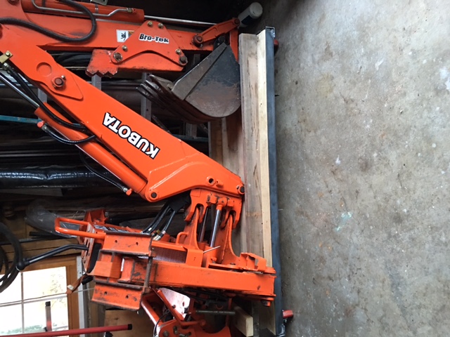

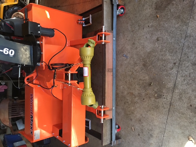

You also have the manuals now too so start reading now and you will know what to do when at the dealer. As far as the storage container and taking BH on/off inside the container you typically need to put the outriggers down as part of the removal so you need about 7' wide to do this. Also for ease of storage and moving I built a dolly for the BH to sit on during the winter when I have the rear blade or snowblower on for snow. This makes it easy to roll around and position for removal and replacement.
The dolly inside your container would allow you to move to one side to get access to your other stuff. In reality you probably wont take it off/on very much - mine goes on in the spring and off in the fall - takes 10 min - it takes longer to put the 3PT arms back on.

I love the idea of the dolly, I didn't think of it so thanks for that.

As far as a dolly - you can buy 2 of these dollys at HD 18" x30" $15 each and build the wood platform on top for a quick and inexpensive dolly setup. https://www.homedepot.com/p/800-lb-Capacity-Wood-Moving-Dolly-WFD1830/202259417
