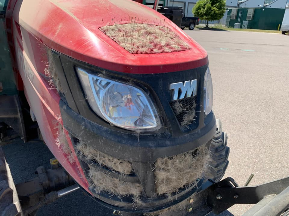

98F - WoW!! Brings back a thought - "only fools and Englishmen go out in the noonday sun". I don't mow with my tractor. But I VERY carefully check the radiator and fins with a flash light. Once in spring and again in the fall. The radiator screen collects everything on my tractor.
   / Getting Warm #14
I never use water as it makes the dust turn to cement in the fins. I reverse blow out the fins with air EVERY time I mow and have never had a problem.
Mine get cleaned with a Rad Genie after every field use but and I say but before I even set up to clean them, I take a 'spritz bottle with water and Dawn dish wash detergent in it and spray down the rad from the fan side and the front side, soaking the rad fins. Dawn has a desirable effect, it loosens any crud and allows the 'Geine' to flush it out much more easily.
Been doing that for years and other than a stuck thermostat years ago, I have no overheating issues, no matter how hot it gets outside.

Be careful using Tide as it is alkaline in nature and can can cause corrosion with non compatible metals. Dawn dish wash liquid is much better.

My air filter looked OK, but it was gray with carbon from the exhaust. The L2501 is great because it lacks emissions equipment, but it sucks because it lacks emissions equipment. Besides the lack of power inherent in a 25HP compact tractor, it will smoke slightly when under load and at start-up. Nothing bad, or even really noticeable, but the air filter gets covered in carbon black within 40-50 hours. Blowing it out doesn't work, so I replace it. This one I could still see light through.
I have a portable air tank that I might start bringing with my. I usually just blow everything off (including radiator and screen) with a handheld battery operated blower. But I think a yearly deep cleaning is needed. I've run the tractor for four years without issue, but then again, I thought the radiator was clean from what I could see. I was wrong!

I'll try the Dawn trick. I usually have a sprayer with a light Dawn/water mix anyway.
