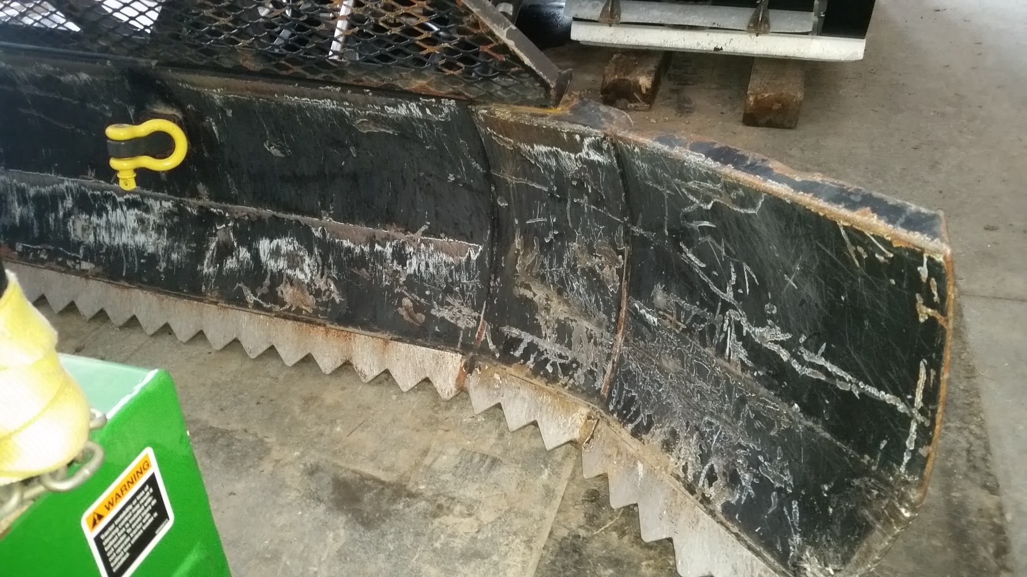

I deal with the "get yourself unstuck" issue with a snowcat used for trail grooming. The need for winching can be off the front or rear, so the solution of a 2" receiver winch mount (post #11 above, for example) works for that. We have 2 inch receivers weld into the front blade and the onto the rear grooming implements. Winch can be installed temporarily either end and connected via heavy power cables with Andersen connectors. Neither of the implement attachments were designed for pulling like this, but for getting unstuck the winch is just "assisting" the tractive force of the snowcat and we never apply jerking force. So it works well and nothing has busted "yet".
Front blade shown here with a new shackle. This is for pulling out stuck snowmobiles. (Getting a snowmobile stuck while pulling an implement is easy. No training required.)

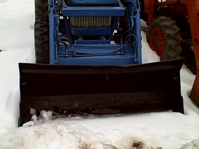

Yeah, I would never want my bucket to look like this one--it's even in the wrong color.
