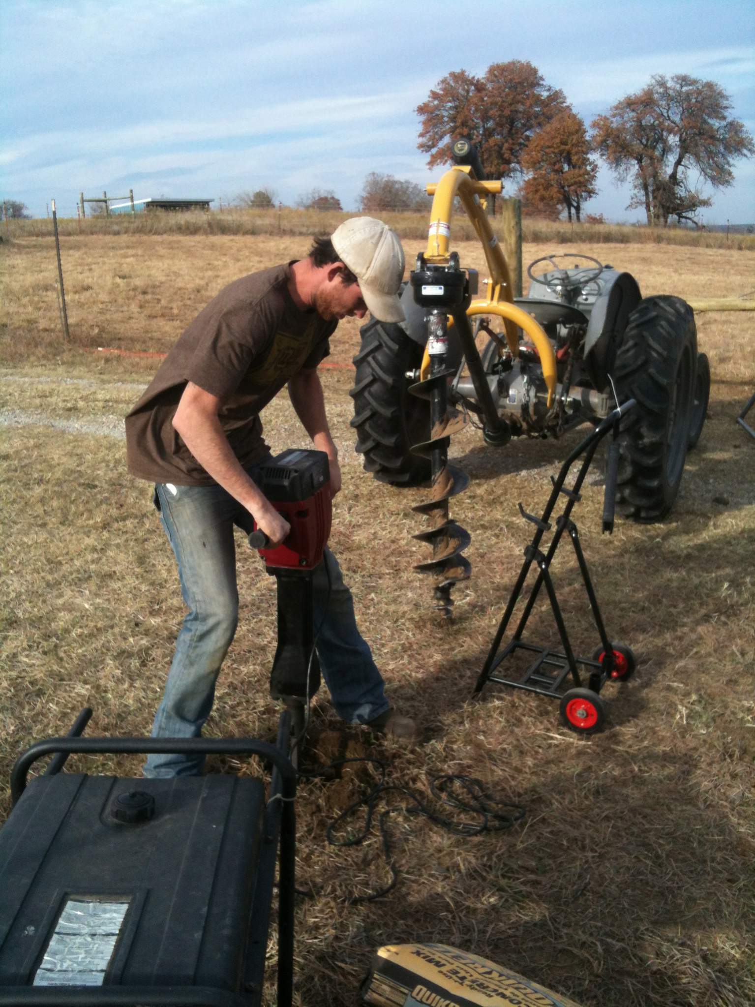

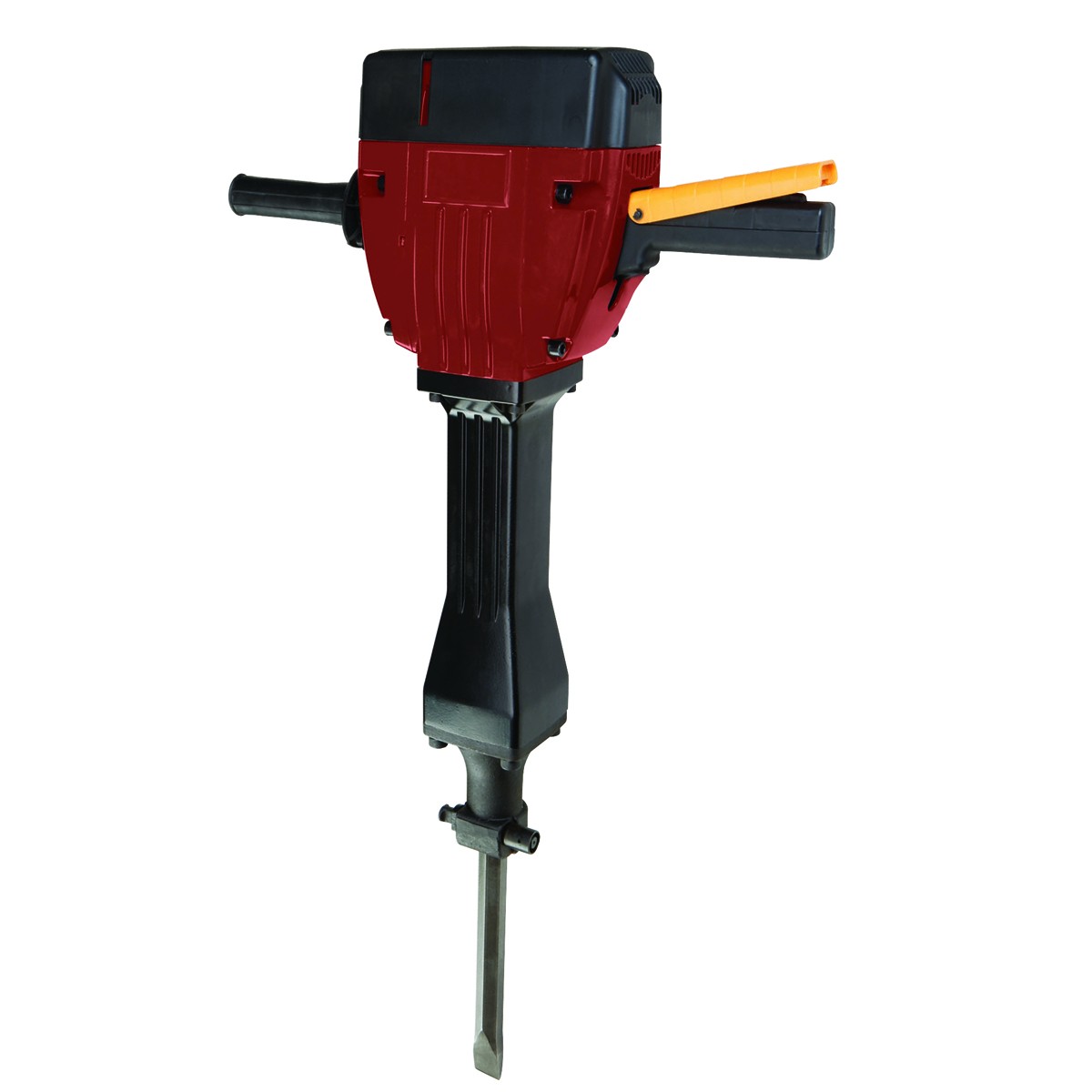

These 15 Amp, 120 Volt Professional Breaker Hammers from Harbor Freight get mixed reviews. We have used and abused ours breaking sandstone while building our fence. In some spots where it was 100' + of solid rock on the surface we even used it to drill pilot holes for T-Posts. It worked fine and when the spade on the post reaches the surface and you whack the post with a post driver it shears the stone and sets the post firmly. Granted it takes some serious effort to shear the stone but it worked for us. We also use it to break up stones that we would otherwise hit with the brush hog.
