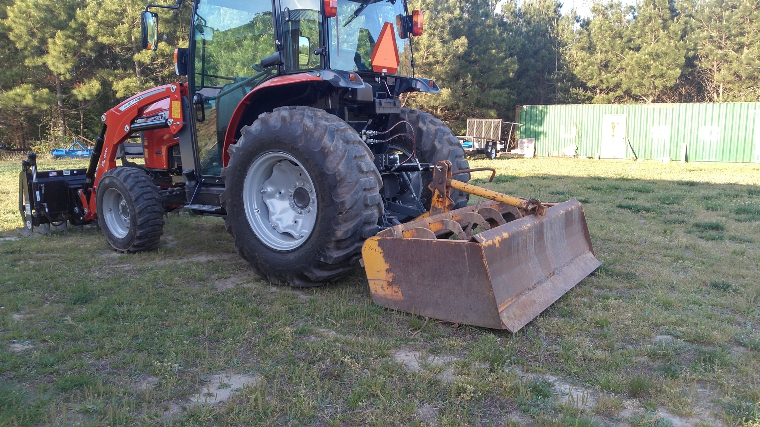

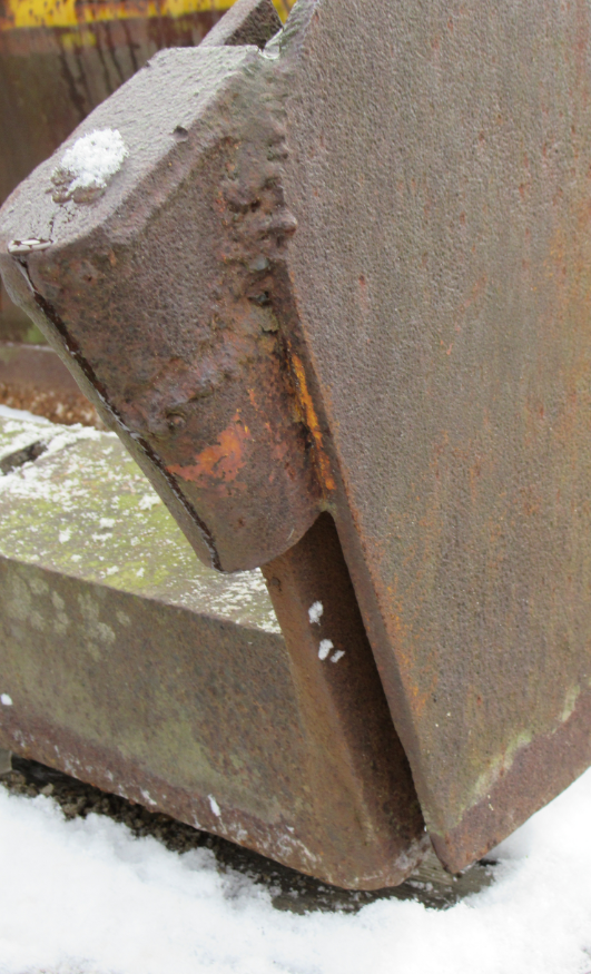

Hi all,
Would someone happen to know how to get these rippers moved to the cutting position? I keep trying to hold the handle and push the blades down but it feels like there is something hindering it. Also what feature is this called? Would it be considered a roll over box blade? I'm new to tractors and box blades so any help would greatly be appreciated Thank you

If I remember correctly, you hold the handle and drop the 3 PT. The tines will come partially down and into the ground slightly and back up until they lock into place. To roll them back up you just pull the handle with them raised and they will roll over. I had one of those that got caught up in my neighbors farm sale. He had borrowed them and forgot they were mine. I have looked for one ever since and never seen one for sale. Mine was exactly like yours. Best box blade I ever had.

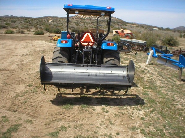

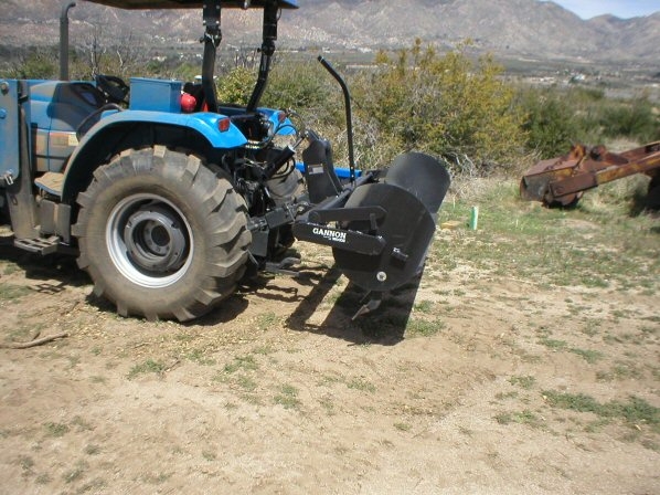

Just an FYI, this is a rollover box blade.

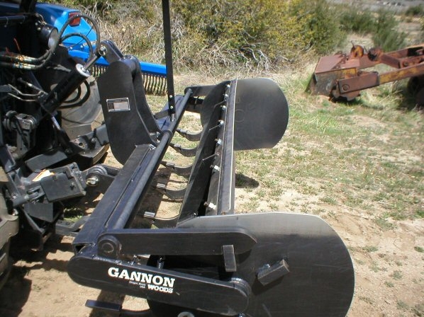

   / Gill box blade #4

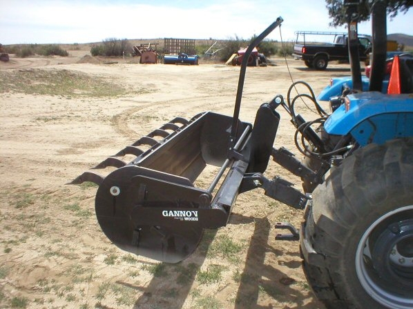

The one he has is a lot like the Gannon Box. The one he has would be super easy to convert to hydraulic.

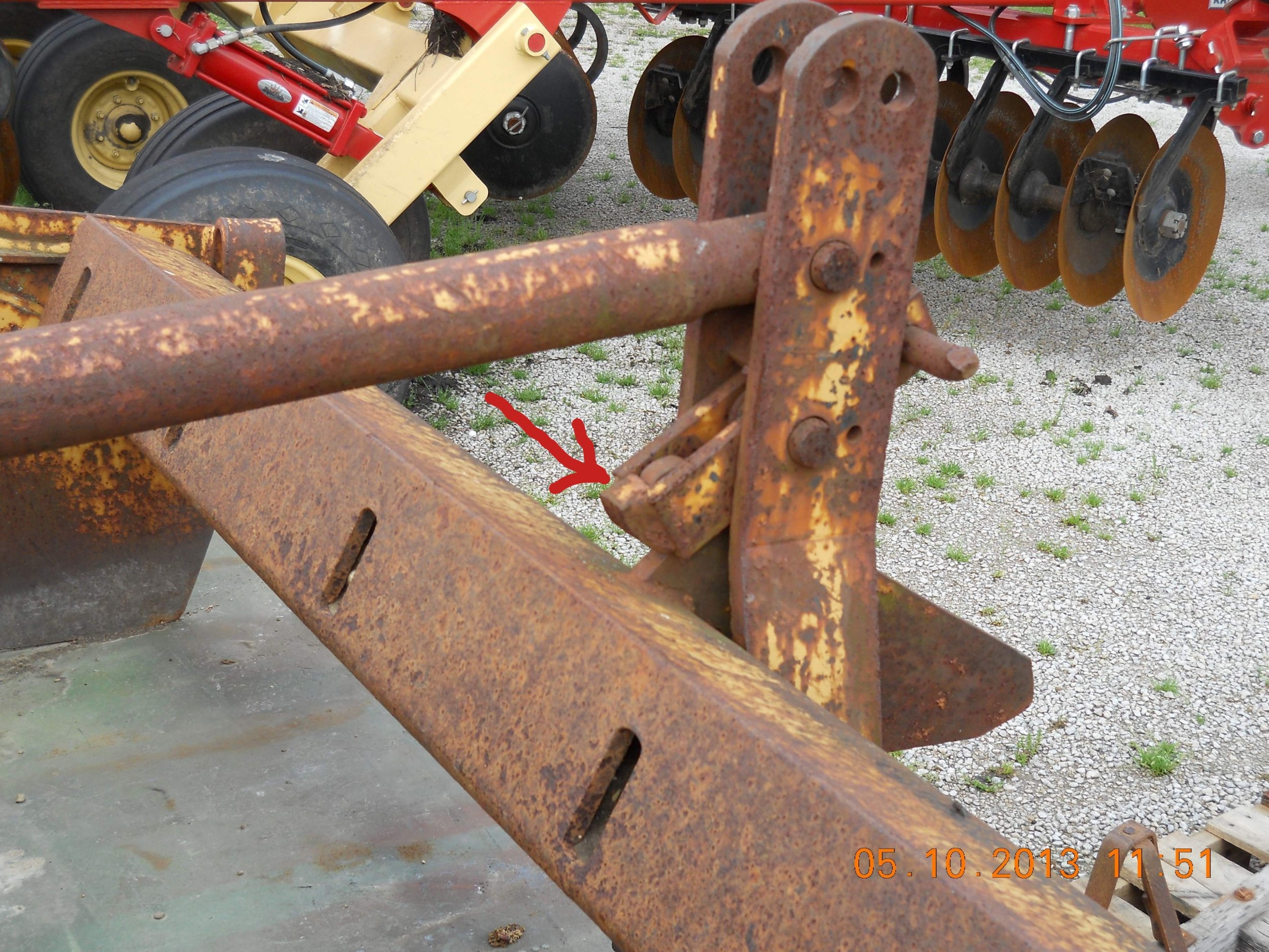

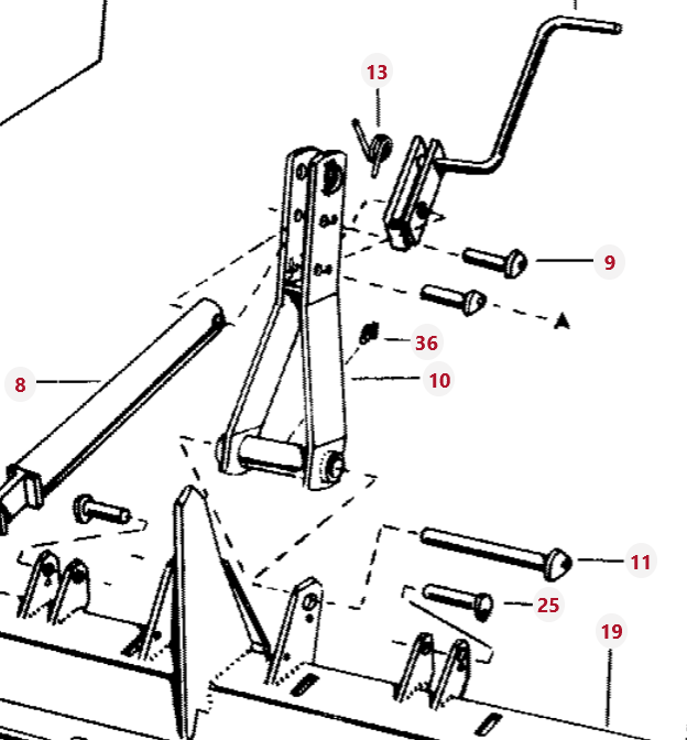

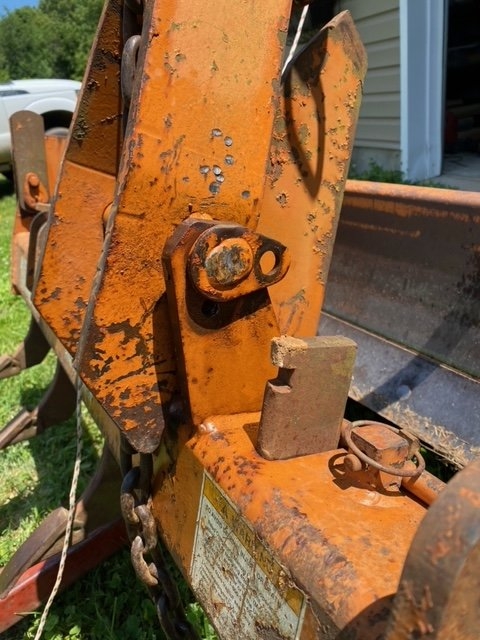

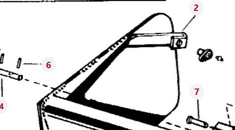

The gill box blade linkage is convoluted. I have a Massey Ferguson 18 that was made by Gill and had problems with the scarifier bar going down.
Below is a link to the Massey parts book. https://parts.agcocorp.com/us/en/apbsearch?q=masseyferguson/651212/l&name=MF+18+GRADING+SCRAPER
I would remove the shanks and detach from the tractor so its easier to move the scarifier bar by hand. I would then make sure that the pockets (item 2 on diagram below) on the sides of the bowl where the bar attaches are clean. If there is debris in there it could prevent the bar from swinging forward.
You can see in this photo how when the bar is down any dirt would inhibit its full rotation.
My problem was that the middle pivot pin was seized (item 11) The one end of the pin is bolted to the main beam (19). However it siezed in the mast (10) this essentially made them almost one piece. I would remove the bolt holding the pin in and see if it will rotate more.
If this does not work I would leave the bolt holding pin 11 in out and spray all the pivots with penetrating oil (not WD40 but something like liquid wrench) and come back the next day. I would then take a large sledge hammer and start working the bar up / down while spraying the pivots with oil. It will take time but you can free it up eventually. This is what I had to do (that and chip 100 lbs of concrete out of the bar to get the scarifier shanks in)

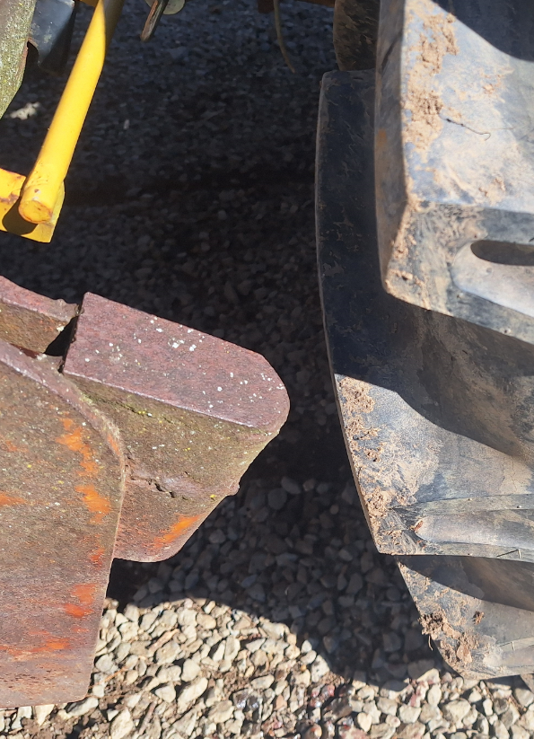

When you lift the blade do so slowly the first time. I have a Massey Ferguson 20C and the blade gets close to the tires.

Thank you for that detail Sportsman! My Tractor is the MF20 Industrial and yes the blade comes very close to the tires. I may pock your brain on other subjects involving the MF20 in the future if you don’t mind. I will probably end up taking the bar apart and giving it a good cleaning and putting back together. Thanks again!!

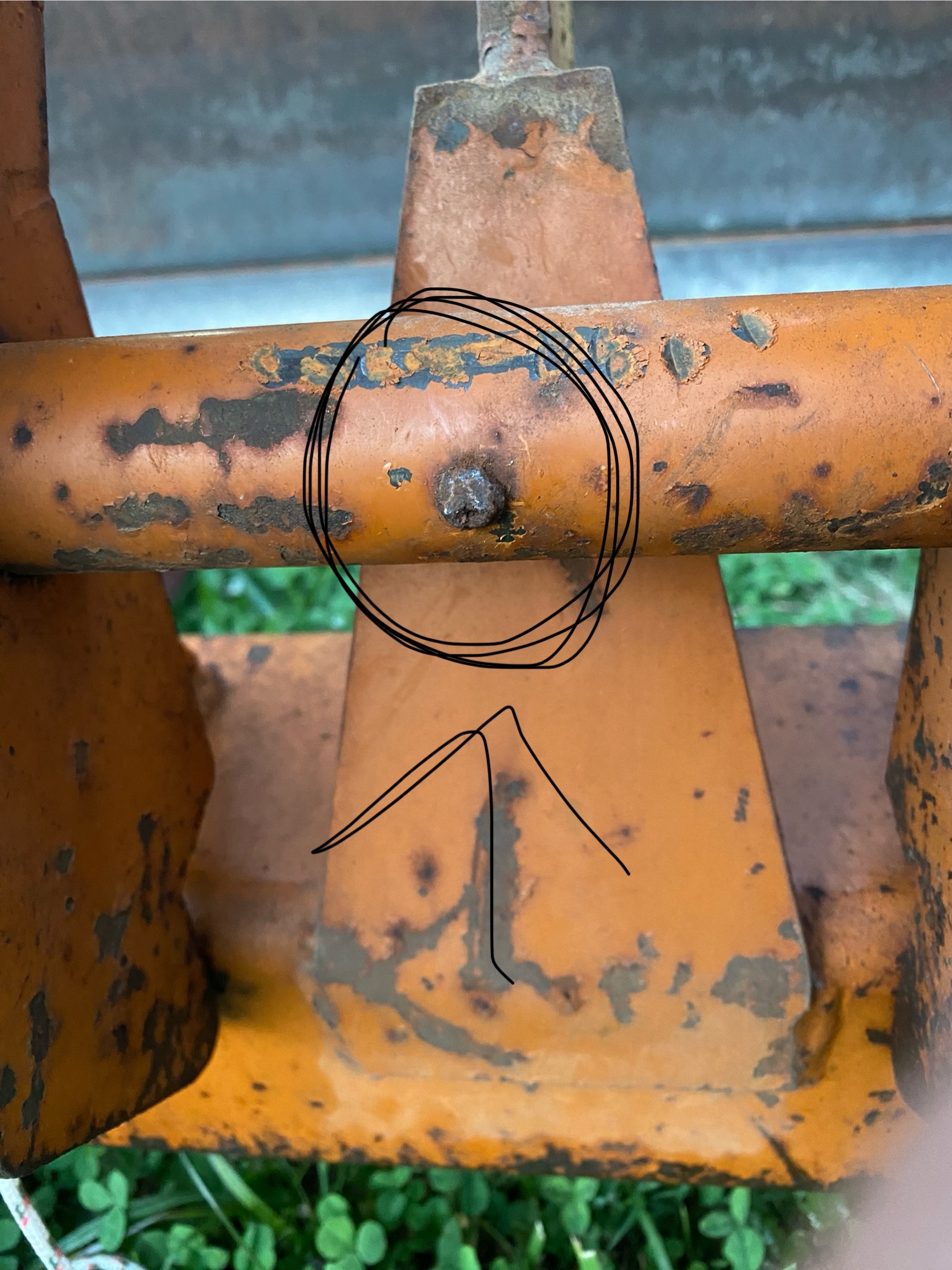

I’m guessing this is supposed to be a grease fitting?
