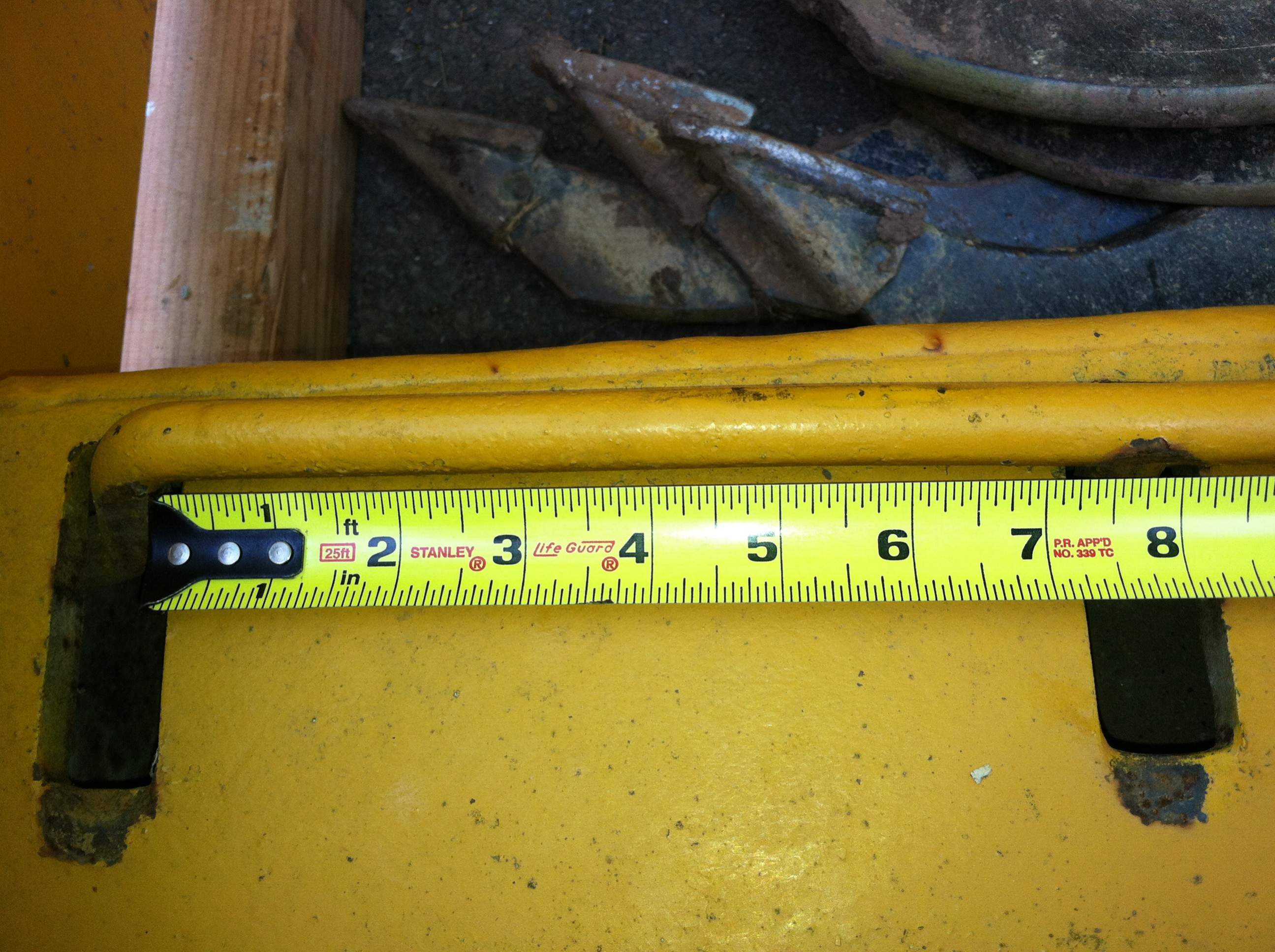

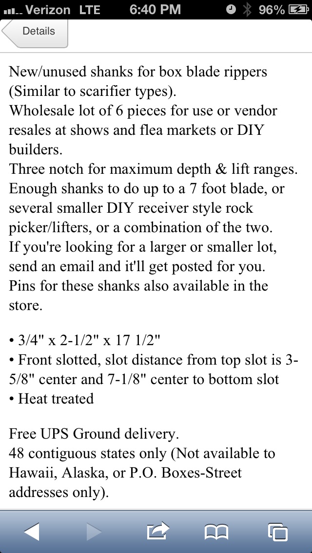

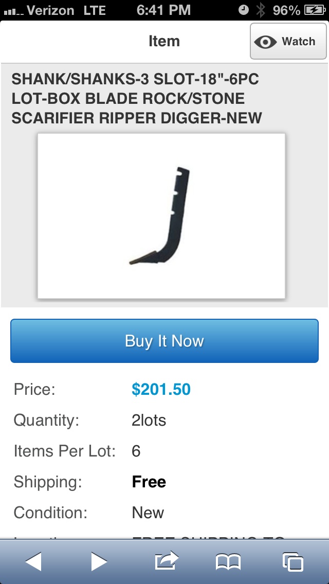

Obeone, can you tell me the spacing between the slots in the scarifiers? 3 5/8", 7 1/8" total (3 slots). Those are the measurements from a eBay seller. Woods doesn't give the specs on the spacing. I don't want to buy the wrong ones.
Not sure what u mean, but I have 4 slots on each side for a total of 8 scarifiers, do want the distance between the slots?
   / Gill SR 25
#13
   / Gill SR 25 #14

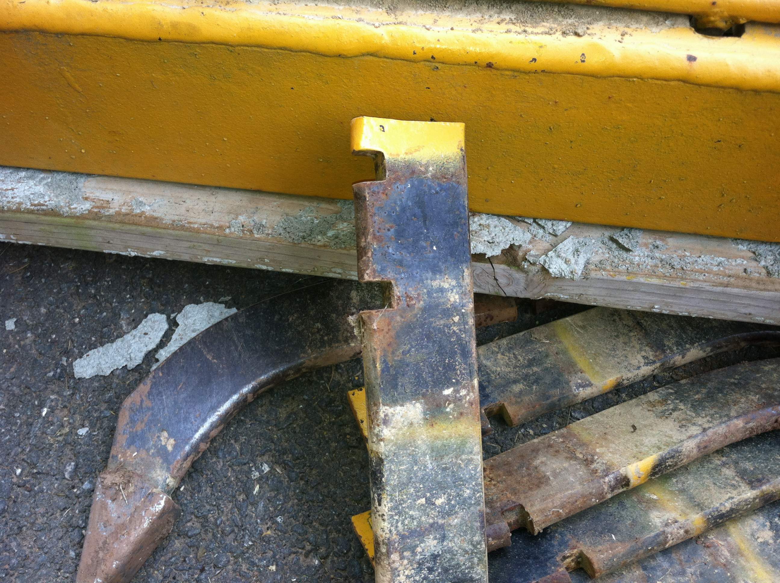

I'm sorry. I talking about the actual scarifier shanks. The indentations on the front part of the shanks. Do the shanks only get held by indentation on the top side of the frame of the box blade (where the rod and steel shim hold it tight. If that's so, then the scarifier is leaning slightly backwards as it goes thru the square tub, resting on the backside of the tube as it exits it towards the ground.
   / Gill SR 25 #15
The measurements I gave you were from an ebay seller. It was the distance between each indentation on the front part of the scarifier. If it only uses one (the one resting against the top of the square tube, the the spacing doesn't matter. But if it had to be held in two spots the the spacing would have to match up with the thickness of the scarifier tube. Sorry to be a pain in the butt!
   / Gill SR 25 #17

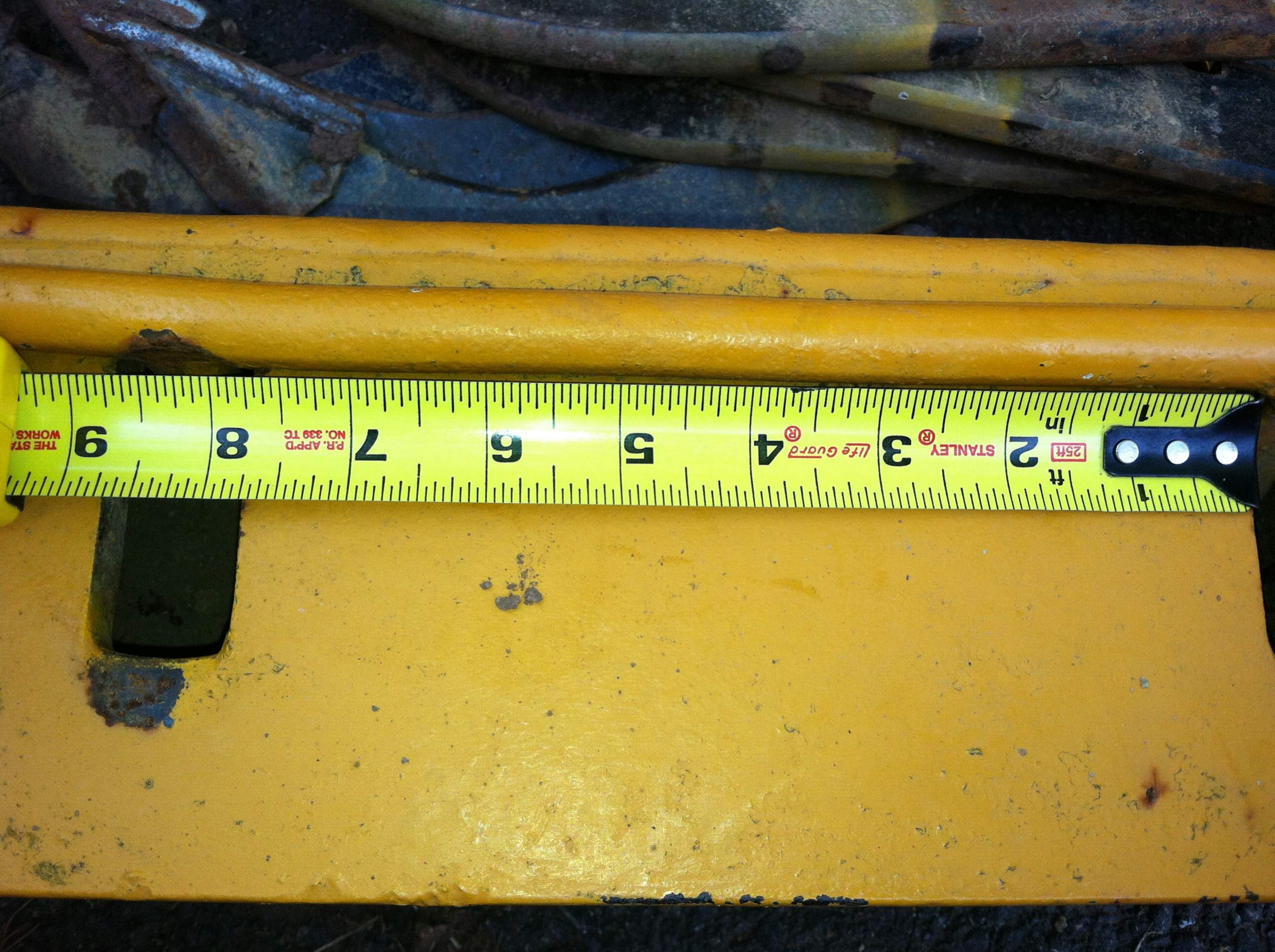

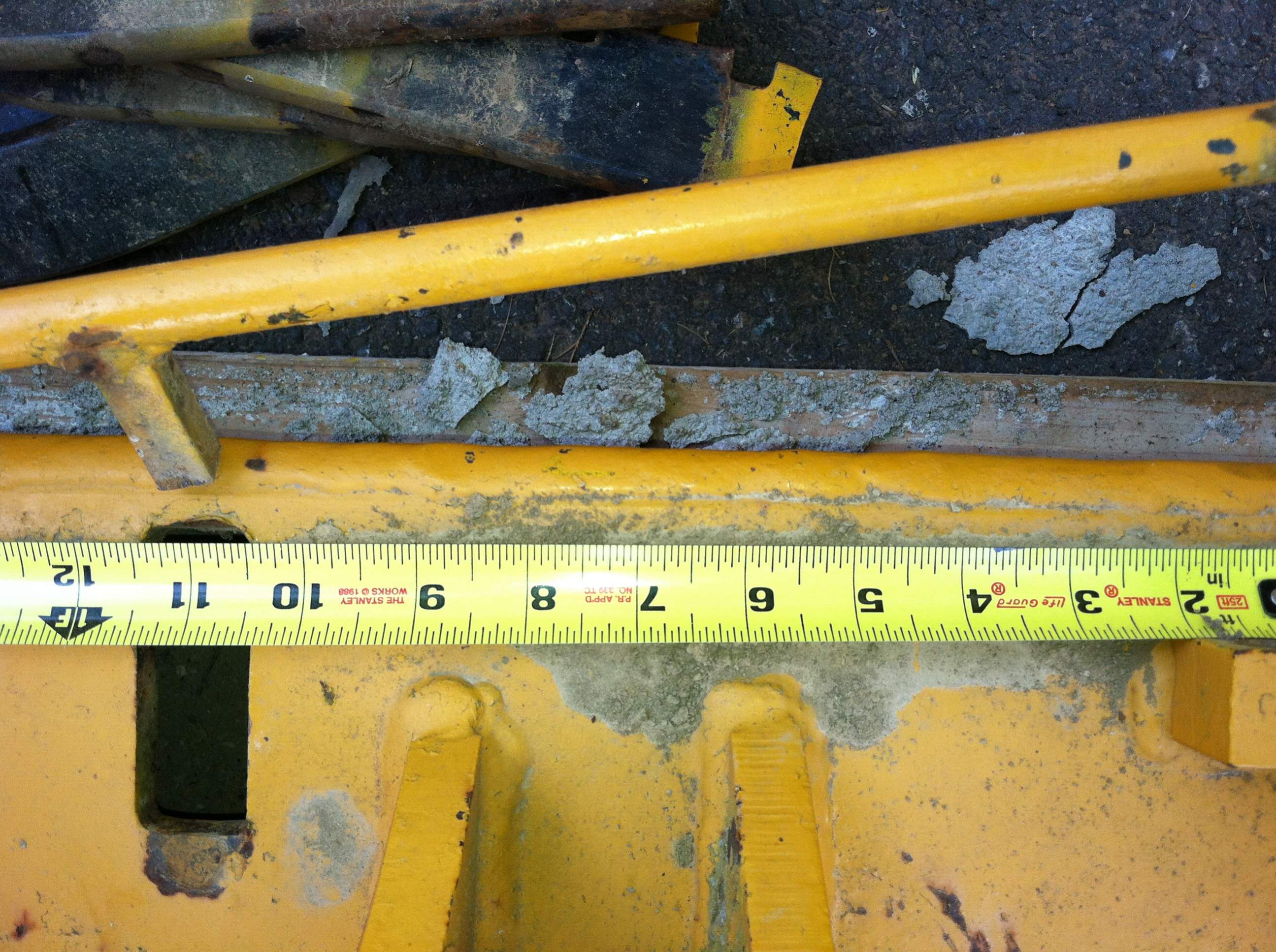

Here is a picture of the shanks with the dimensions.
