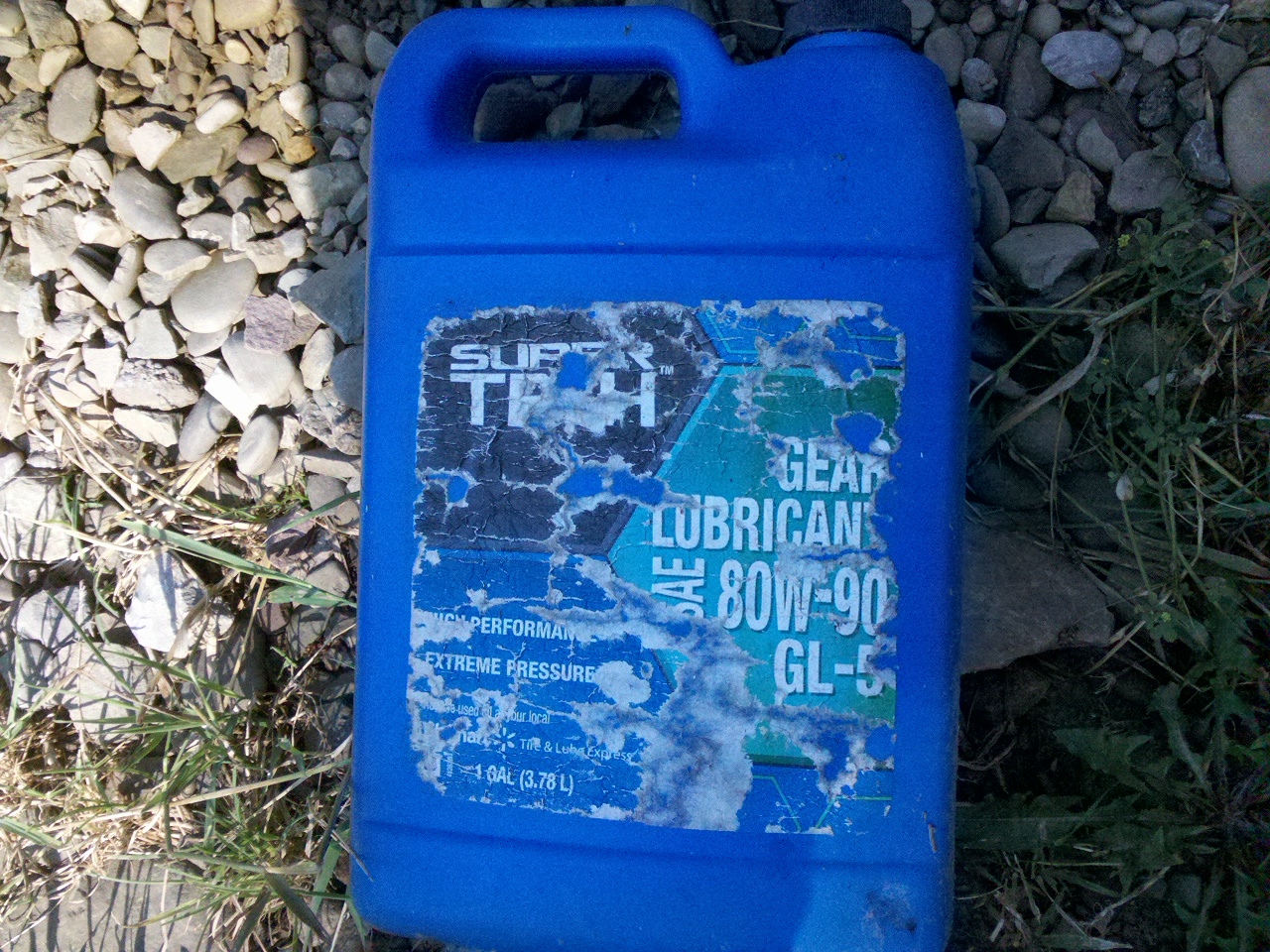

I have decided to go with gear oil in my front axel but not sure if I need to spend the extra money on synthetic oil or not. My feeling is regular 80w 90 gear oil would serve my purpose, please give me reasons that I should not go with that, btw I typically do not use 4wd if that makes any difference. Thanks
   / GL 3940 front axel oil change #2
I have a grand L 3130 and I changed my fluid to 80-90w I bought at tractor supply. I think mine took 5 quarts or so. Works for me.
