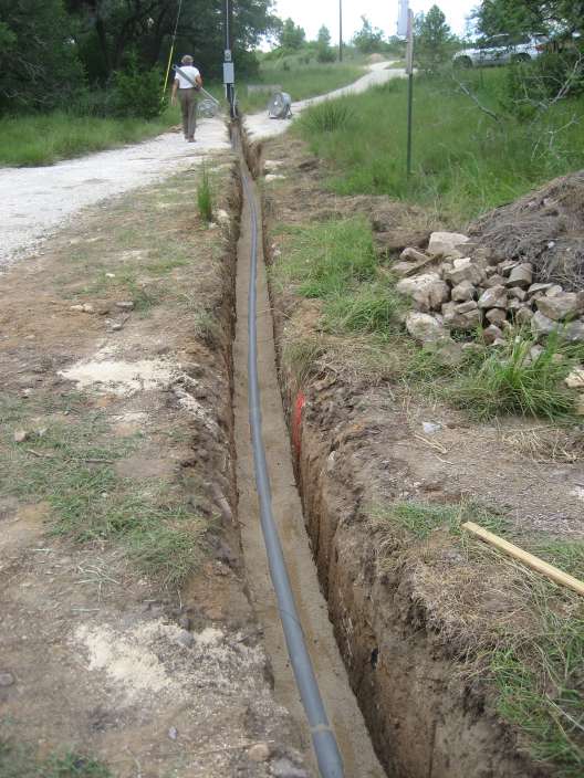

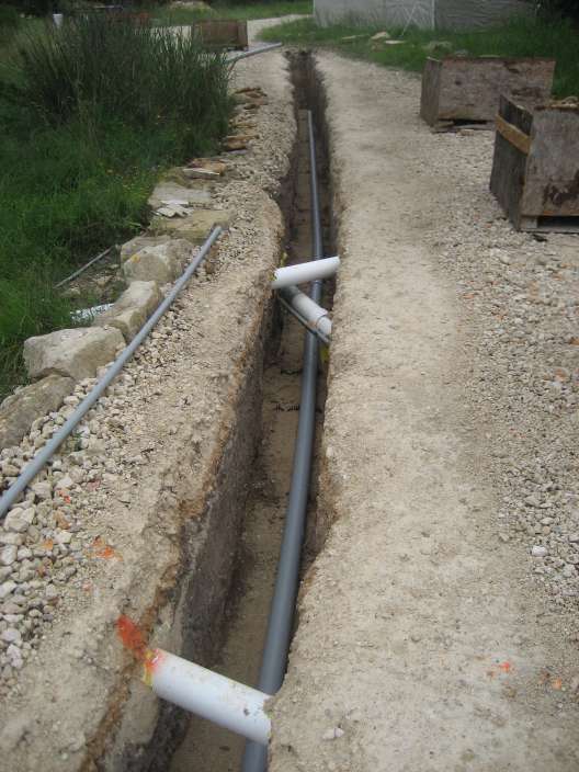

I took a lot of pictures documenting the recent under ground electrical service project but none of them have the 3240 in them :(
Here are two pictures that show how I dug the trench. The 1st pic shows the section where the trench went below the septic and several drainage lines. The 2nd pic shows the 100' nearest the utility pole. These pics were taken as I was installing the 3" sch 40 PVC conduit, set on 3" high "chairs", bedded in sand that the utility co will use to pull the primary from the utility pole to the surface mounted transformer (AKA big green box).
You may be wondering where the 60+ tons of spoils went :) Since I knew that the utility co would require me to use manufactured sand for the fill, I hauled off all of the spoils in 42" square pallets with 2' high sides to the future house site where we needed high quality fill anyway. These pallets are visible in the 1st pic. My pallet fork has 1" holes burned 6" back from the tips of BOTH tines. I installed bolts that stuck up far enough that I could lift a full pallet 8.5' in the air and dump it like a bucket. It turned out that I could fill roughly two pallets for every back-hoe setup. So it became pretty routine to load two pallets with the back-hoe and then dump the pallets before repositioning the tractor.

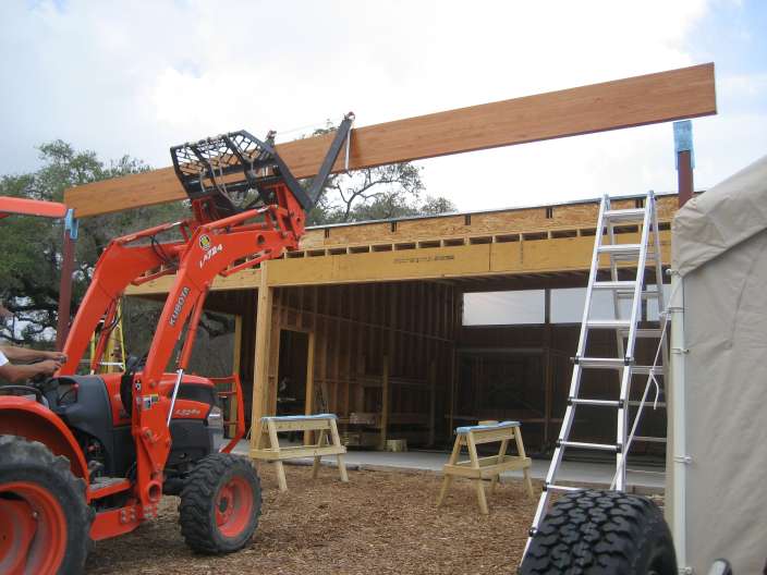

During the construction of the 3 bay garage last year, the GL3240 was used mainly for lifting with the pallet fork. I kept the BH90 back-hoe on for balance.
A lot of the lifts were done with a tow strap attached to shackles though the 1" holes in the tips of the fork. In the 1st pic I'm loading the 24'long 16"x3.5" southern pine GLULAM onto horses for sanding, staining, and urethaning. The 2nd pic show the GLULAM being lifted into the metal saddles (covered with blue padding). For scale: the bottom of the saddles are over 9' above ground level and that is a COSCO 22ft adjustable ladder.
BTW Positioning a GLULAM into saddles (only 3/8" wider than the GLULAM thickness) at over 9 ft in the air, is when you really appreciate the fine control you get with an HST Plus. We set this GLULAM with only 3 people. Me on the tractor, a helper on the ladders and my wife on the ground sighting in the alignment (AKA calling the shots).

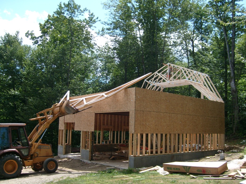

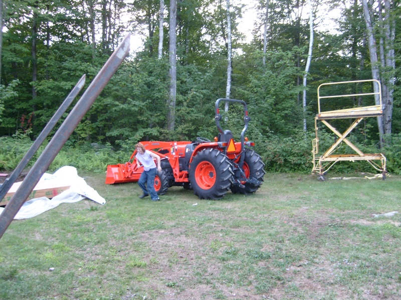

Here's my trusses going up and a second one of an old air force lift to work on jet engines that I lift with forks to work off of.
