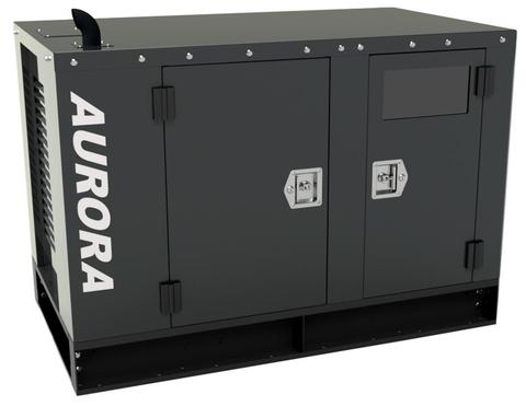

No NG I was looking at these also
20,000 Watt Diesel Generator | 1P | 120/240
SKU # AGi20P.1.240.e
$ 11,110.00 USD
$ 13,619.00 CAN
6 reviews
Quantity
20,000 Watt Diesel Generator Enclosed Diesel_Generator_f8d30a5b-de35-4228-94f3-a60d9d30869e_large.jpeg
