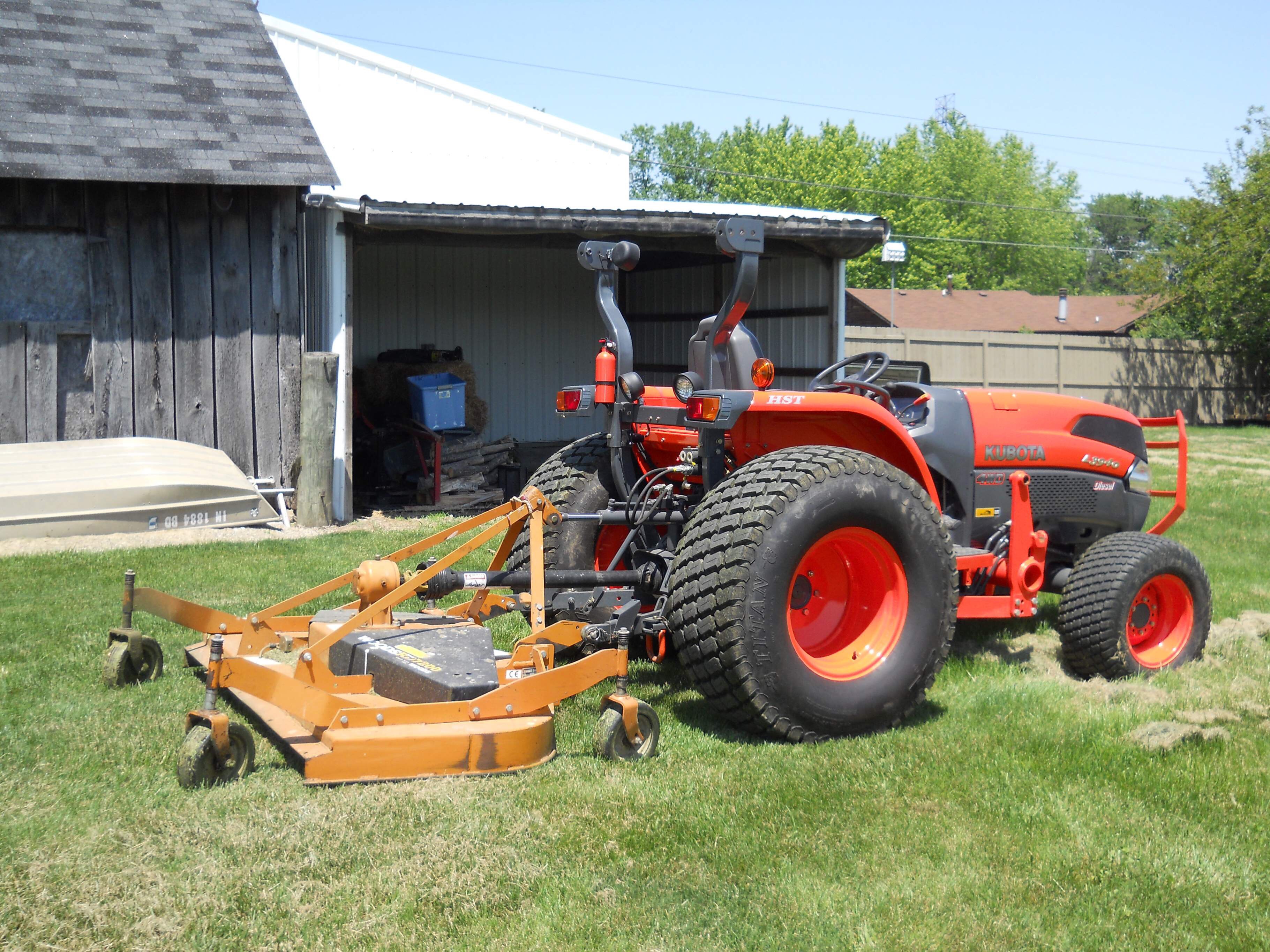

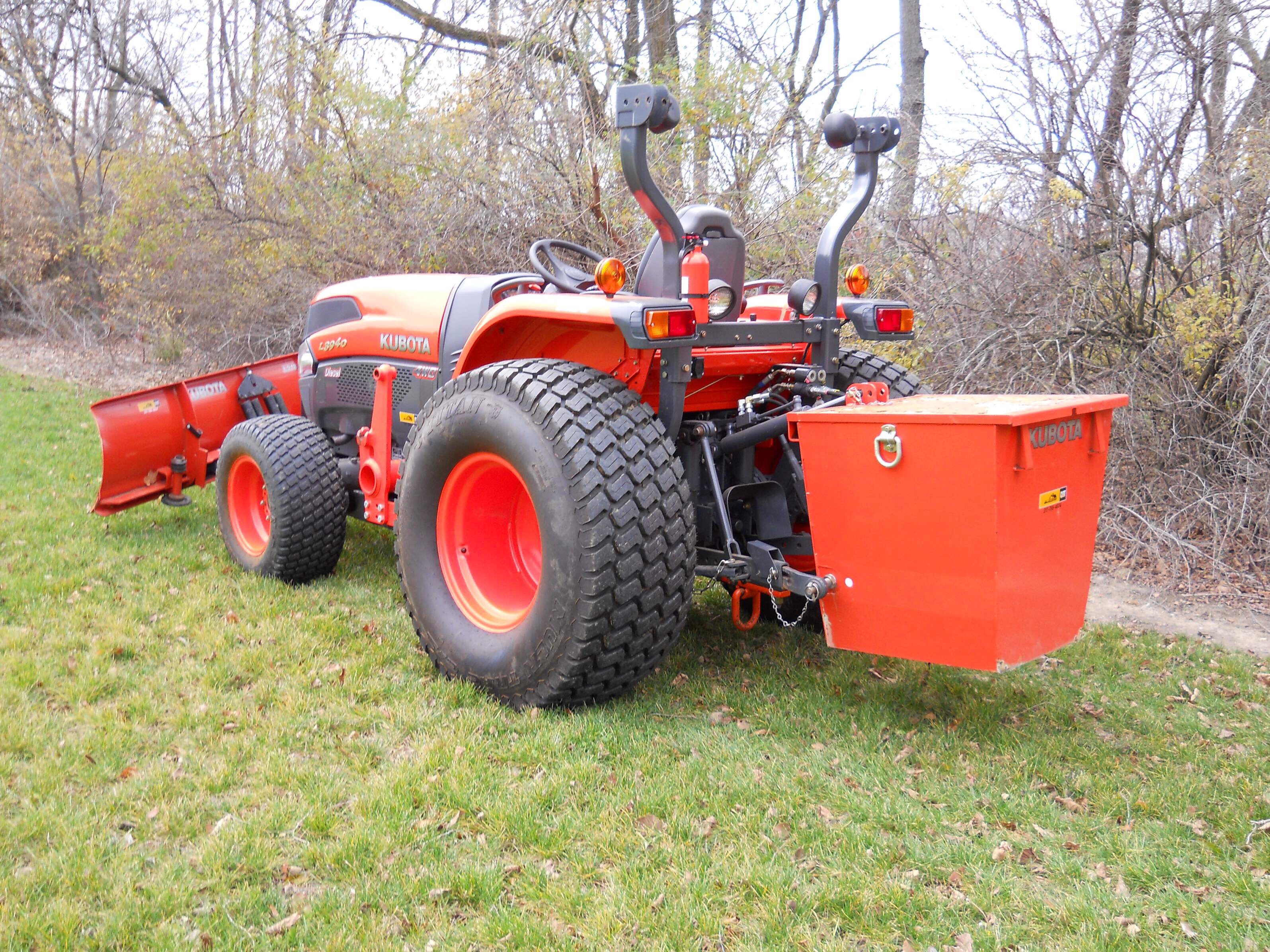

If I was ordering a tractor I would get these tires:
Titan multi trac.
In fact I think I might shed my R4s and price some for my tractor. So far I'm not a fan of R4s, I don't feel there traction would be any better than Titan turfs in mud and they suck in snow where Turfs would excel.
Most of what I'm rolling on is pasture and lawn, if it rains at all my R4s mark up both so most the time I go out of my way to keep the tractor in the barn if it's even slightly wet out.
View attachment 506853View attachment 506854
Titan multi trac.
I dont have snow, and I dont have lawn, but i was thinking the extra width and lower center of gravity would help some when i go on my hill sides, but thatll only be once in a while...so still undecided...maybe Ag's arnt a bad idea..

No snow and no lawn kinda defeats the need for R3s, if your rolling on lots of hard surfaces R4s will hold up better, if you mostly on dirt and you don't mind washboard tracks I would go with R1s.
Here's more info on tires.
They make R1, R1w, R2, R3, and R4 tires, but Kubota only offers R1, R3 and R4 I believe
