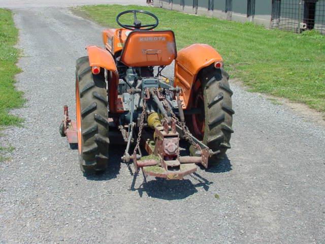

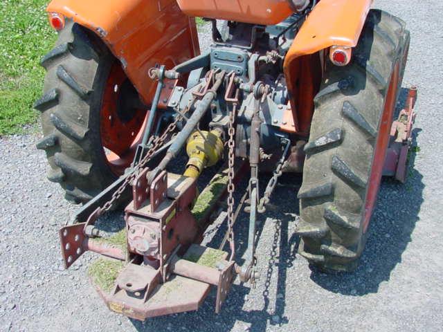

Ric,
What exactly is hooked up to the rear PTO?
It's a good size gearbox but nothing underneath it.../w3tcompact/icons/shocked.gif

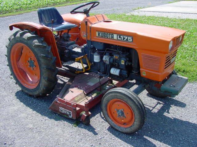

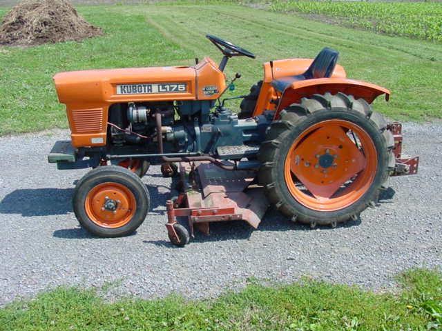

/ glow plug indicator
#23
John, The pto drives the gear box. Under the gear box is a large pulley that drives the belt that goes forward to the main pulley on the mower deck that drives the three blades under the deck. Great mower, mows the yard like carpet. ric

i also have a l245dt and my glow plug use to be bright enough that i could see it in the daylight but not any more have you found anything out about yours?
and do you know anything about the front spline on the front of the motor what is is used for?
and another ? i hane the trailer hitch bar but i cant seam to figure out how it mounts to the rear of the troctor i know it slides between the rear plats and somehow it pins under the rear end but not sure what kind of pin or how it hooks.

BKY, The front shaft is an alternate pto drive for attachments with their own controls such as a mid mount mower using an electric or cable activated clutch to run the mower. L Series front loaders also use this shaft to drive a front mounted pump to operate the FEL instaed of using the rear pump. These are the only two attachments I have seen that use this front shaft, I'd bet there are others. Still working on the glow plug indicator issue. On my 245 the hitch bar has short pin that drops through the bar and the mount to hold the bar in place. There does not appear to be a forward mount or attachment point for the bar under the tractor like you see on Utility or Ag tractors. The snug fit in the mount and the pin hold this in place fairly well. I don't use this for anything I use a drag bar with an arm lock to tow with allowing me to use the 3PT hitch to manage the load. Hope this helps, ric
