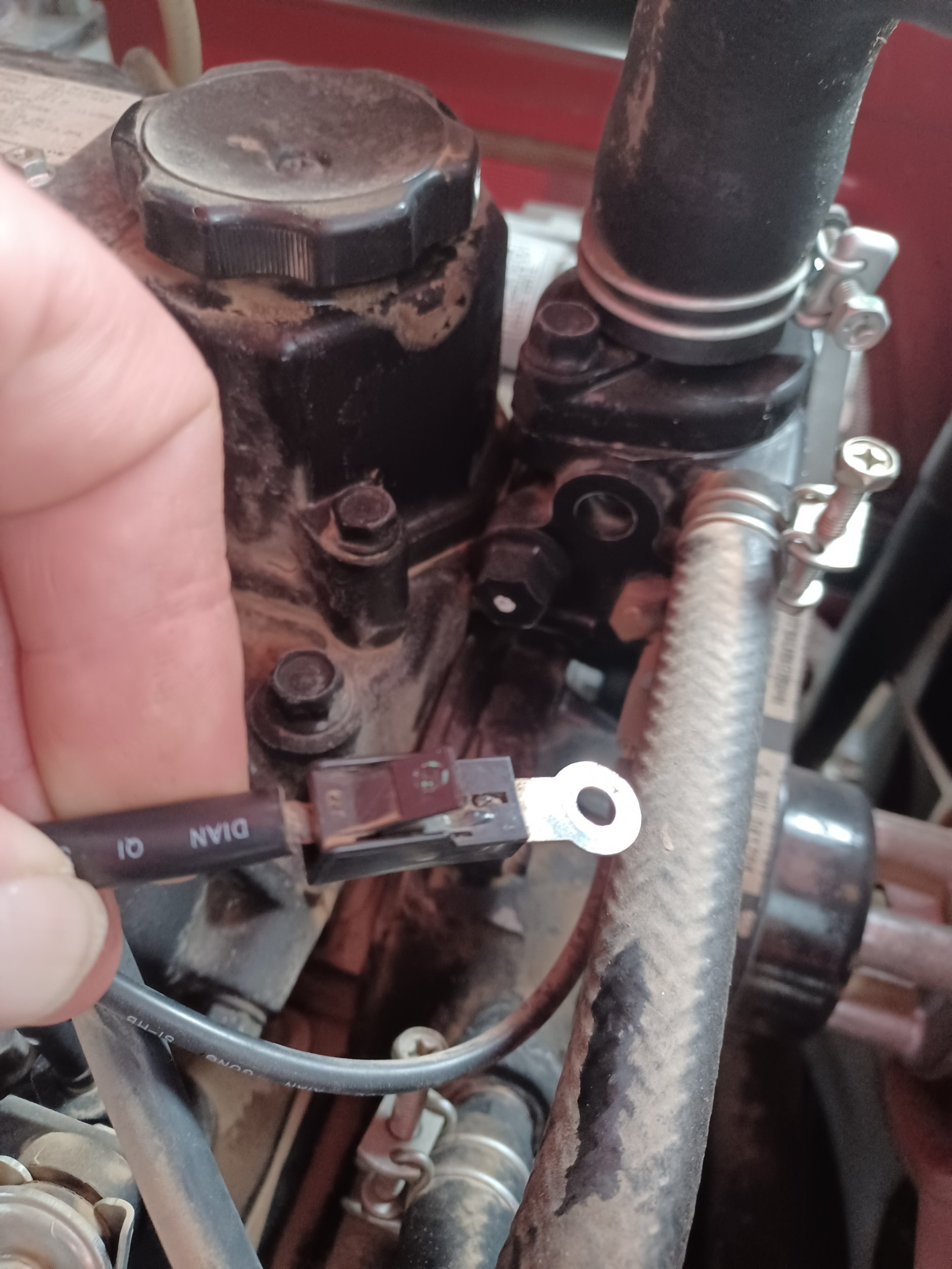

There is a fuseable link that is attached to the glow plug bar, mine was on the first plug. Mine had intermittent power to the bar. There is a tab to unlock it and it wouldn't come off. After removing it from the post on the first plug, i would gat a hot reading with a test light and if it moved the light would go out. Its hard to see in the pic, but there was a little bit of melting on the plug/link. I replaced the fuseable link and she fired right up. It was $5 at the auto parts store
Mine is a 1526 but same issue. it was getting harder to start blowing white smoke and then it wouldn't start at all
