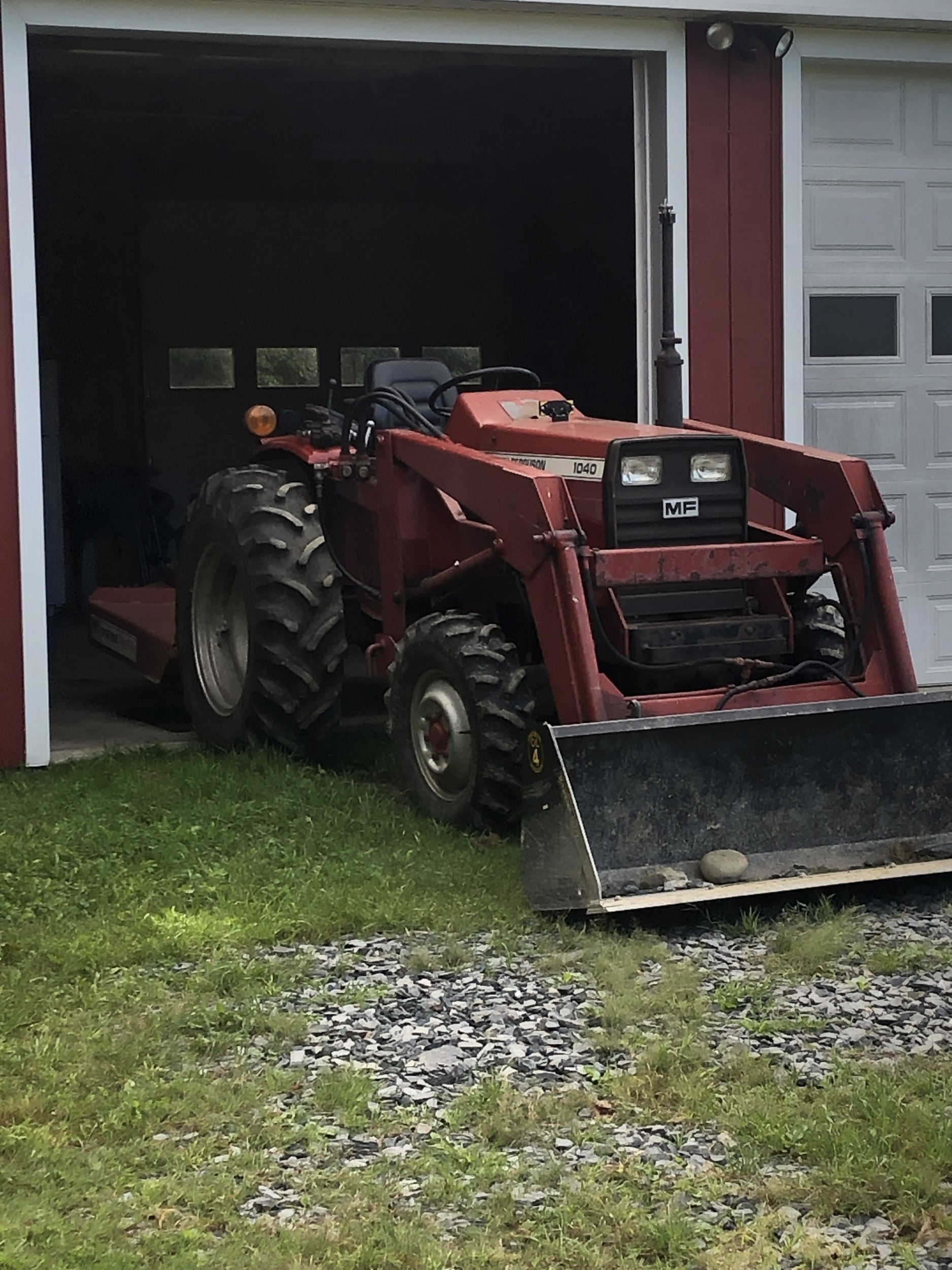

How often do you all have to change your GP's?
Good Afternoon fidowanttobe,
I have a 1986 Massey Ferguson MF1040, about 2000 hours, still have the original GP's ! If its cold I have to have the plugs on for 30 seconds, if its warm its much shorter ! Tractor still runs great !
