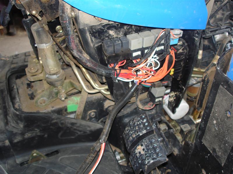

I have a 4 year old TC29D New Holland.The glow plug lite comes on after it's been running for a few minutes and flickers and sometimes stays on solid.Does anybody have any pictures of the glow plug and the timer relay and where exactly are they located on this tractor. Thanks for any help that's offered.Also,will it hurt anything to run it this way?

Steve our 40D had the same symptom until we replaced the timer. In our case the lower cowling needed to be removed to access the timer. It's about the size of a Zippo lighter.
I personally unplugged the defective timer until a replacement could be found. Didn't want to chance burning up a glow-plug

I copied these pictures from a post, which Maxfior made on (9-6-07). His tractor was a TC34DA, mine is a TC33D and the locations are very similar. The timer is located on the far right side, it has the blue colored label and white connector which plugs into it's side near the top. I don't specifically remember which one of the relays to the left of the timer was associated with the glow plugs. Hope this starts to point you in the right direction.

Yesterday I replaced the glow plug timer relay and that took care of my problem with the glow plug lite coming on and staying on. Thanks to all for the helpful info and pictures.This is a great web site.

Did the new timer have the gold colored label rather than the blue one?

The label on the new one was the same as the old one,blue.It was an identical part.The label on the relay says lamptimer DC12V. Thanks again everybody!
