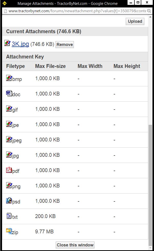

Yes, I tried multiple times, first after I picked three pictures, then after each individual picture, --- Now I am wondering if---as some other forums do--- will Not Let Newbies(2 Days 4 Me) post pictures until my acct is approved by website Administrator ??? --- anybody heard of this before ??

   / Glow plug troubleshooting #24
I believe there is a size limit to each picture. I don't know off hand what that is. Have you tried reducing their size before attempting to up load?

   / Glow plug troubleshooting #26
For computer users it is 1MB:
James is right, you can post pictures right away.
Are you using a smart phone?
And on Tapatalk? Tapatalk enabled.
