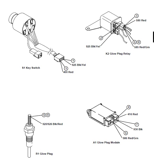

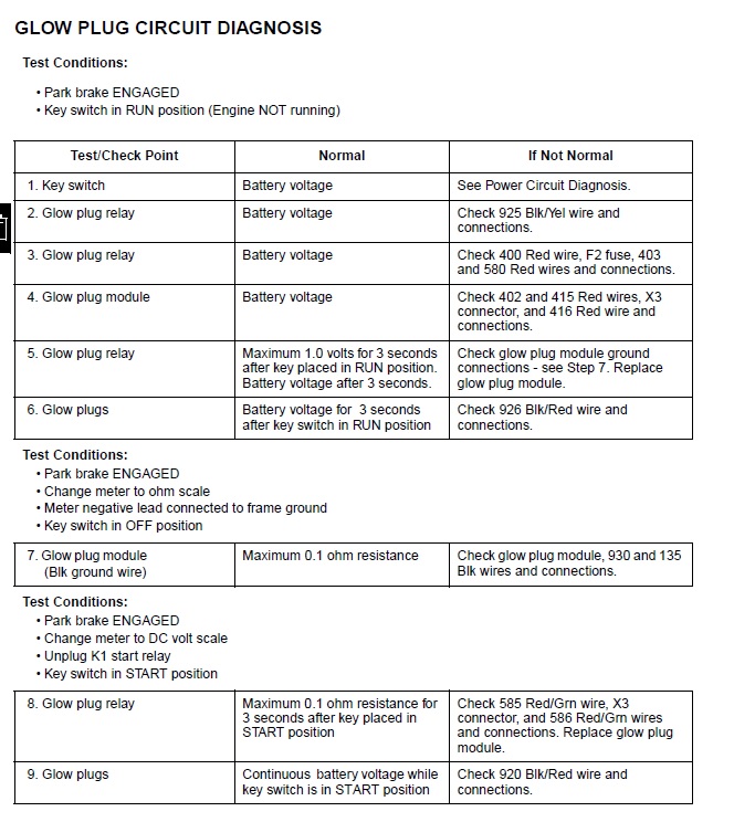

Here is a section I found on the 4100, in the service tech manual. Maybe help you track it down...
   / Glow plugs no power #13
Use diagrams to track voltage to/at relay and passing through rest of circuit. Determine where power drops off. Again verify any fuses in circuit both visually and with ohm reading across the actual fuse- removed from it's holder.
