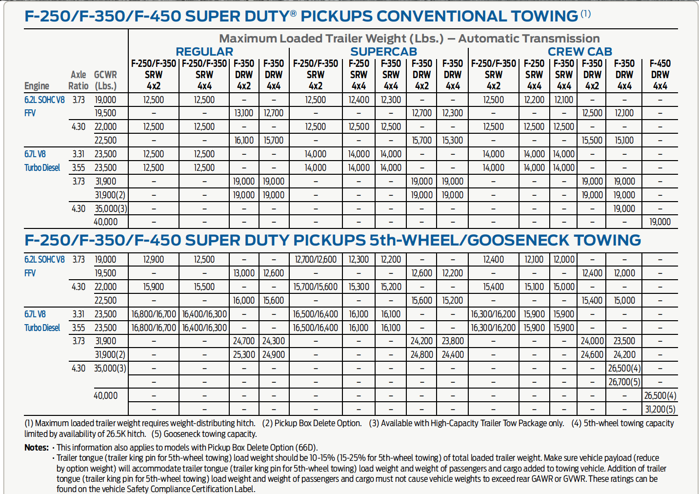

Not a data tag but still data
   / Gm 3500 towing #37
<img src="http://www.tractorbynet.com/forums/files/trailers-transportation/389967-gm-3500-towing-screen-shot-2014-09-10-a"/> Not a data tag but still data
Why is the tow rating for a 5th-wheel trailer so much lower than a gooseneck?
   / Gm 3500 towing #38
Not sure where you see that, though I see a couple places that seem to show 100# more for fifth wheel... maybe I am reading it wrong.
   / Gm 3500 towing #39
Very bottom right hand side of the chart I posted. F-450 with the biggest motor
