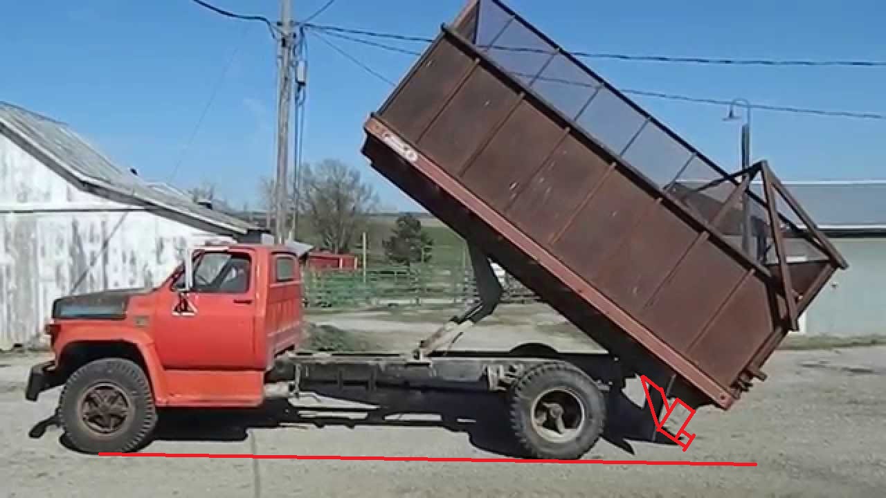

I just bought an old GMC 6500. It has a 366 (or maybe a 427 how do I tell the difference) v-8, 5 speed with 2 speed rear, 16' silage body. It was an old fire truck, has under 25000 miles on it and is as clean as your gonna see around here, with the salt and such. The guy I bought it from says he hauled 6-8 tons of grass to a load, which is great for what I want. My question is this, I would like to also haul 800 lb. 4x5 round bales with it along with a 12k equipment trailer I have. I figure I can get 19 bales on truck and trailer, compared to 10-12 on my 1 ton with same trailer. What do you all think, good idea? or just stick with the silage and 1 ton for hay? My problem is always drivers, I figure with the big truck I can cut my trips in half and not deal with helpers. Plus I think it will do the truck good to be used a little more, setting is worse than running at some point. My next issue will be adding a hitch, the body hangs out about 3-4' beyond the frame, not sure what the hitch will look like and still clear the body when it dumps. Any pics or ideas would be appreciated.

Last Year I put 1700 miles on my one ton, fuel mileage will not be a major concern. It takes a lot of trips at 5 miles to a trip to run up mileage. I am thinking something like the wheel lift on a heavy wrecker, maybe 4" square tubing like an oversized receiver hitch.

I'd build the hitch off of the dump body frame ... think along the lines of a reinforced drop step bumper at the rear of the dump body, obviously not so low that it hits when dumping.
like this ... please excuse the crude drawing.
   / GMC 6500 Meduim Duty Truck #9
I think, legally you should build the hitch off the frame of the truck and get a longer tongue on the trailer. It is either that or shorten the box, then build the hitch.
   / GMC 6500 Meduim Duty Truck #10
Can you make a separate hitch frame that slides in and out, being pinned in either position? Would take some exact welding, though. Thinking that you would slide it out fro trailer use, and slide it in for dump use. Just a thought. Jon
