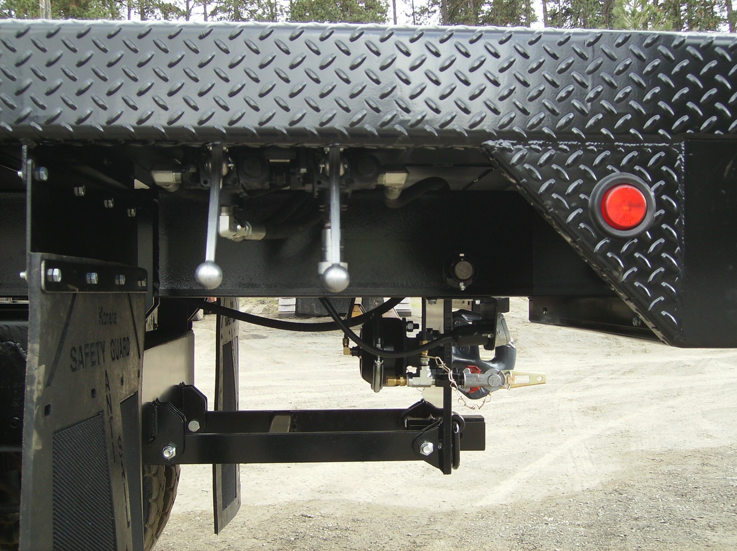

What happens when you want to haul the trailer with the bed empty? I don't think this is such a good idea. Weld the hitch to the frame or dont do it.
   / GMC 6500 Meduim Duty Truck #12
I agree 100%. Most dump beds are just U Bolted to the trucks frame.
   / GMC 6500 Meduim Duty Truck #13
transport lock tied into the dump control.
   / GMC 6500 Meduim Duty Truck #14
Here's one that pivots with the dump bed.
