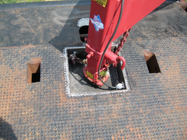

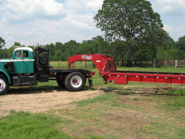

I had a gooseneck hitch installed in the winch bed of my '59 White. The hitch on the trailer adjusts about 6 inches up and down so I can use it on either the White or my F-450. A 4x4 medium duty will be significantly taller than a non-lifted pickup but probably close to a lifted 4x4 pickup.
