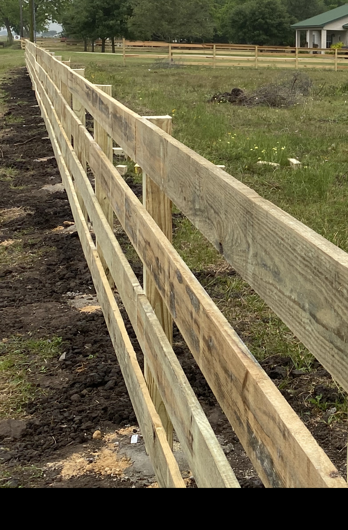

We’re building a 4 board corral board fence to replace field fence & barb wire sections & was considering getting some goats. It’s roughly 53” tall with a corral board running flat on top.
We’re interested to see what it would take to keep them in? I’ve seen where a few runs of hot wire will help. The board spacing we have is roughly 6”-7” between the 2. Will they get out or hung up in that?
We also have barbed wire on the back side of the property that we’d have to address. I was thinking a few runs of hot wire there too?
/ Goat fencing #2
What size goats are you looking at getting? we had pygmy goats for years and the younger/skinnier ones could squeeze out of a fence like that.
I would put one strand at about 7" off of the ground and another about in the middle of the gap between the first two rails.
If you have tall goats, you may also want another hot wire at the very top (perhaps even on standoffs so that it sticks into the pasture).

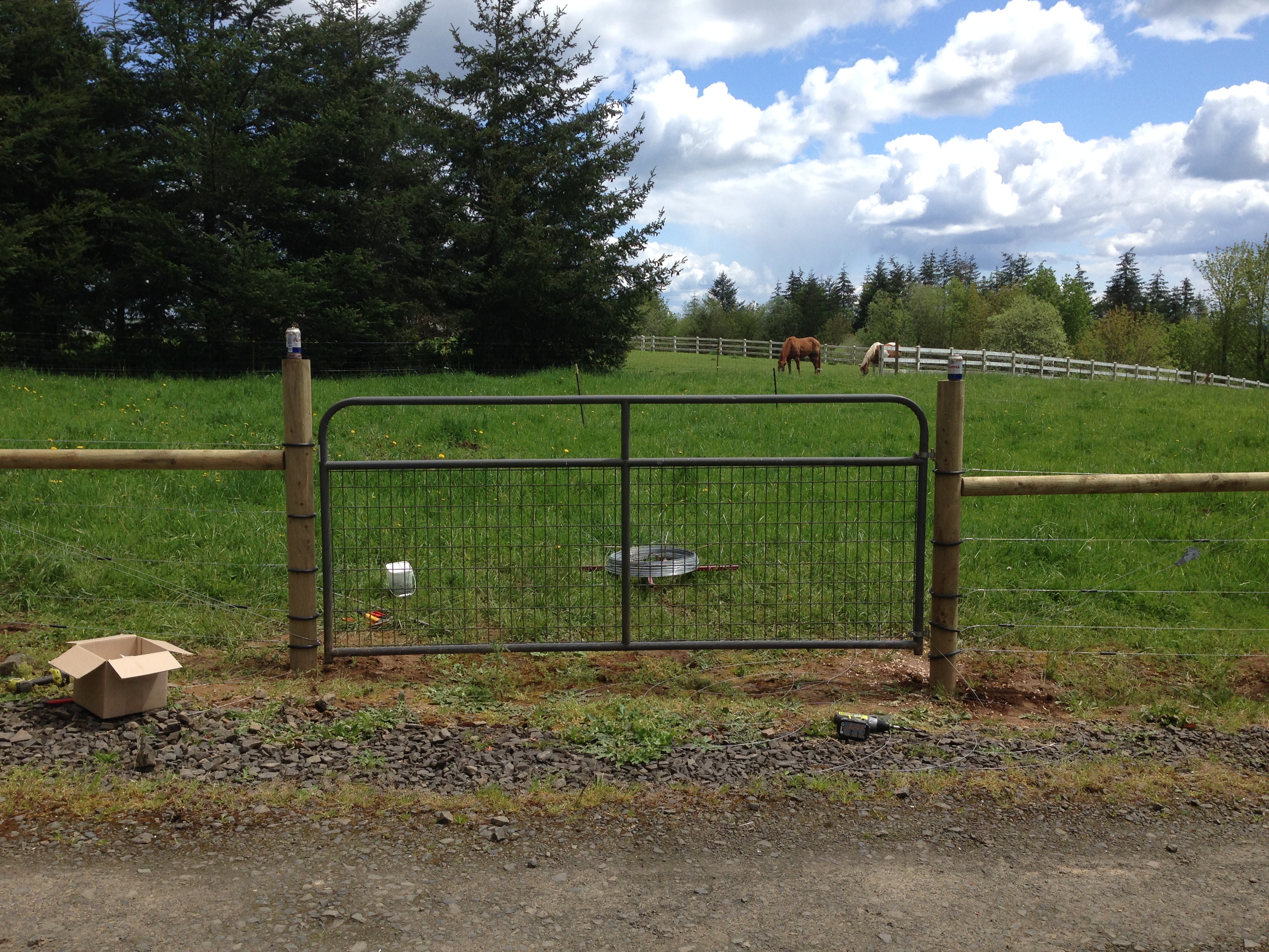

on one side of my property my neighbor has 3 rail vinyl fence. I just ran a hot wire on the very bottom, about 4-5" off the ground and then a hot wire between each rail. If there is any way you could "train" them to the electric fence that would work better. Our "training" area is a 60x60' area with field fence that has 3 strands of electric fence on the inside. when I put the goats in the main field I will test them by putting the feed buckets half under the bottom run of hot line. If they hesitate to jump into the grain you should be good to go.gate.JPG
when picking out an electric fence charger you want to get the most joules you can. I have 15 acres fenced with 5 strands of hot wire and I'm using a 13.0 Joule energizers. I am pretty consistently getting 10k volts all the time.
