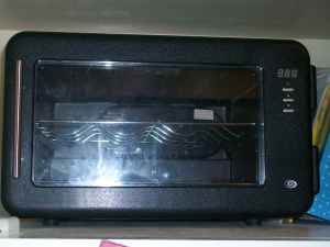

I'm building one out of an 8 bottle wine chiller. It's exactly deep enough for a 14" stick. Instead of a bulb, I'm installing one of those "Golden Rod" dehumidifiers that are sold for gun safes. It's not an oven as such, more like humidity controlled storage. --Ian
attachment.php
