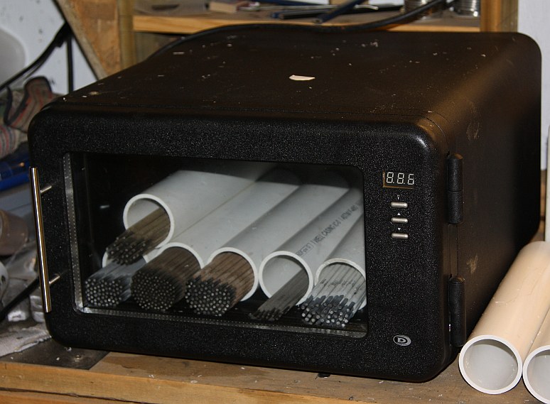

Here's how mine turned out. There isn't 1/8" between the end of the stick and the glass. It would really have been better if it were an inch deeper and tall/narrow instead of short/wide. I'm sitting here toying with the idea of installing hinges on the long side and standing it up. --Ian

I'm building one out of an 8 bottle wine chiller. It's exactly deep enough for a 14" stick. Instead of a bulb, I'm installing one of those "Golden Rod" dehumidifiers that are sold for gun safes. It's not an oven as such, more like humidity controlled storage. --Ian
attachment.php
You mentioned the golden rod dehumidifier for the gun safe, is that the same thing they use in a piano to keep the moisture in control if your piano is in a draft or maybe exposed to moisture? Our piano didn't need a heat rod but the music store told us about them just in case. Don't seem like they were very expensive. I have got a five gallon drinking water cooler [igloo, type used on the job], that has a leak and I saved it for the purpose of making a rod box heater if it is long enough. Those new 26 volt screw in type bulbs that are intended to replace the 100 watt bulbs seems to get pretty warm when they are turned on for a while seems like that would work.
Does the rod taste any better after its been micro waved?? :laughing::thumbsup:
Bet its still hard to chew. :D
   / Going to build a Rod Box Suggestions #17
I'm probably going to scrap that box. It's too bulky and takes up too much valuable bench space. The only thing in there that requires some kind of humidity control is that half pound of 7018 anyway. When that's gone, I'll just stick to 6011 and 7014.
