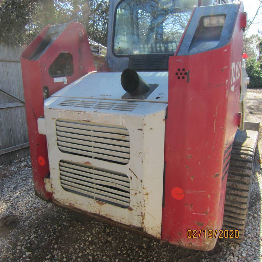

Hey guys. I am looking to add to my collection of toys, I mean needed equipment. I need a machine that can lift heavy logs, do some digging and general cleanup around the property. It will spend its life on turf. I have a JD 4300 with an FEL and a Bobcat mini 331.
I am looking at a Takeuchi TL150 with 3400 hrs on it. It is a 97hp tracked machine weighing about 11k. My research reveals they are solid machines and very robust. I know the usual stuff to look for like hydro leaks, welds in the loader arms, and general maintenance issues. But you guys with skid steers, can you point me in the direction of some of the more nuanced things to look for that could be a problem.

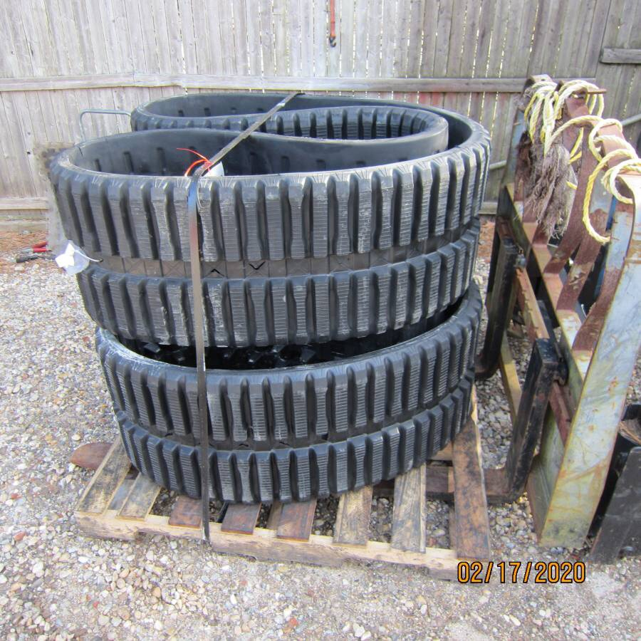

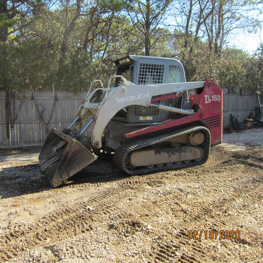

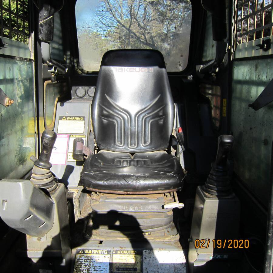

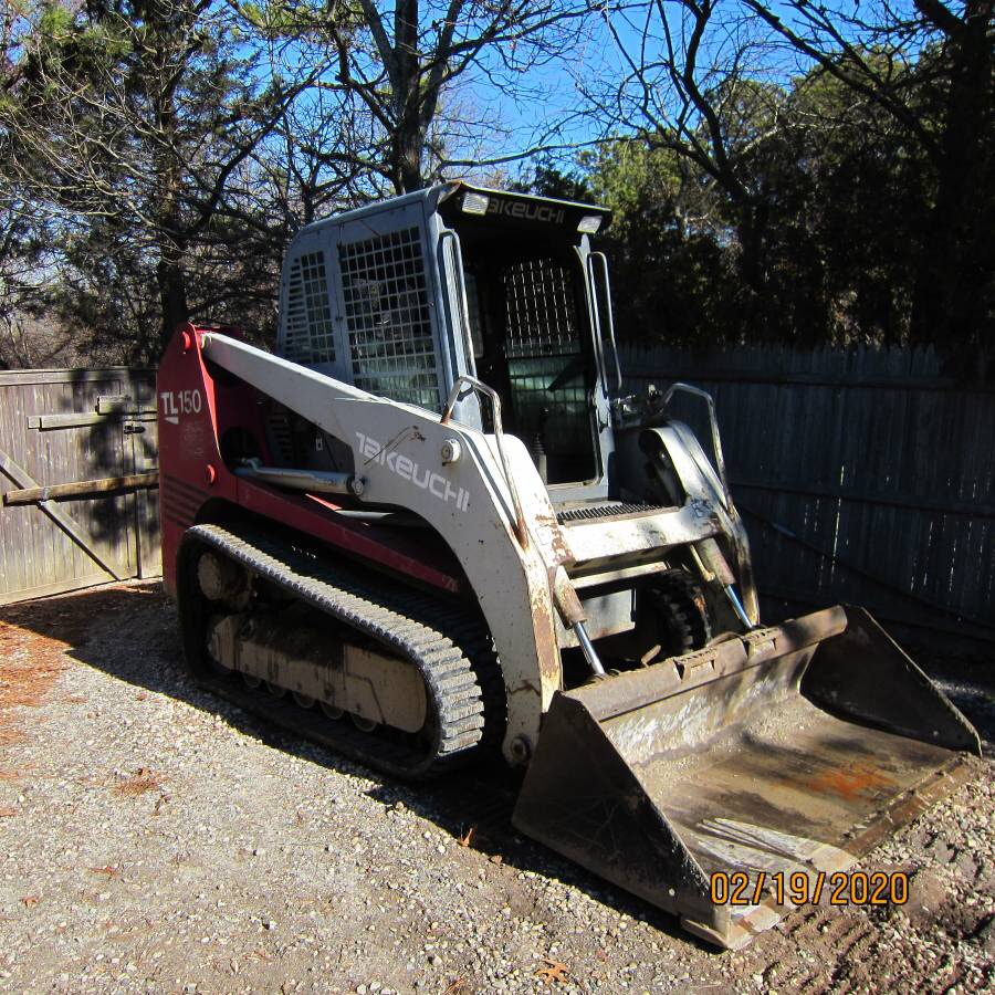

Some phots

It has an enclosed cab with ac and heat.
