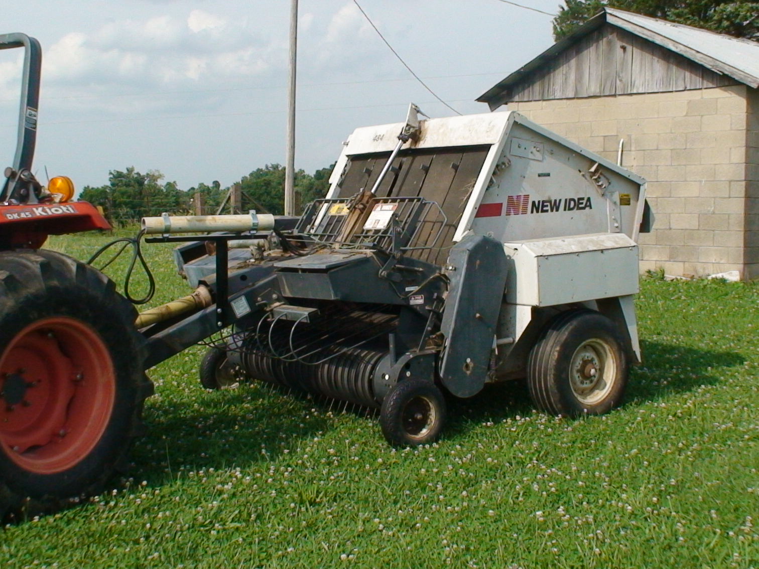

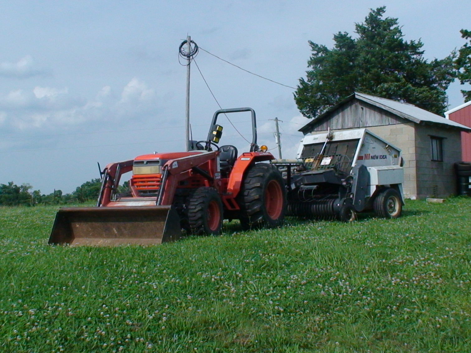

I don't know if this is a duplicate post, because I'm trying to upload some pics of the tractor and baler. Anyway, I set the baler up to be attached to my tractor (DK 45) and set out to try to roll some hay last night. Here's a couple of pics of the equipment.

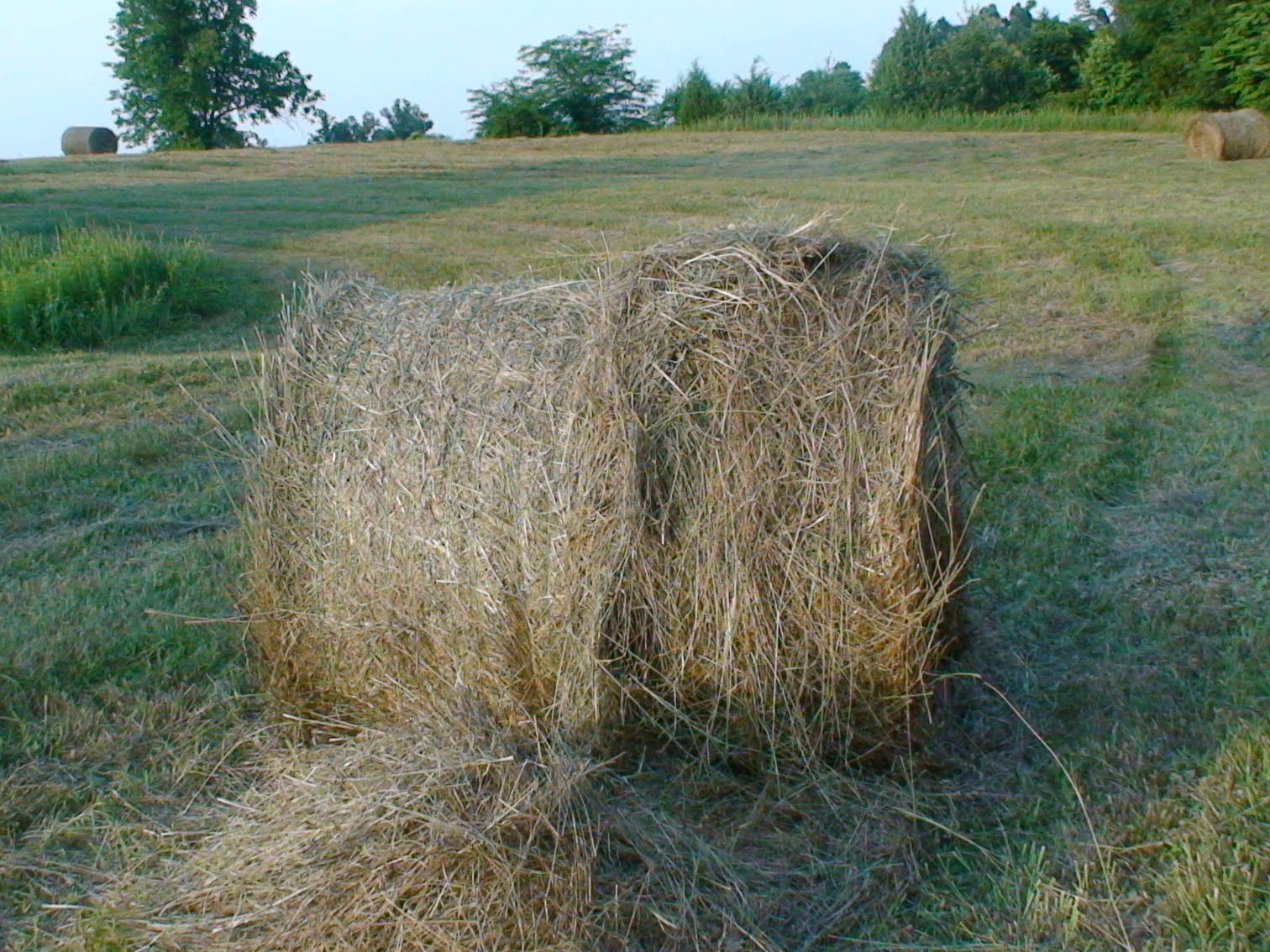

I got back to the field and started rolling. Here's what I learned on each bale:
Roll 1: Always make sure your gate is securely shut. I got most of the bale rolled when I noticed that I was losing hay out of the back. Turns out the latch was not closed all the way. Not sure if I could tie what I had in the chamber, I just decided to dump it out and try again.
Roll 2: With the gate securely shut, I started rolling again. This time, I got the roll done, the buzzer went off, and I tried to tie it. I moved the tieing arms into position and started tieing, and the left hand side string broke almost immediately. I finished tieing the right side and ejected the bale. Now in the future, I'm curious if I can stop the tractor/baler, thread the string through, and start tieing again. I don't know if it is problem to start the baler with full load in the chamber or not.
I didn't take a pic or roll 1, but it looks like the left half of roll 2 all the way across.

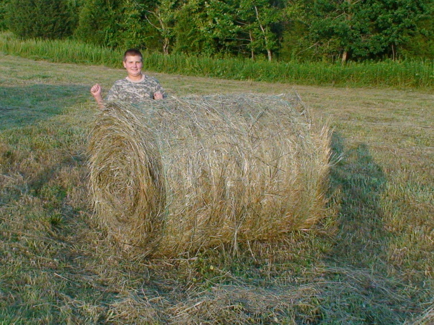

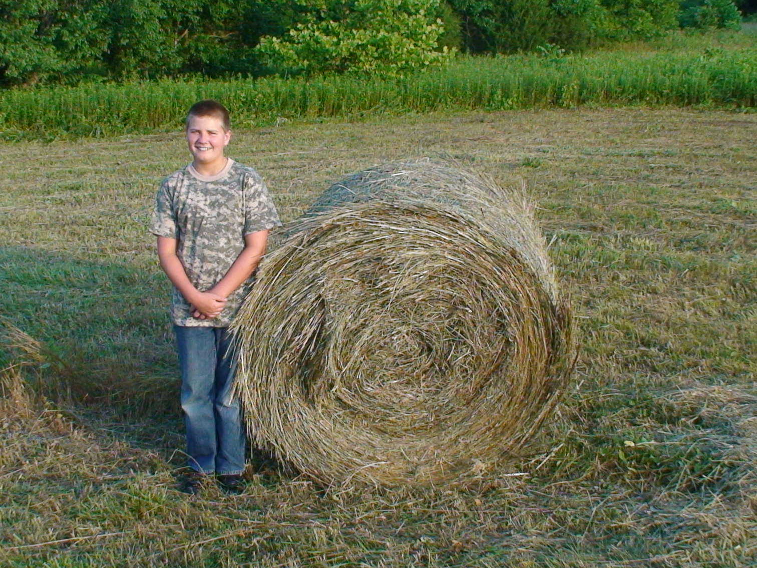

Roll 3: Finally got it all right - gate shut, baler full, tied correctly. Here's a couple of pics of the bale with my helper beside if for scale.

I'll have to say that overall, I'm very pleased with my acquisition. I was curious if my tractor had enough power to run the baler, but that didn't seem to be an issue. Even going uphill with a full bale, the tractor never bogged down or felt unstable. The bales are the size that I was hoping for, because the large rolls that we had the other guy do for us are quite a load for my tractor (once again, I'm not looking forward to handling them in the mud this winter). I ran a new circuit on my tractor to power the monitor box and made all of the wiring quick disconnect, as well as the monitor for the baler. I had to mount the monitor on the left hand side because I already have a radio mounted on the right side (and a tool box on the ROPS that hold my Sirius radio receiver). I also fabricated a stand on the tongue of the baler to hold up the electric line and hydraulic lines to keep them out of the PTO shaft (previous owner just used ropes and bungee cords attached to his tractor to hold them up out of the way).

Good looking roll of hay and a fine looking helper. We sell several of those rollers and They are good solid machines. Ken Sweet
