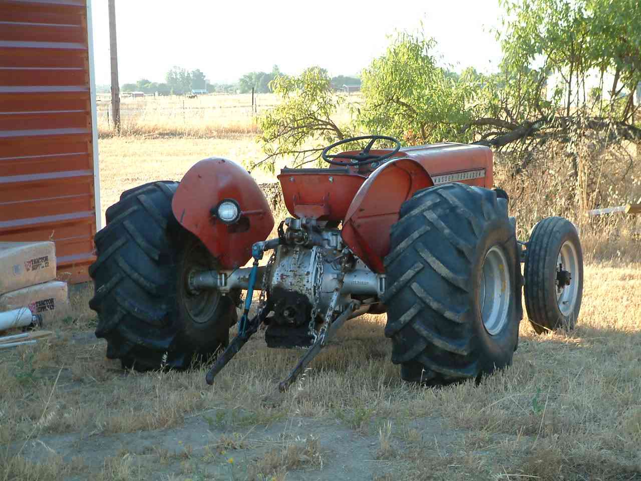

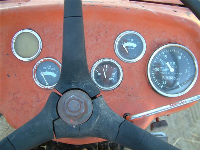

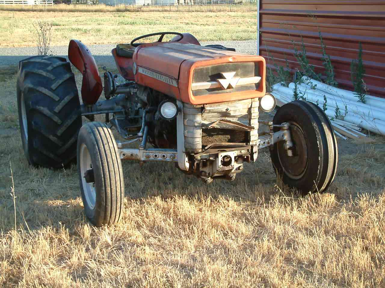

I replaced all of the gauges on the 1964 MF-135 diesel that I bought in July 06, except for the fuel gauge/sender that was OK. My 135 is the Deluxe model that has the complete set of gauges (temp, oil pressure, ammeter, fuel, tach/tractormeter). The more basic "Special" model has only a temp gauge and oil pressure gauge. I assume the 135 your considering is a Deluxe model.
Which brings up another question: does that 135 have MultiPower? The standard 135 transmission has 6 forward and 2 reverse gears. Add Multipower and this changes to 12F/4R.
The temp gauge, oil pressure gauge and the tach are essential, IMHO, for engine protection (overtemp, low oil pressure). The ammeter is not that essential, but is nice to have. I spent less that $100 on new gauges. They're easy to install.
BTW: my 135 has an oil pressure switch that's wired into the fuel gauge/sender unit that prevents the battery from discharging through that circuit when the engine is off. I replaced that also (around $30, IIRC). That oil switch was located under the dashboard and was attached to a tee right at the rear of the oil pressure gauge. I moved that switch to the engine block since it was easier to install there using the 1/8" copper tubing and compression fittings that you find on modern pressure gauges. Again this change was trivial and easy to accomplish.
Since I was thoroughly cleaning up the tractor, I rewired it. Really simple to do. I have the circuit schematic if you need one.
The grill on my 135 was crumpled when I bought it. I bought a replacement on eBay for about $50.
Here are a few photos of my 135 as delivered. It's an orchard tractor (short front wheel spindles and squat, wide rear tires). It runs OK, but as you can see, it was in need of quite a bit of work to make it look pretty.
