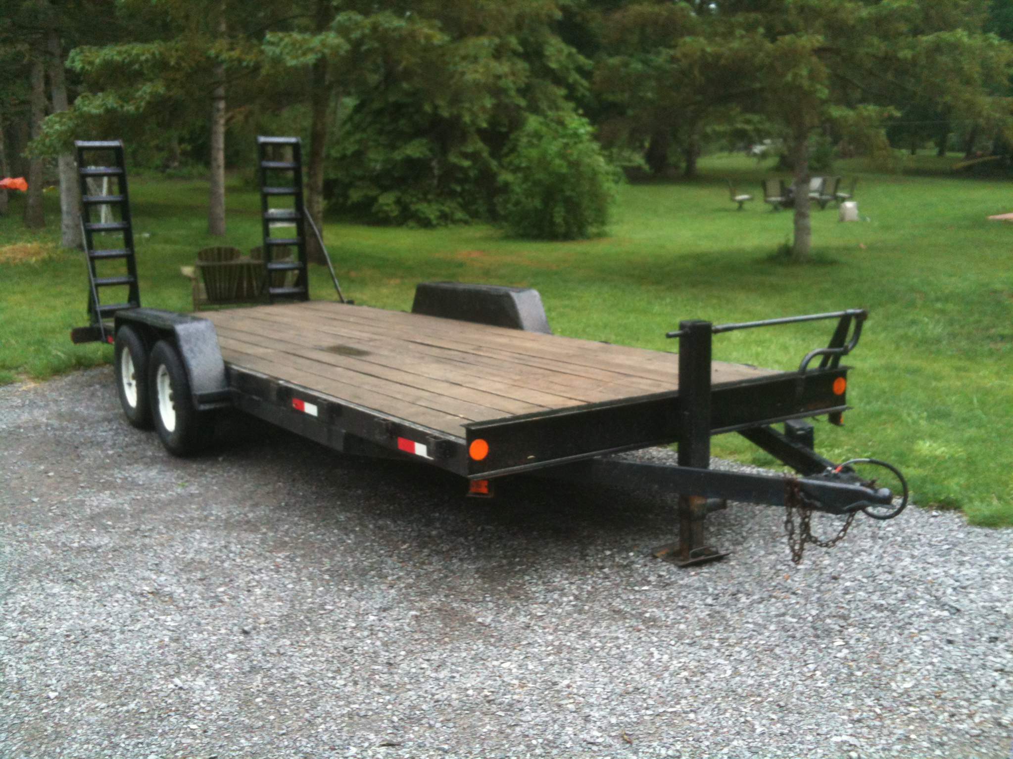

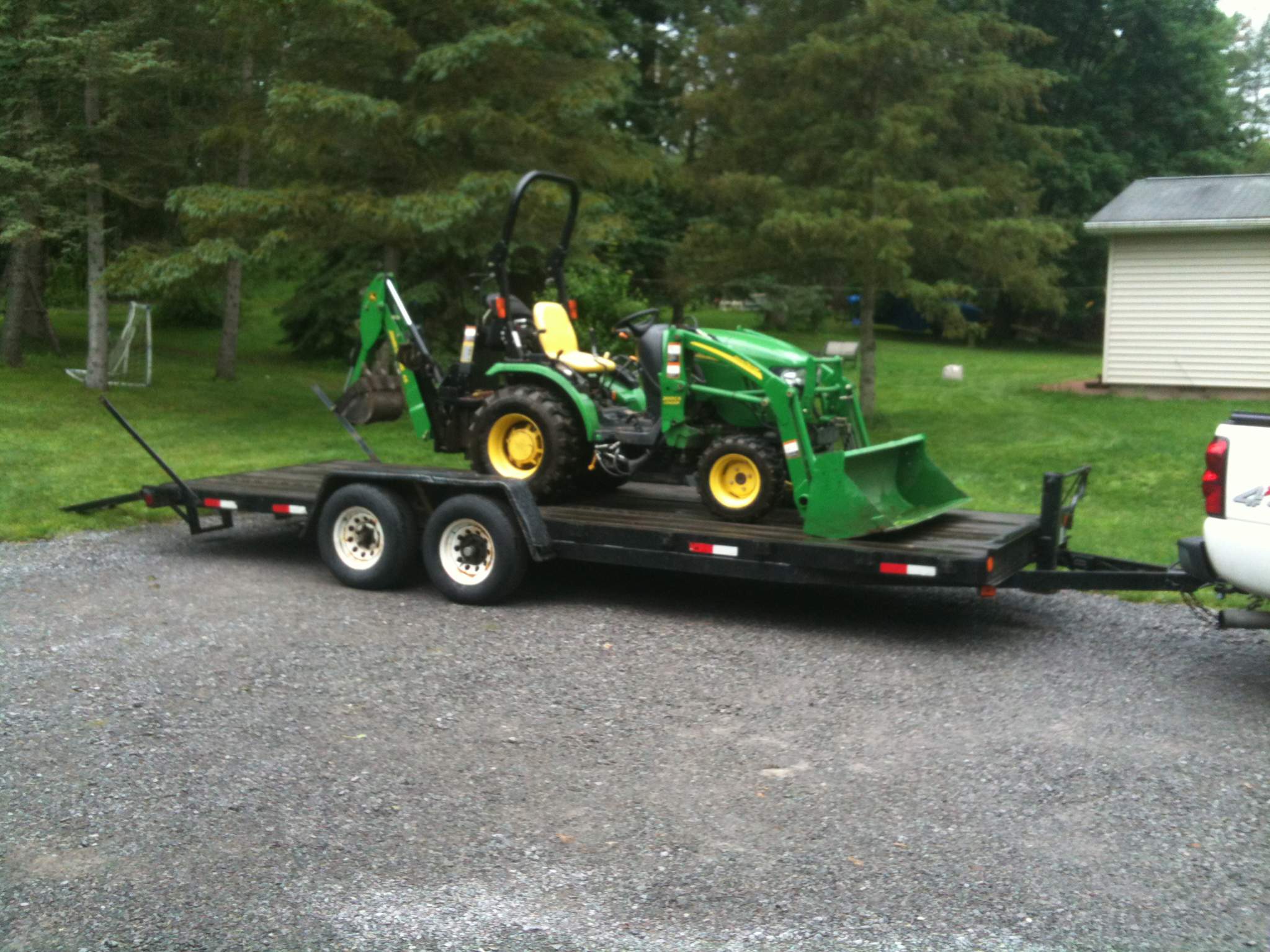

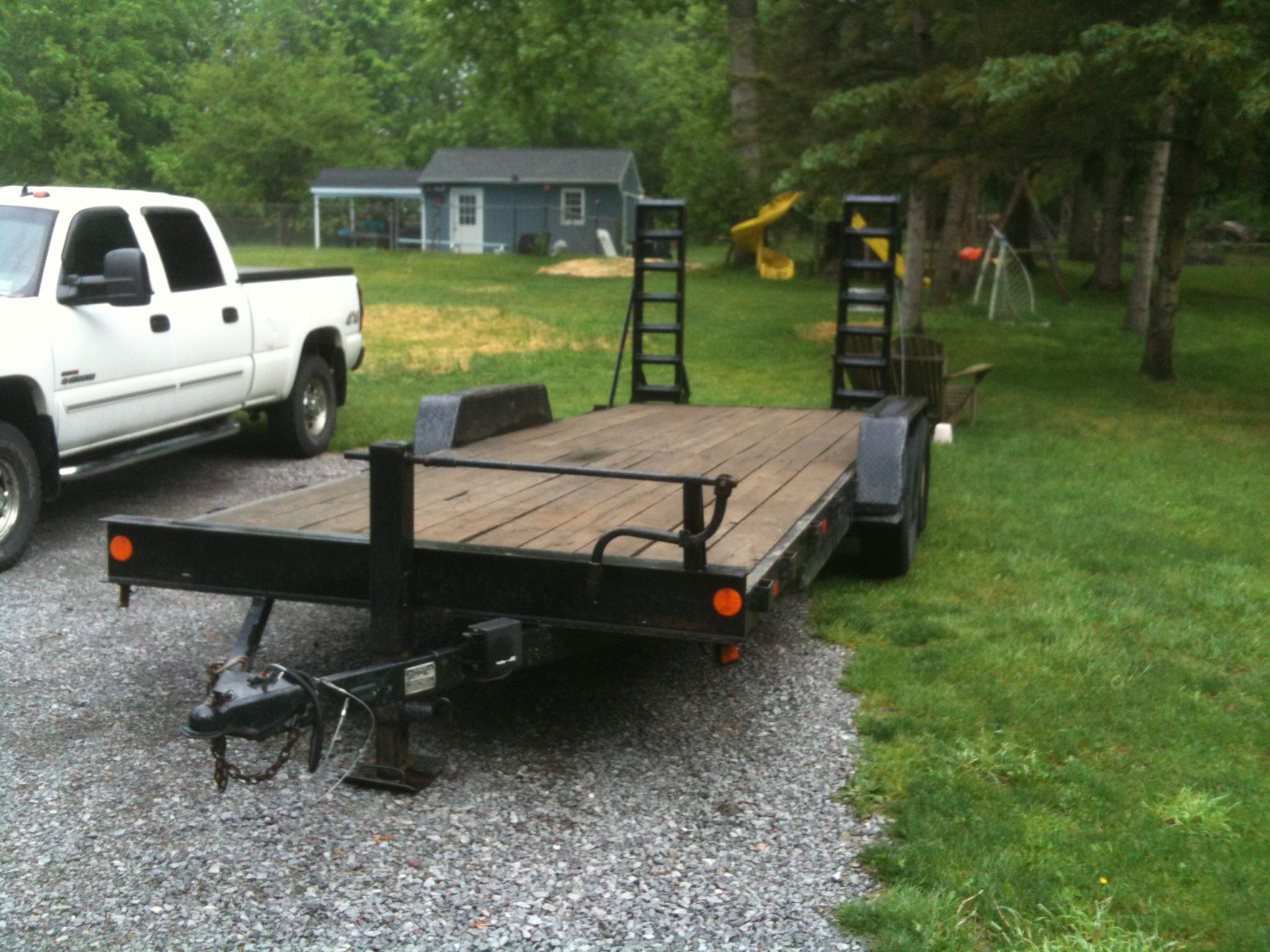

Everyone likes pictures right. Plenty of room up front for my Grapple, etc, or any rear implement I may get. Would be nice to have pallet fork mount.. And
