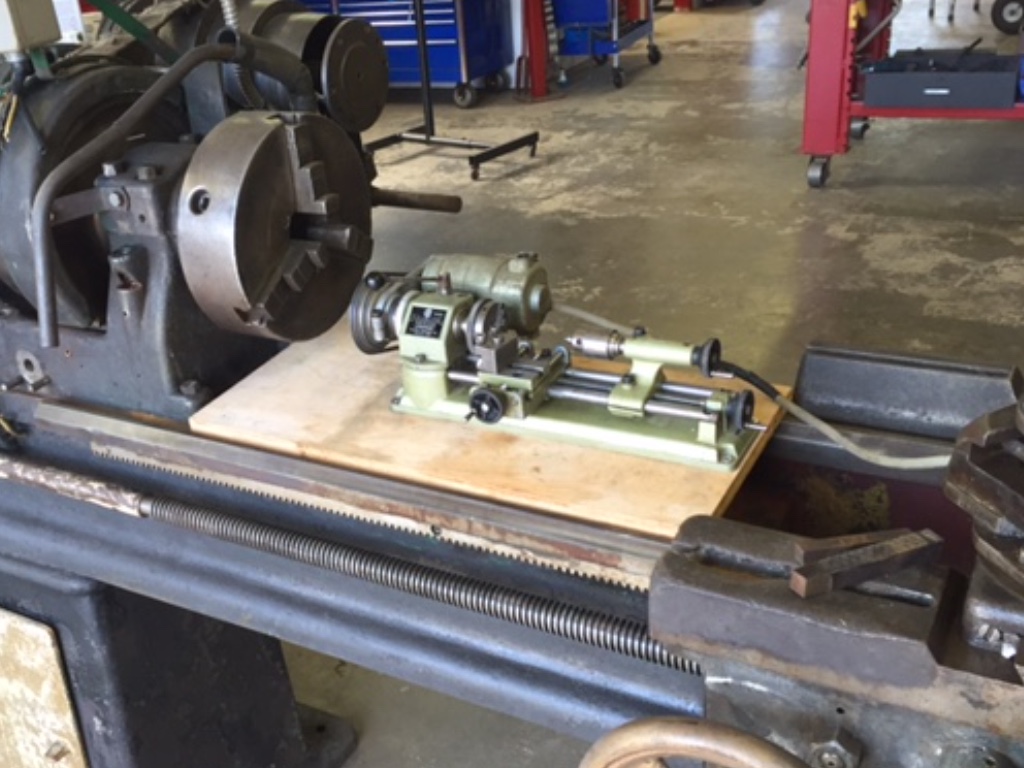

Won't matter at that point, Mark. (Here's the mini lathe my daughter planned to ship me off to the retirement home with.)
