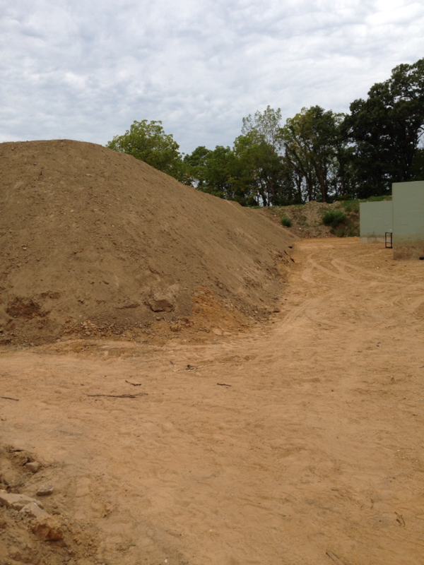

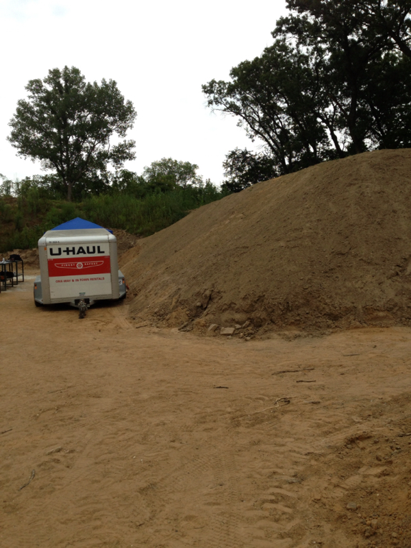

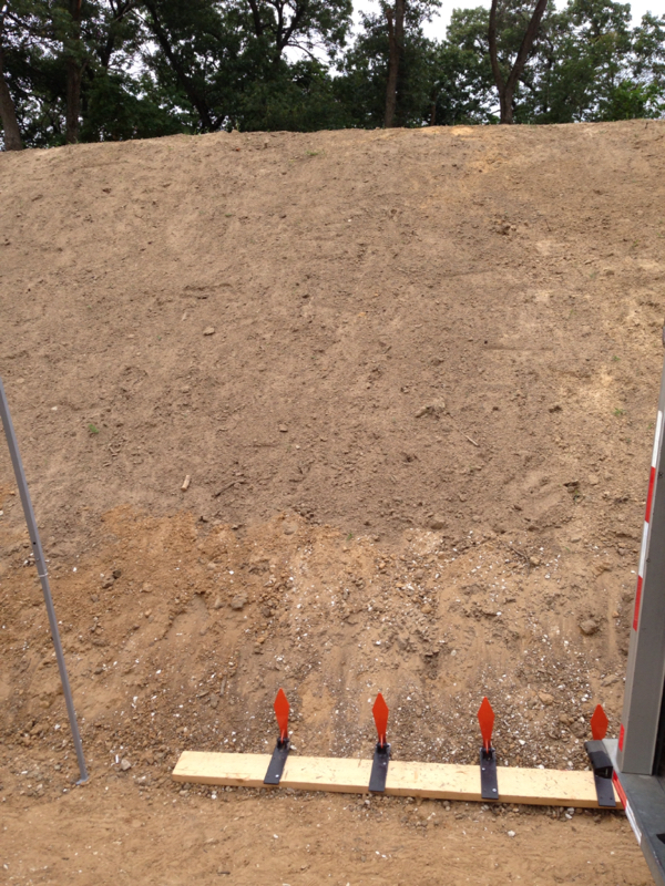

I really don't think the hill is 45 degrees. If it really is I wouldn't dare run my tractor down it. That is about the best way I can think of to get the tractor shiny side down. This pistol berm is supposed to only be 37 degrees. The berm in the last picture is a little steeper. They had a good range dog too. image-3810153832.jpg image-3162365489.jpg image-2688942976.jpg image-3990901898.jpg
   / Going up and down a hill not riding sideways mowing. Just straight up and down #29
If that's 37 deg. in the first pic, I'd be looking for Plan B. Cutting down from the top and pushing the spoils ahead to fill in the at the bottom of the slope should work to make a longer but less steep grade. I'd guess it would end up with a 5-6 foot deep trench at the lip on top of the slope if the height is 20'.
