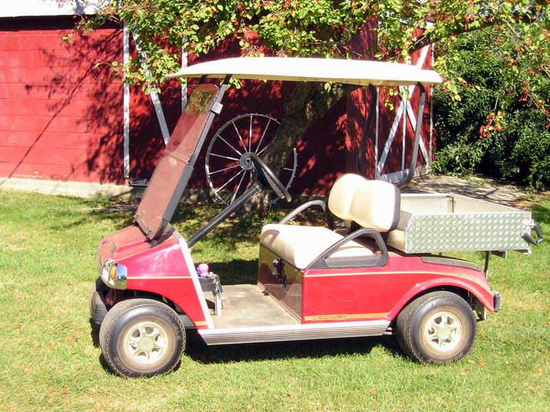

BTW, like Ron did, pics are always helpful. Thanks again.
Okay, here's my picture::D

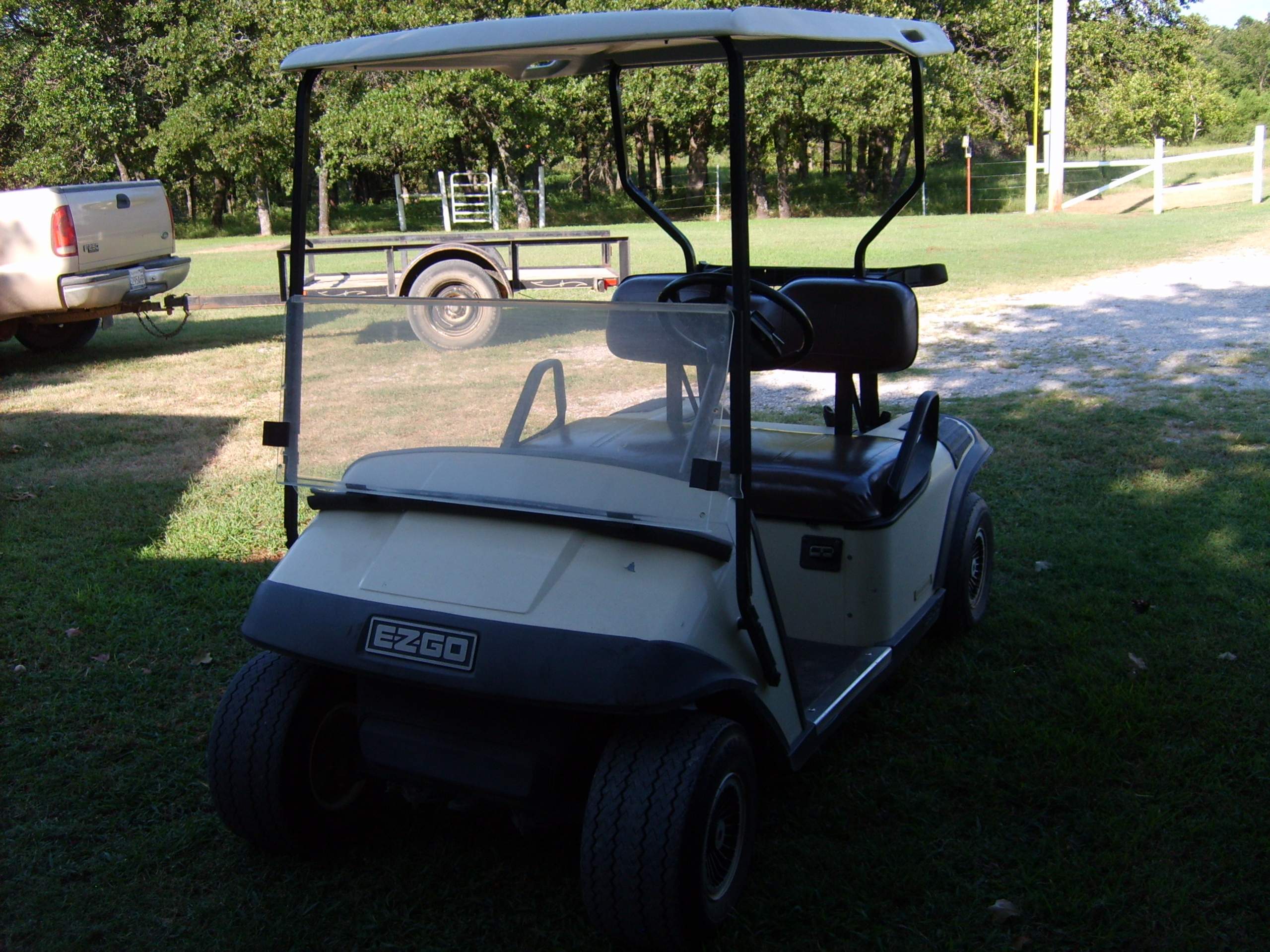

We have an old (late 80's) EZ-Go gas cart that we got about 20 years ago after it was retired from ground maintenence duties at the golf course. In all the time we've owned it, all I've ever done is put gas/oil mix in the tank and air up the tires. it has wide, smooth turf friendly tires and the only traction problem I ever have is in mud. With a big steep hill separating the house/shop portion of our property from the woods/garden/chickens/fruit farm, the cart is a godsend. We recently (2 years ago) bought a Gator HPX for heavier work duties-my wife wanted a hydraulic dump- but I prefer the golf cart if I'm looking to just transport myself and a few small tools, or using the electric spray rig.
