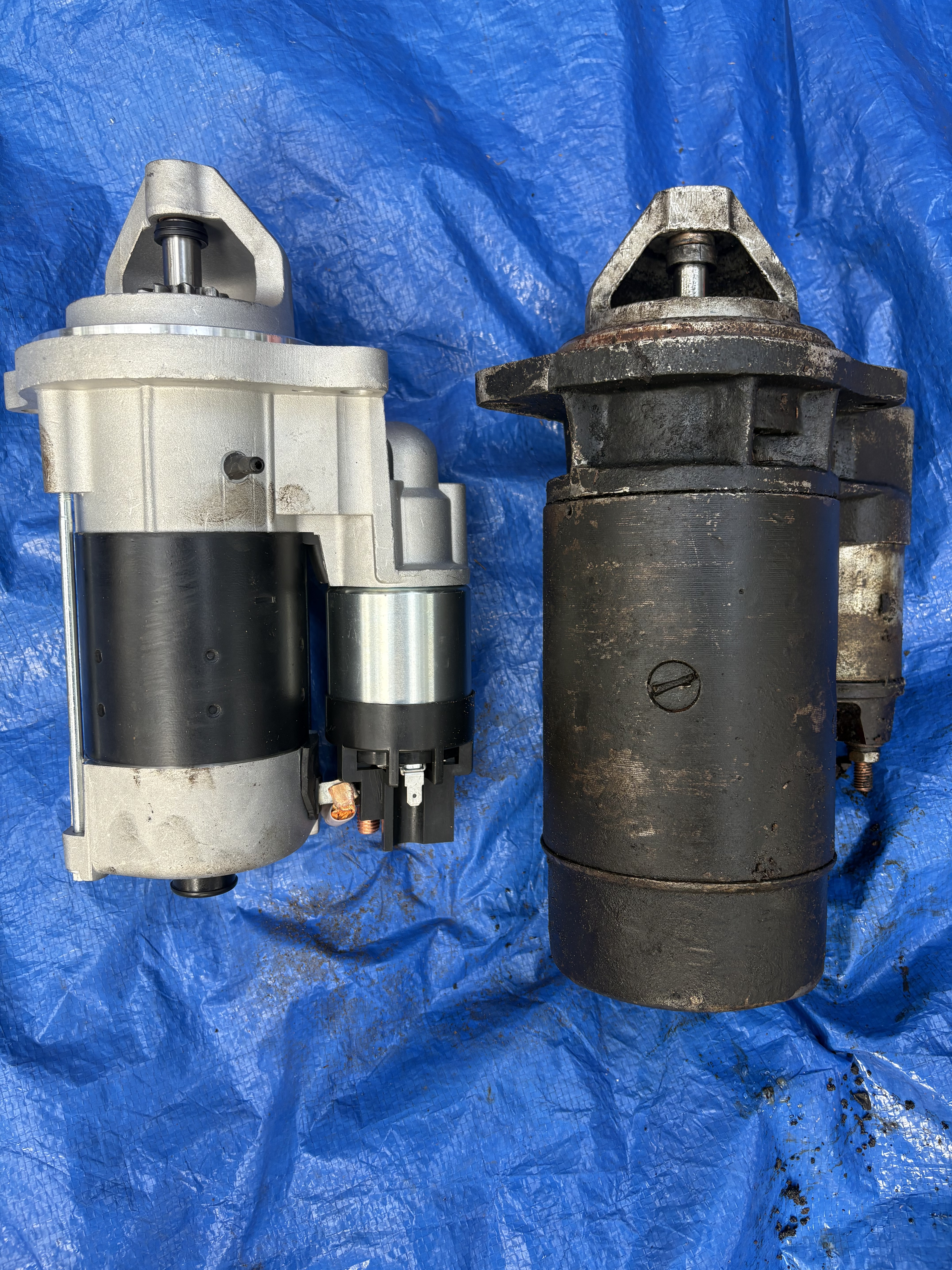

Was able to get the starter off and bench (ground) test it:
Bench test
Any thoughts on the state of the starter?
   / Good battery, crank but no start. #29
Does not look like it ever turns. The solenoid kicks the gear out into flywheel but nothing you did turned the starter motor. Not gonna start without some motion but you may not have applied enough power with that connection.
Plug the hot to the solenoid then use a smaller jumper to energize the solenoid to see if the contacts make a solid connection and actually turn the motor. If the motor does not turn time to see why (corrosion, bearing or ?) or replace.
   / Good battery, crank but no start. #30
In video when positive battery jump cable was attached to large post that's connected to field coils on starter frame if appears that field coils, armature &/or brushes are faulty due to no rotation of armature.
When bench testing a starter one needs to attach ground cable to starter frame as shown in video then attach positive cable to large post on solenoid that larger tractor battery cable was attached to. Then using a screwdriver short across large post & smaller post on solenoid normally marked with an "S". In lieu of screwdriver one can use a "remote start switch" if available.

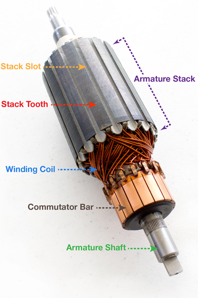

That's a nice-looking heavy-duty starter like the one for my IH3444. It stopped working, so I disassembled it. Cleaned it all up, refinished the brush contact surfaces (commutator) with sandpaper by chucking the armature shaft into a 1/2" drill chuck. Drill was clamped into a bench vice. Refinished the commutator surface bar by smoothing out the slightly rutted, worn copper surface with sandpaper placed over a flat file and spinning the drill motor slowly. Cleaned all bearing surfaces and regreased with Pennzoil Marine water repellant grease. Flipped over the solenoid contact points 180 degrees so new surfaces would make contact with fresh refinished surfaces. Installed new brushed that I matched up at the NAPA dealer in town. Had to do some slight modifications with a file to get them to fit back into their slots. Reassembled, and reinstalled in tractor. Works like new. Should be good for another 40 years.
