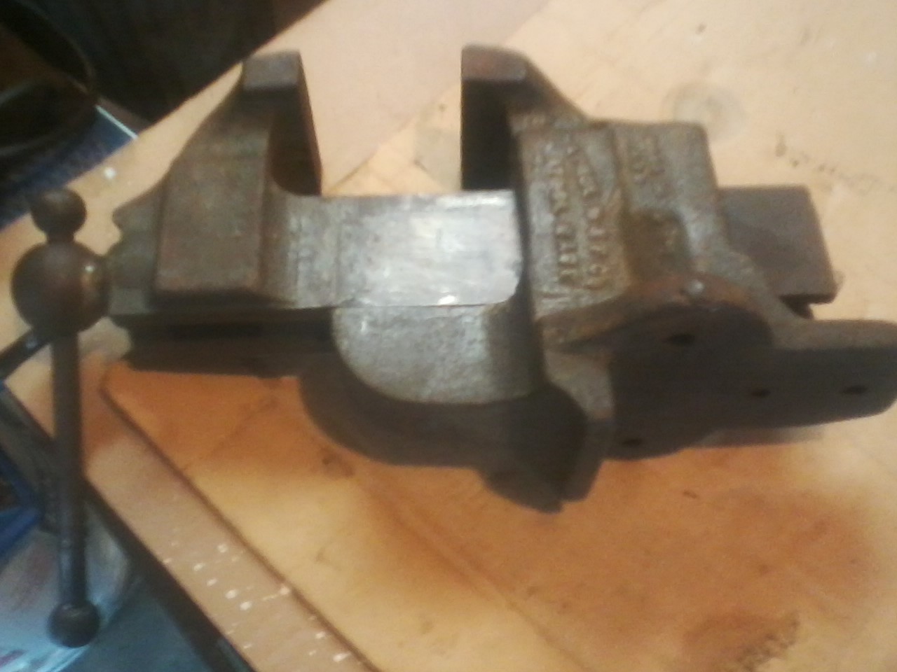

If you're looking on CL you need to know what you're looking for and take your time....lots of people with crazy prices on their vises, and more than a few with damage that is either ignored, or hidden. I just finished a restoration on this 105lb 5.5" jaw Athol and if I'm lucky I might get something like $175 for it. If it was a 5" Wilton bullet, it would be worth at least twice that, even though this Athol is more massive, and stronger in probably every way. The only downside to the Athol is the jaws aren't replaceable....but they're still there after 100 years.
Nice refinish. I still haven't re-painted my $40 flea mkt find of an 613 1/2 yet. Mine shows traces of an old green paint. I like the color you chose...what did you use?
