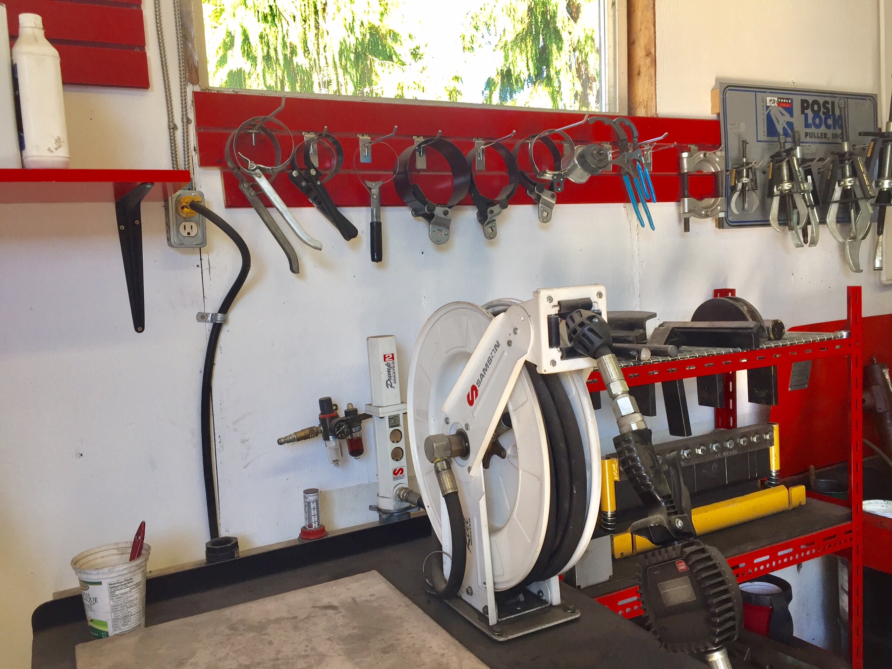

I think like everything else there is no "one size fits all".
I try to use a band type removal tool first whenever possible to minimize damage on the off chance I have to REuse the filter temporarily.
As a last resort I will use a Channellock (plier type) filter wrench

   / Good big oil filter wrench? #13
If all else fails pliers or pipe wrench.

   / Good big oil filter wrench? #15
If it's painted on, take a utility knife and score through that paint along the seam. It will take a lot of force to break that paint by twisting the filter.
Yeah, paint WILL glue a filter in place.
Do that, and you might find your plastic handled strap wrench is just fine for that job.

Have one and works fine...had to drill/ grind another hole 'longside others ( for pivot point) for larger grip around hydraulic filter on T450 ( and replaced nut with locknut as factory nut always came loose and fell off)
5 thumbs up for the pliers type. The ones from Harbor Freight are a "doesn't suck" - 2" to 4-1/4" Oil Filter Wrench
   / Good big oil filter wrench? #17
I use a chain wrench. Mine happens to be a harbor freight model, which they don't seem to carry any more. I guess it was too good of a tool. :) but there are plenty of others. It has a socket for a 1/2 inch breaker bar or any extension you want to use. One advantage is you don't have to have a lot of "swing" room if clearances are tight. Here is a picture of one in an autoparts store, Looks just like mine, but I didn't pay no where near that for it.

#18
Got a strap wrench from Napa. $6 for a loop of basically seatbelt on a 1/2" drive socket. Even with a 2' breaker bar it wouldn't budge.
Finally realized it had notches at the top of the filter. As it's a high pressure JUST filter it's WAY stouter than a normal filter. Hammer & chisle on one of the notches finally got it loose. Could barely get a bite it was so buried, but it was enough

I use a strap wrench for hard to get filters. A large set of oil filter pliers for easier to get to filters. For the worst offenders a socket aluminum cup type works best. It seems in my lifetime of tractors, lawn mowers, etc...each one utilized a different set of oil filter wrenches and devices for ease of use.
