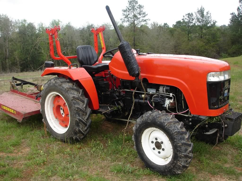

A little update. I have put seven HARD hours on her and have come to the conclusion that I love this little tractor. I have had zero problems (except breaking the muffler off, and the bush hog wheel fell off and I ran over it) But other than that she has been great. I have changed all my fluids, which took all night long. The fluids looked decent, the hydraulic had a good amount of trash on the stainer, and the front axle fluid looked to have a small amount of water in it. I flushed it with diesel. And I re-routed the exhaust under the tractor. I like it much better; keeps the exhaust out of my face and the diesel stench off of me and I don't have to worry about low limbs again. It is tucked up pretty well and doesn't hang any lower than the linkages. I also replaced the dry rotted shifter boots but that is about it. Here are a couple pics, notice the muffler seriously bent backwards (did that in the first hour) and a second pic of the rerouted muffler. In the second pic you can see where I changed the fluids by the evidence on the garage floor. My wife wasn't to thrilled with me getting oil everywhere.
Good job on the exhaust re-route. Just make sure you don't park in any tall dry vegetation with a hot exhaust.
   / Good deal on Jinma 304? #23
Based on what you paid for that rig you should probably be wearing a mask and a gun when you ride it:) I kinda liked the rakish exhaust angle (made it look go fast:D ) but the reroute looks good too. The tractor would look a whole lot better in the field with the ROPS up.
   / Good deal on Jinma 304? #24
I had my exhaust on my old Nuffield 345 run underneath like that and after an hour or so of brush hoggin it would start cooking my left foot. Yours will cook your right.
   / Good deal on Jinma 304? #25
I ran mine down under (exhaust), no problems in the past couple of years since I changed it, I think you will like it.

I love the exhaust like it is, and my foot doesn't get hot. And I will put the ROPS back up, I have just been doing alot of work on five acres that I bought that is covered in trees (casued muffler breakage) and I can't get in any where with the canopy on. But the real question is Brent: Roll Tide or War Eagle? I prefer the former.
